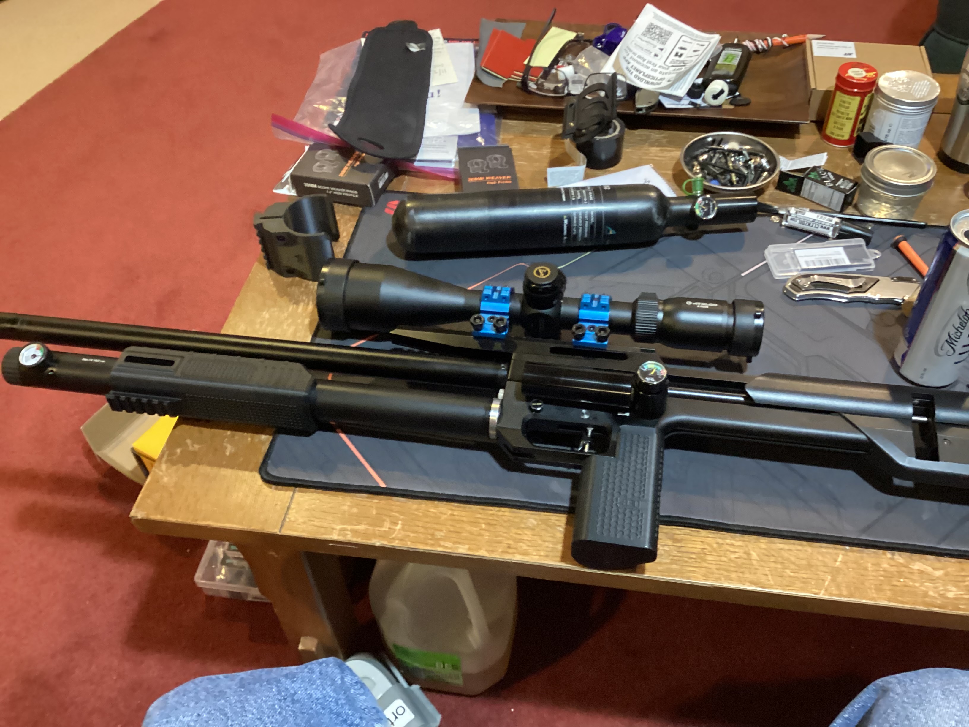

troubles started with this eBay plenum. Couldn’t get one of the three joints to seal. Then took bottle off. That hasn’t held full air since.
So tube back on and got the plenum to hold air. It’s actually the Huben leaking. Have had a dozen 7x1.5 and tried lots more. These are amzon
oring kits . It’ll be nice to play with the other guns.

The Amazon oring kits are often 50-70 durometer hardness. they will pop like crazy under high pressure. Sometimes you'll get lucky and one will hold. On amazon you can get Captain Oring "paintbal o ring kit" of 90duro has Nitrile/nbr, Urethane, And fluorine orings. I use these. They work EVERY TIME. I had a MURDER of a bad time with the plenum to valve connector seal on the Snowpeak P35x. the Amazon "75a durometer NBR oring kit" the 18/14/2s were blowing out like a hezbollah beeper. Pop in the CO'ring 90 and Voila. hasn't lost a single bar since.

The hubens check valve orings are crap often. I had 2 huben bottle regs on other guns, both times the check valve orings failed and a slow barely audible leak out of the foster fill nipple. Get quality rings for the check valve and it'll never happen again.
