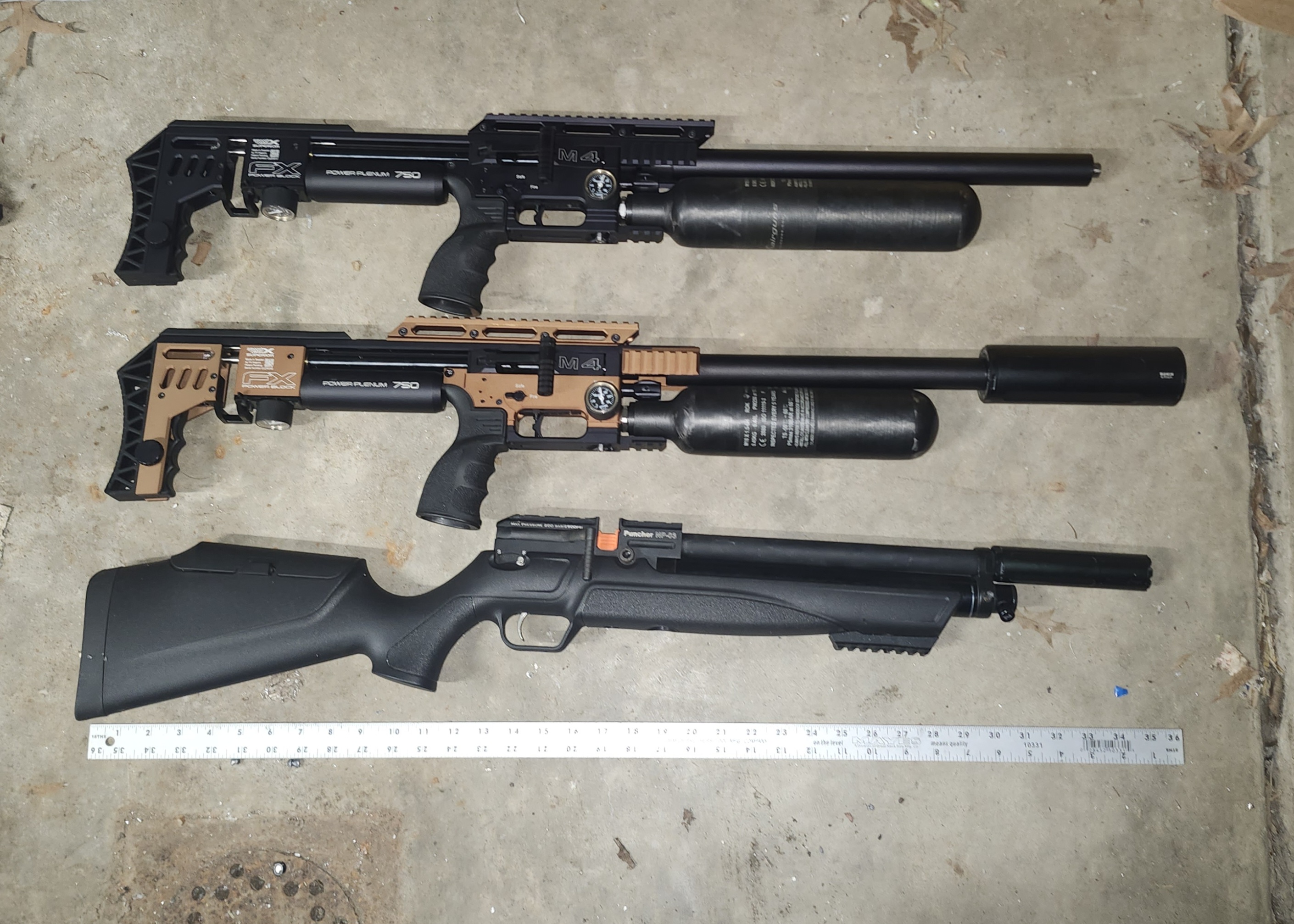

FX Lots of compact gun talk lately
Top is M4 700mm no Mod
Middle is M4 600mm with mod
Bottom is a pieced together Kral parts gun with mod.
We all know what the FX does but surprisingly that .25 cal 14" barrel 180cc 3000psi tube little Kral does 20 shots a fill at 38fpe with an ES of 22fps using 25.4JSB or 10 shots at just under 50fpe with the 25.4JSB and an ES of 15fps and no regulator.

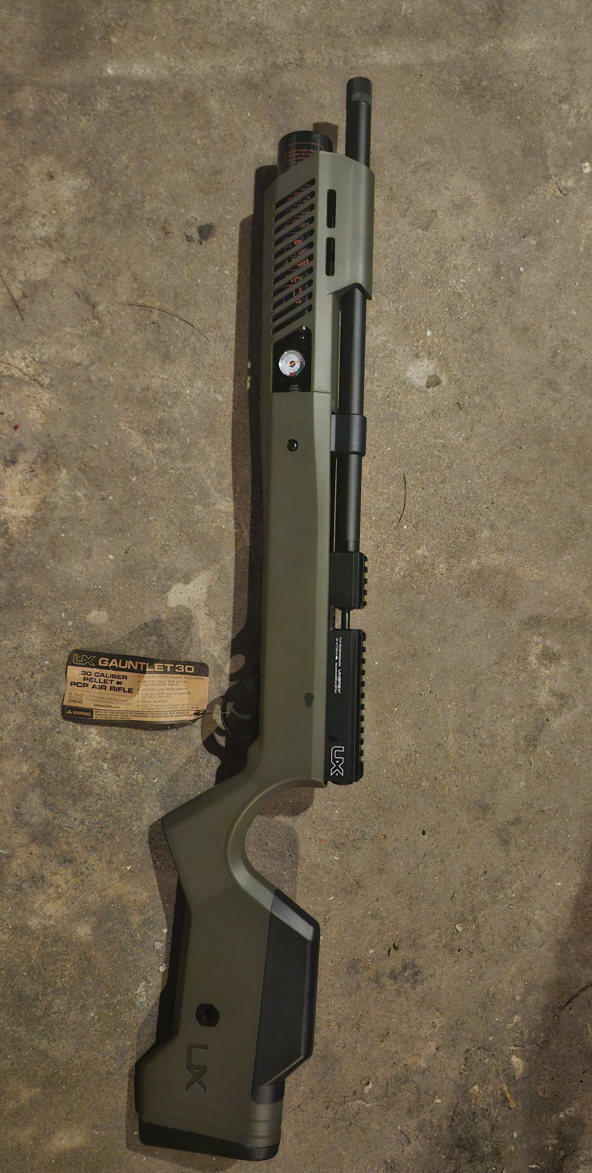

Another fun compact. 18" barrel in .30, 3000psi bottle and 1900psi reg. Still 10 shots at over 800fps. A little more tweaking and a small 4500psi bottle should get me 2-3 mags at almost full power in a small package.

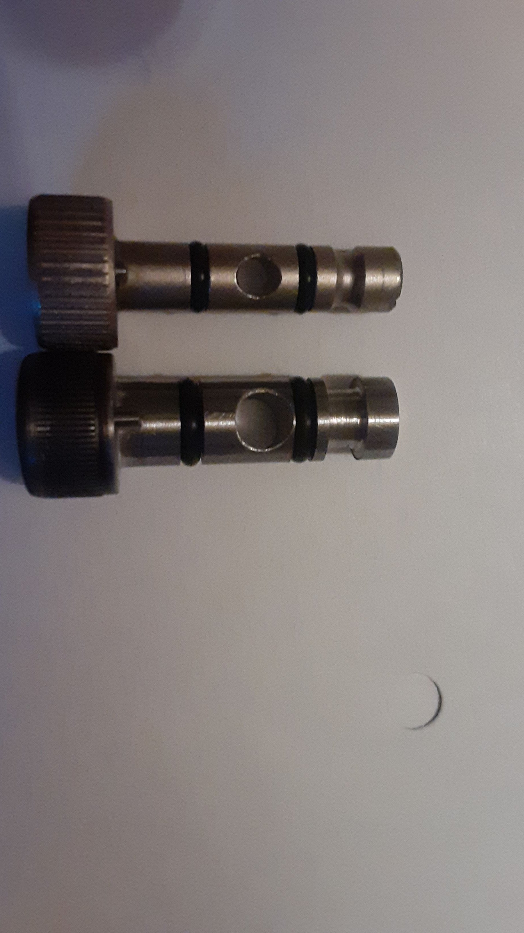

NP-03 with a mega trigger in a mega stock. Modified puncher breaker shroud with a modified suppressor adapter. Ported with custom valve internals. Modified hammer with heavier spring but zero preload to prevent hammer bounce. And the kral Biathalon cocking Lever. Custom larger diameter power adjuster to accommodate the larger ports.
I make the power adjuster from an 8mm bolt and it can still function. Small reamers in stages to enlarge the hole where the factory adjuster was.

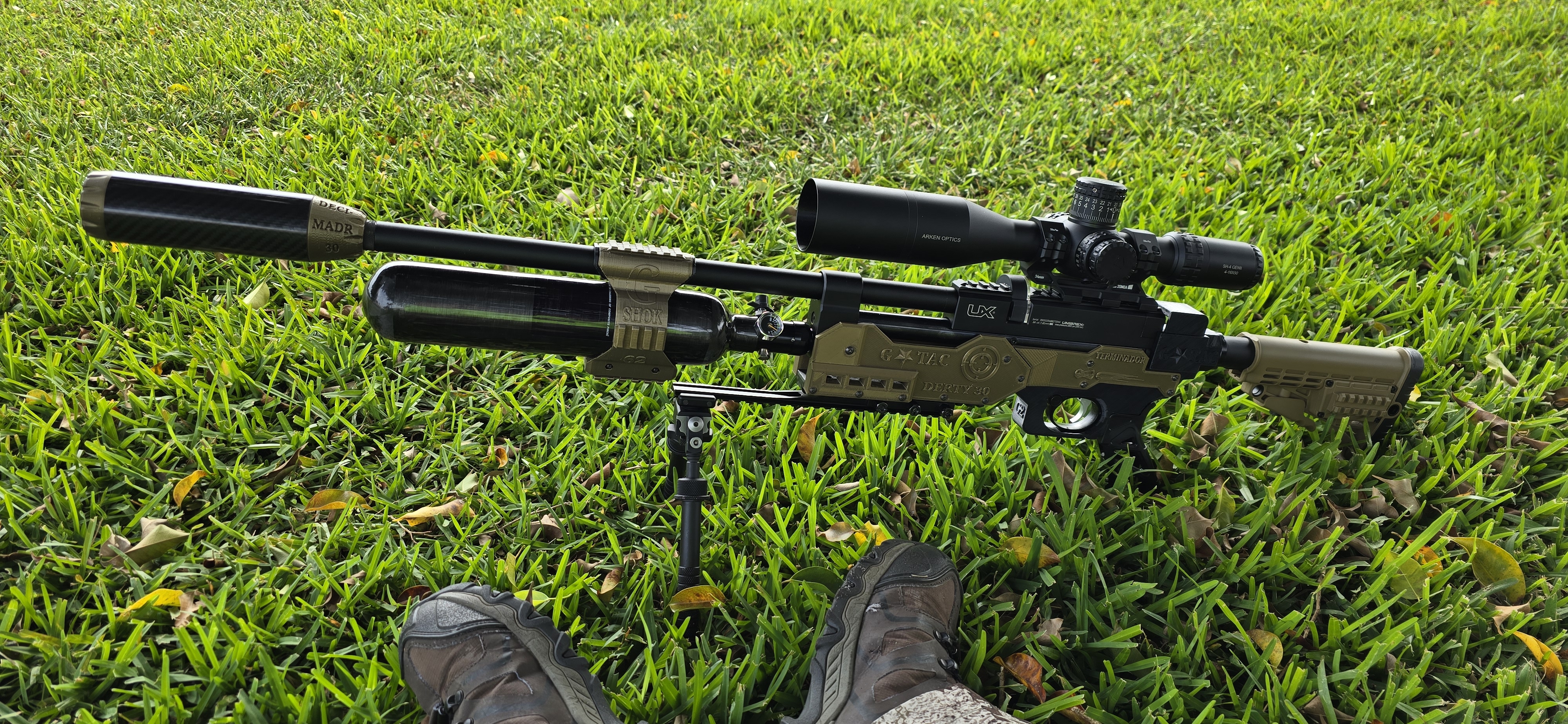

Nicee! Got a .30 "compact" myself! 20" barrel, 500cc 4500psi bottle, reg set to 3100psi, with hammer 3/4 of the way it outs out 92fpe with 50gr VK slugs 910fps and 99fpe with 78gr going 756fps. It's currently set to shoot 44.8gr at 910fps and gets 3 mags from 4500psi to 3800psi

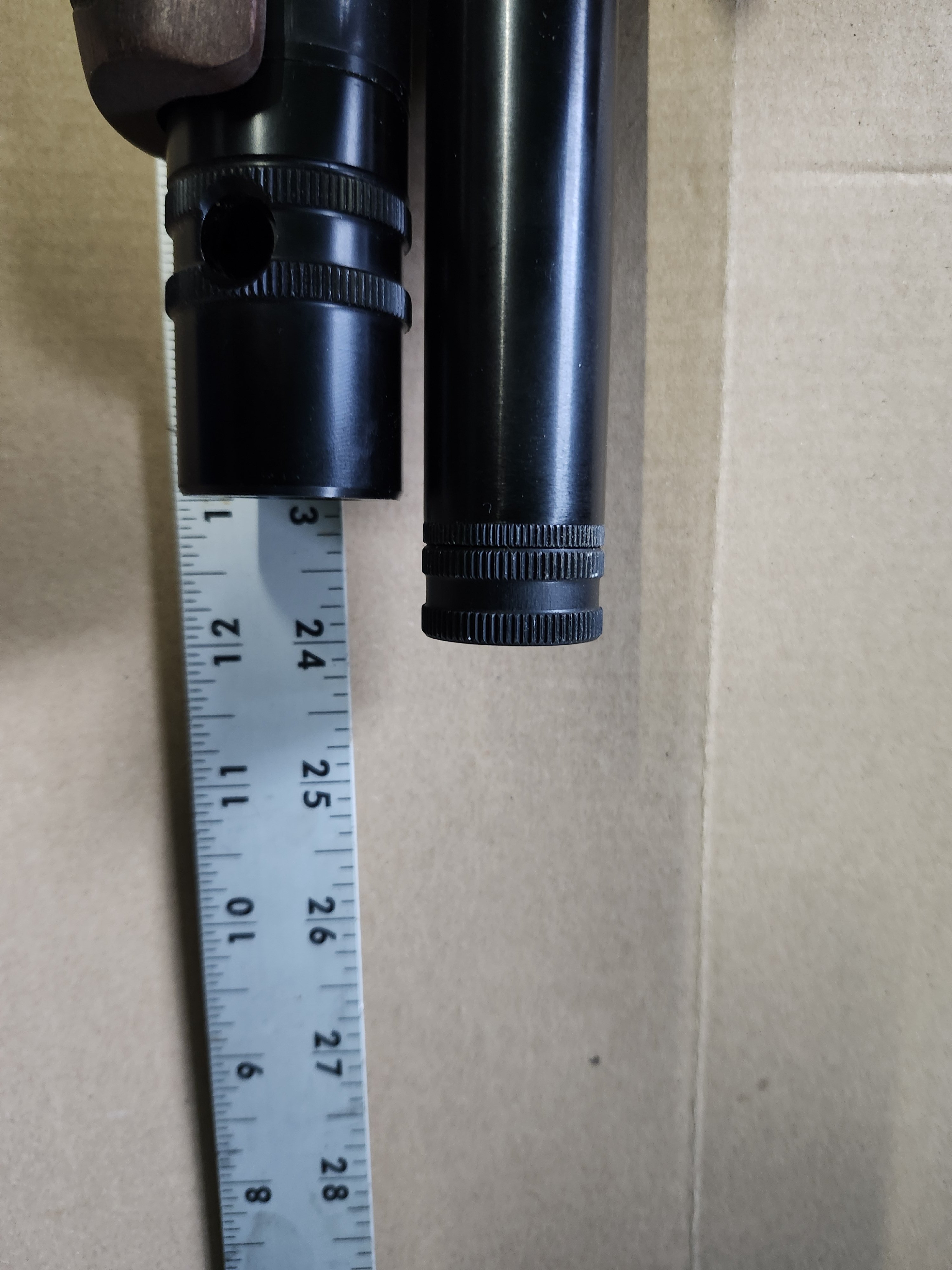

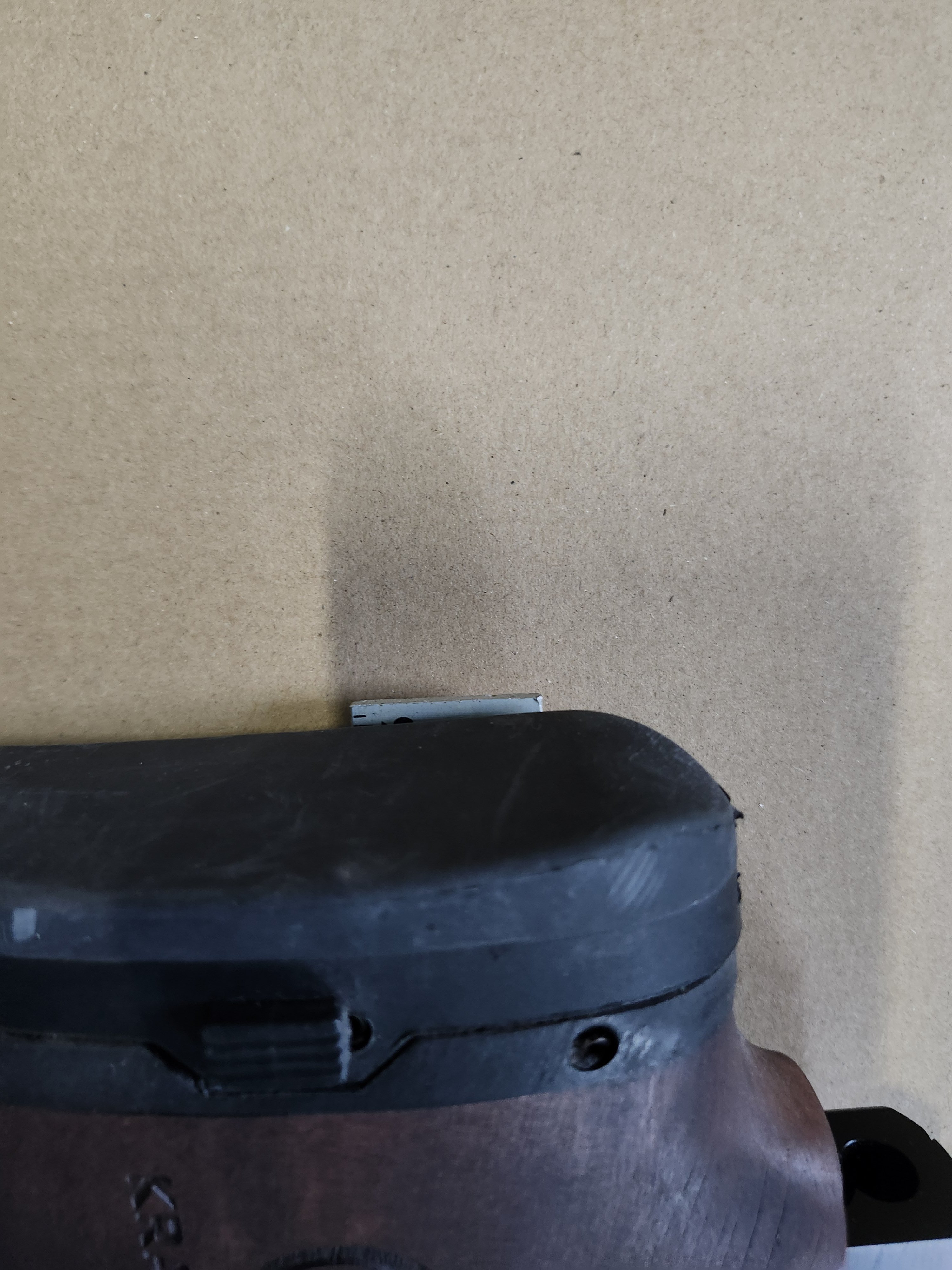

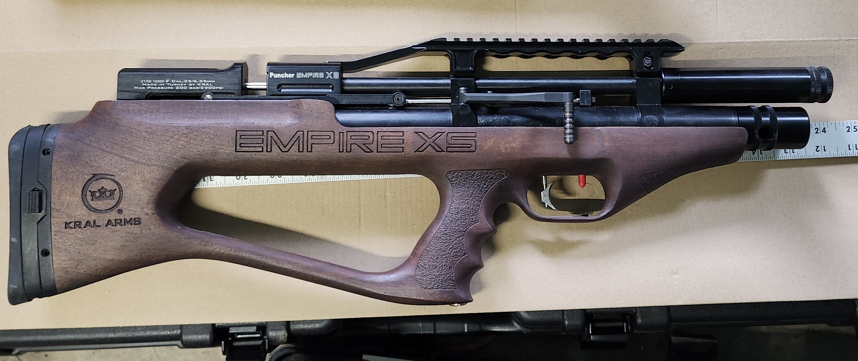

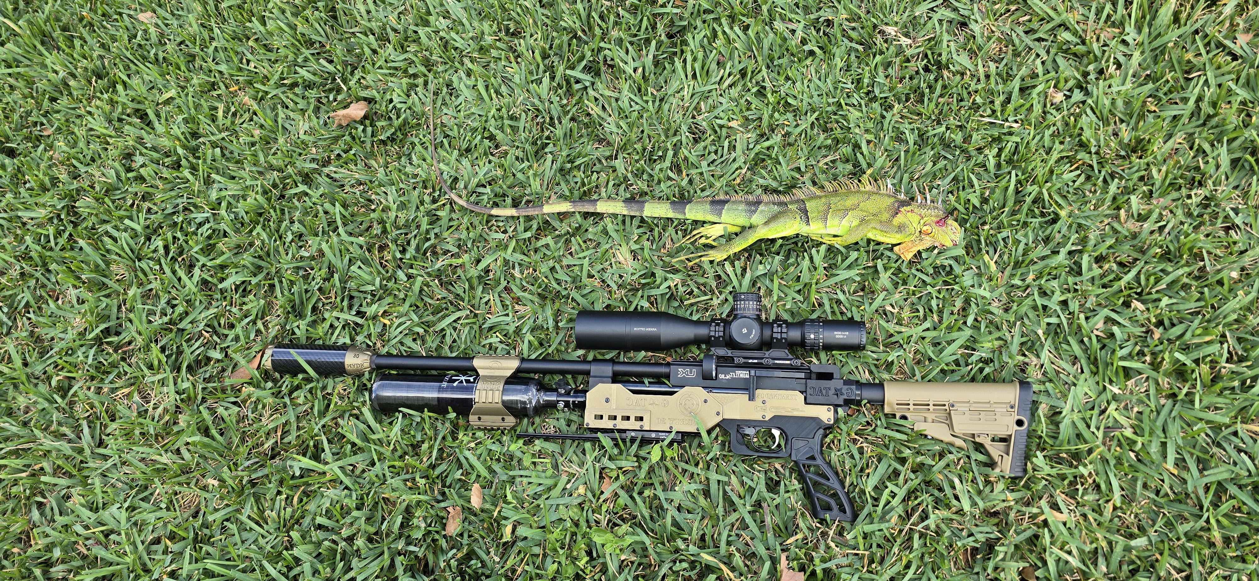

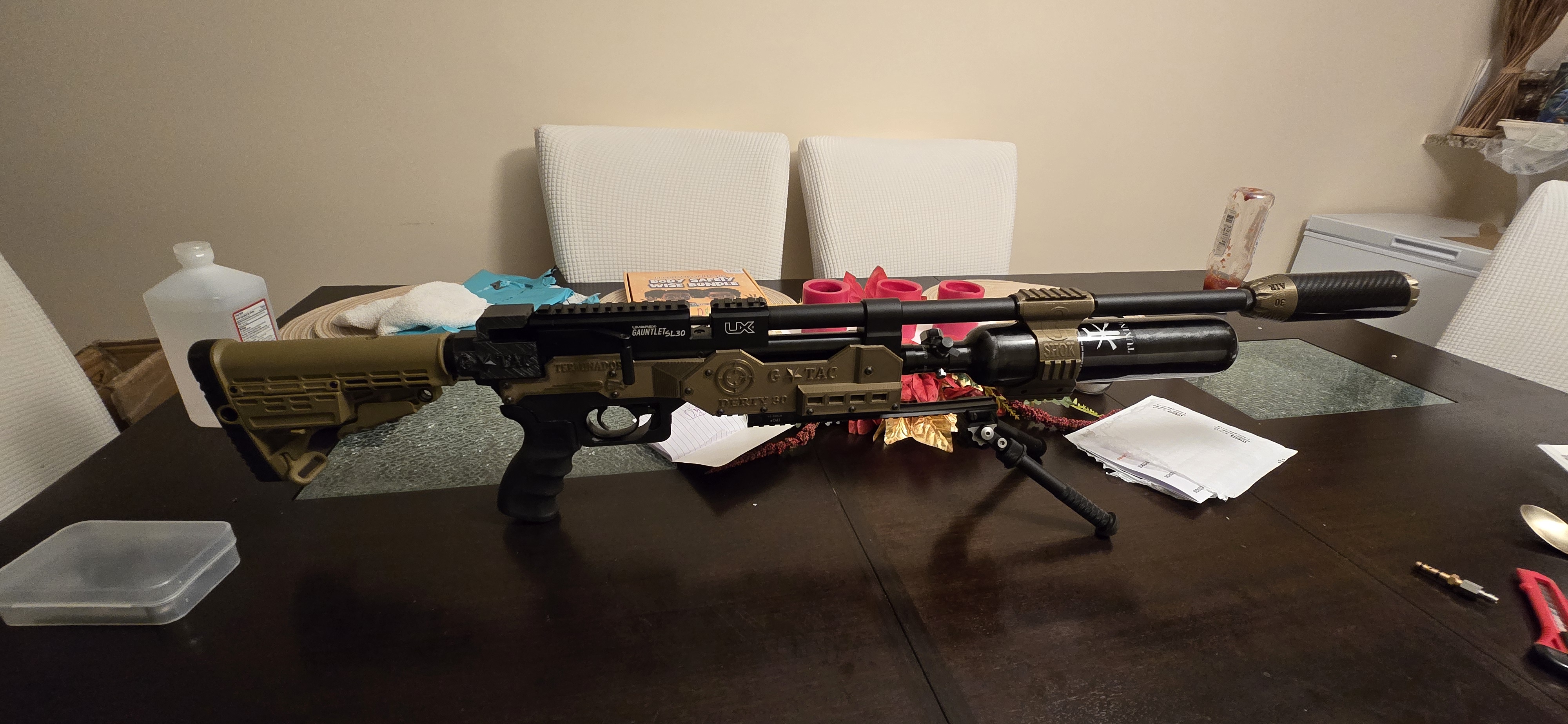

Finally back together. Used the longer NP-03 barrel and modified the suppressor to still function as a intended. It's hard to get an over head picture that shows the true length so I grabbed a few showing it's at the buttstock and end of the shroud. This one is factory .25 and with the modified parts it's doing right at 880fps with polymags and efficient with such a low pressure fill of only 200bar and only 200cc of air.

View attachment 552774View attachment 552775View attachment 552776View attachment 552777
Nice looking Pup. Might have to add one to the “want” list 😂. I’m partial to my compact dog walk guns 🤘
