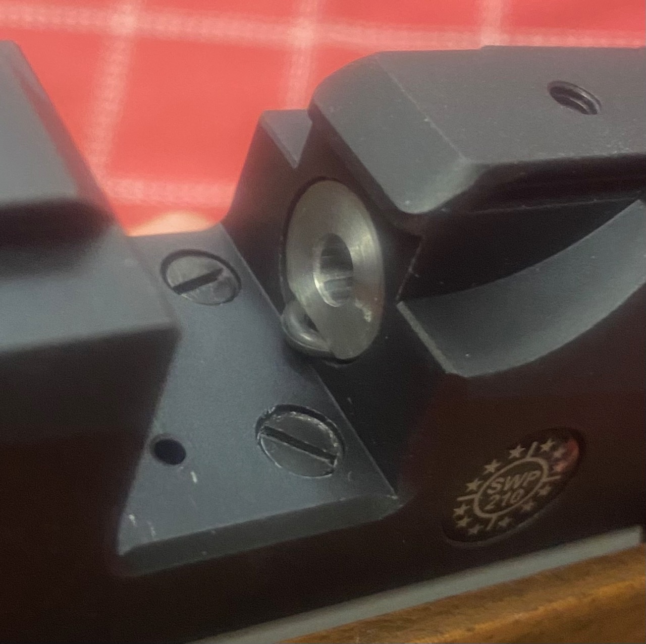

Would the same type of loudness occur using a 70 durometer pellet probe O-ring instead of the specified 90 duromete? (FAC rifle)
I ask because my (new to me) Revere 22 blows some air and noise back out of the breech

Ed, I had the opposite problem, got some harder breech o-rings that didn't seal as well as the OEM which were a lesser durometer reading. Some of them just don't quite fit as well.

Update.... So, I removed the magazine and attempted to install the factory single shot adapter for the tissue test. For some reason it would not snap into place, so I break out a small flashlight and have a close look. Low and behold, there is a small loop of O-ring protruding from under the rear of the barrel. That explains why the SS adapter didn`t fit and the extreme noise, along with the low power output. I assume this is going to be the upper O-ring from the brass transfer port. Not going to send this back to AOA for a simple repair, I will take this on myself. Thanks to all for the guidance.
Can you post photos of what you found. Thanks.
