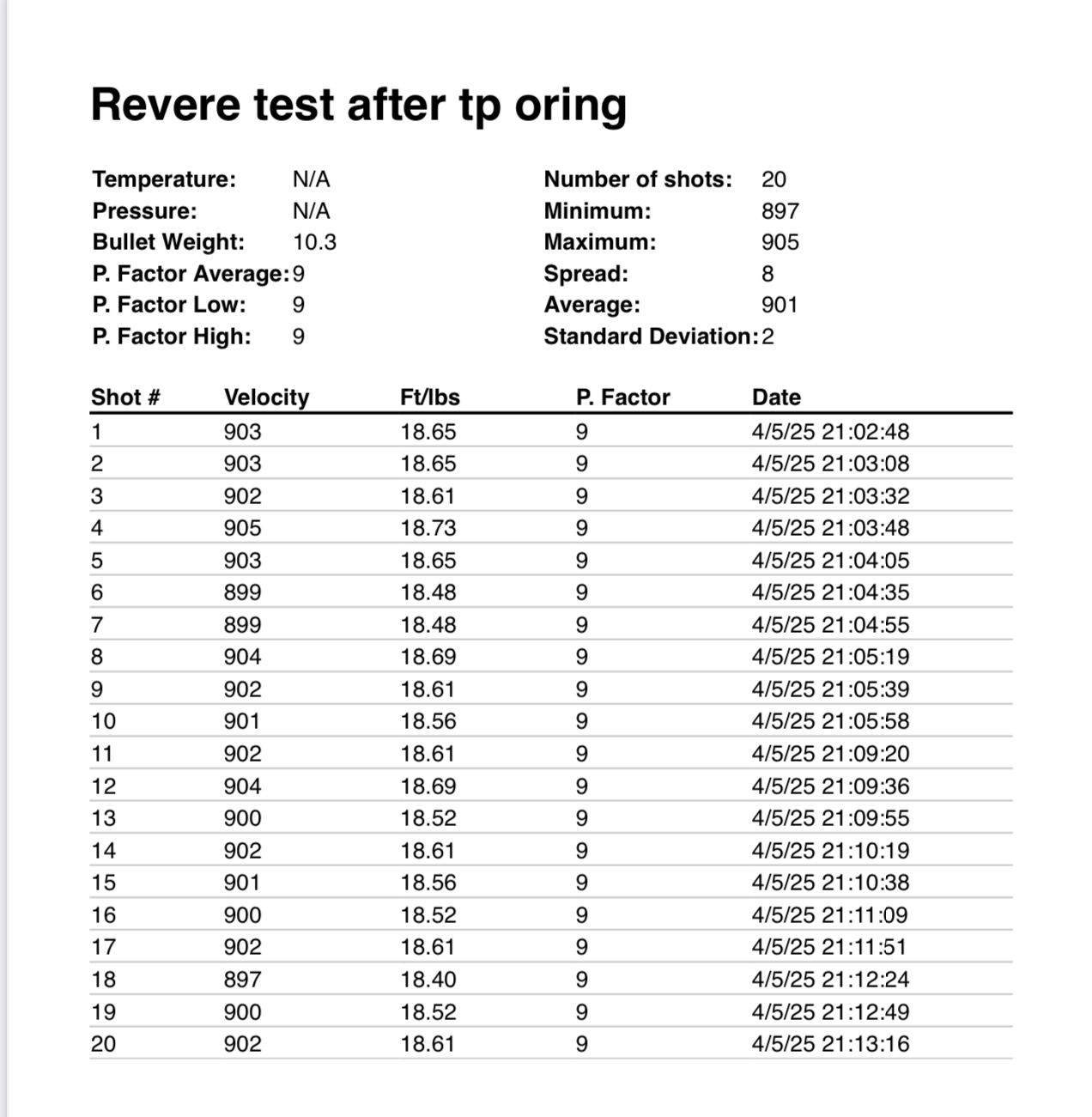

Thanks for the advice guys. AirRanger I think I was pretty careful matching the two halves up and my 20 shot string afterwards is showing good (see results below) and will likely get a better test at our Tuesday field target meet. Silent Squirrel thanks for the tip on 90 duro - wanna trade for some 70s, only have a hundred of them😂.
