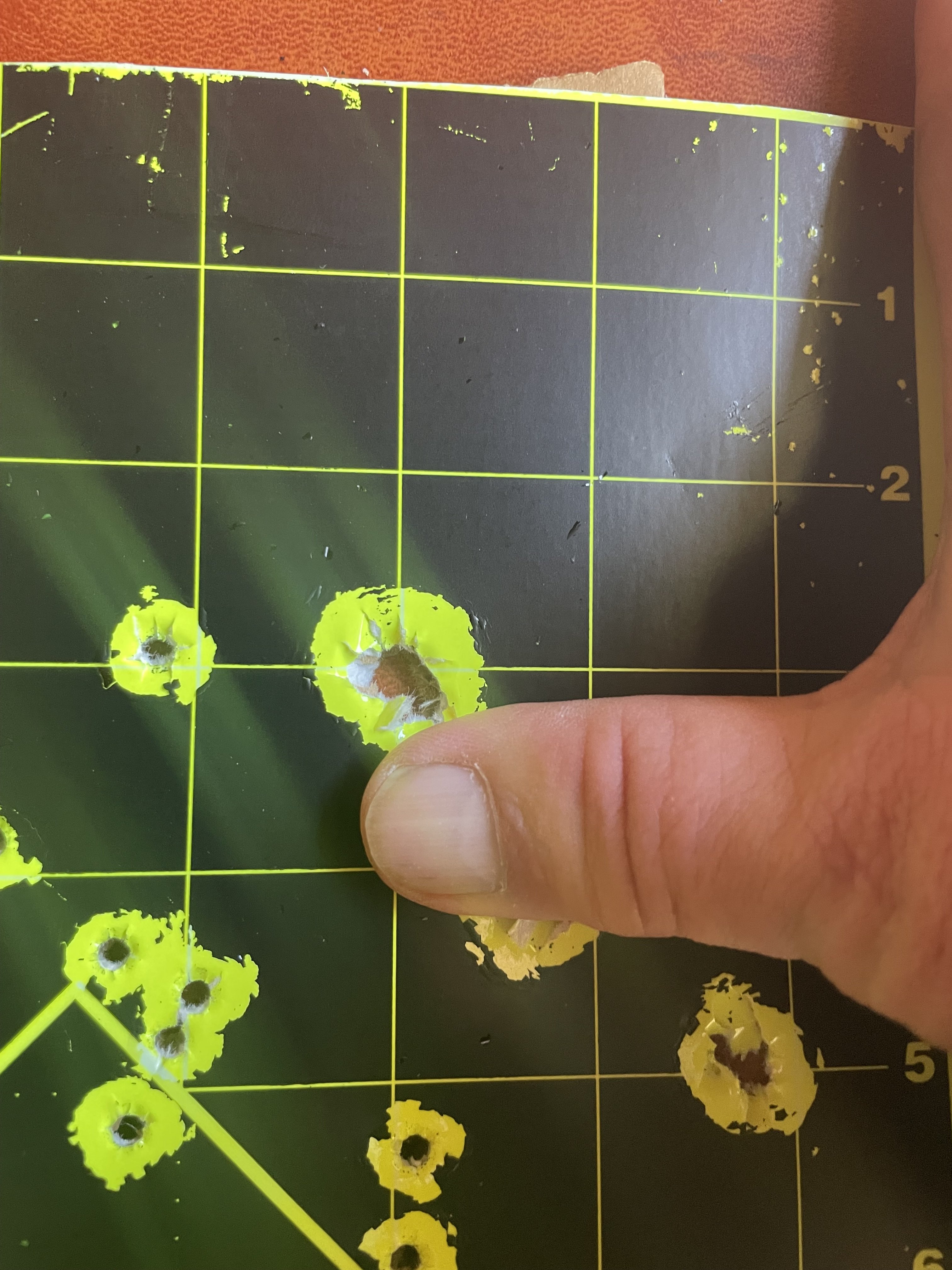

I haven't shot my M3 in a couple months as I've been occupied with my powder burners for deer season . I took the M3 out the case today and it was still at the exact amount of air it had when I cased it up. I topped it off with air and shot it some on my range.....I shot a full clip at 50 yards at one bullseye with unsorted pellets 33.95.... from the first shot to the last it made a nice hole in the target. I've noticed some of the FX haters lately ragging on the Impact but the fact is, it's a hell of a gun when you learn to tune it properly. When I first got it, I will admit it was aggravating trying to get it dialed in as I didn't know what the hell I was doing.... but once I finally learned how to set it up properly, it's Awesome now.....:)
