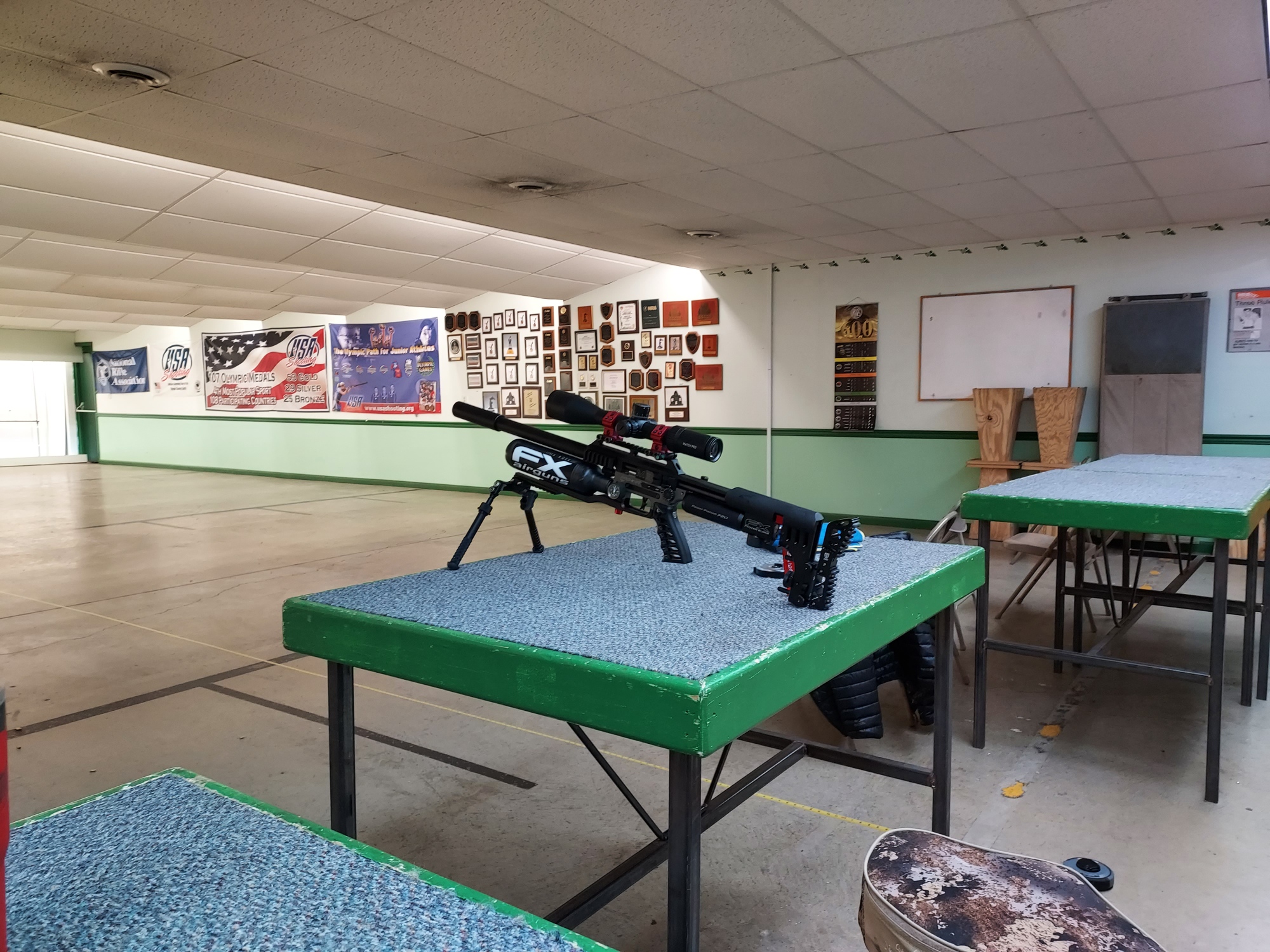

I run them anywhere between 880 and 900. Great results anywhere in that range out of my maverick compact.Well I finally had a chance to retune after I removed the first reg,(it was sitting for this long and is shooting the same as I left it about 880fps). I tuned up to 912 fps using the micro wheel and would not go any higher. Then I started turning the big wheel down to 12, and then I turned the valve in, in total about 3/4 of a turn. It right around 864 fps. The micro wheel is 2.4 big wheel 12 and the valve is on the 4th line and the reg pressure is 120. FX M3 compact .25 caliber and launching a 25.39 grain pellet . I did not get a chance to sight in, I think I can get to that tomorrow. What is the ideal or best fps for the m3 compact? I’m thinking maybe lowering another 10 to 13 psi. Tomorrow I will sight in and see.
