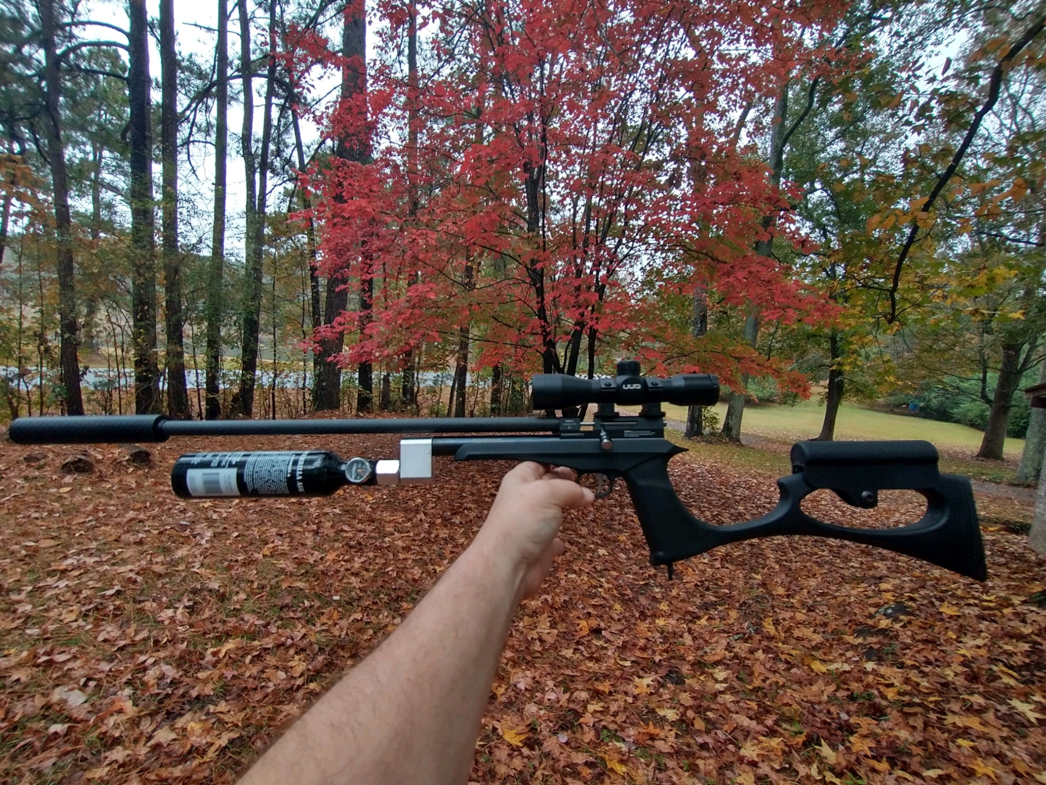

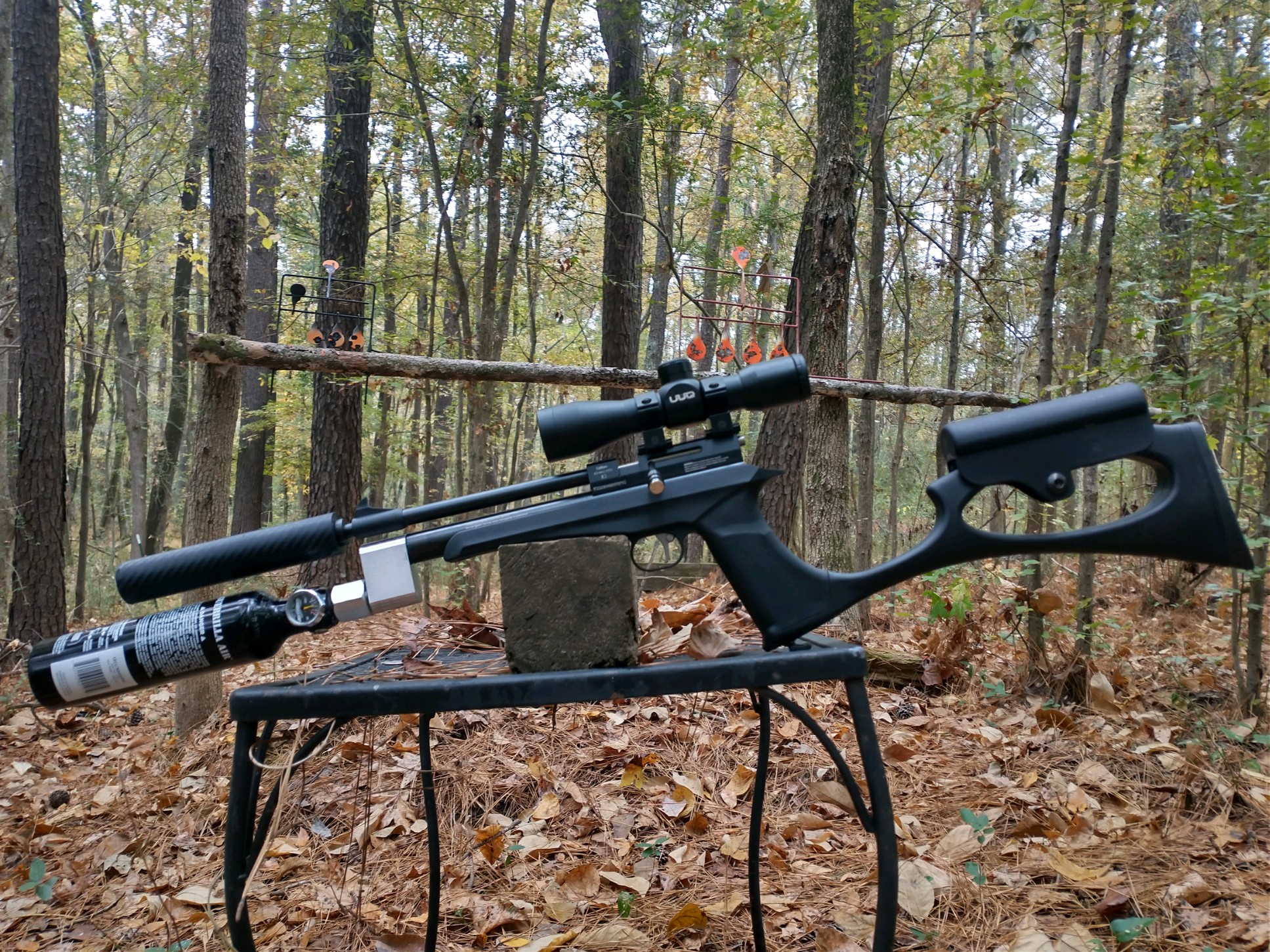

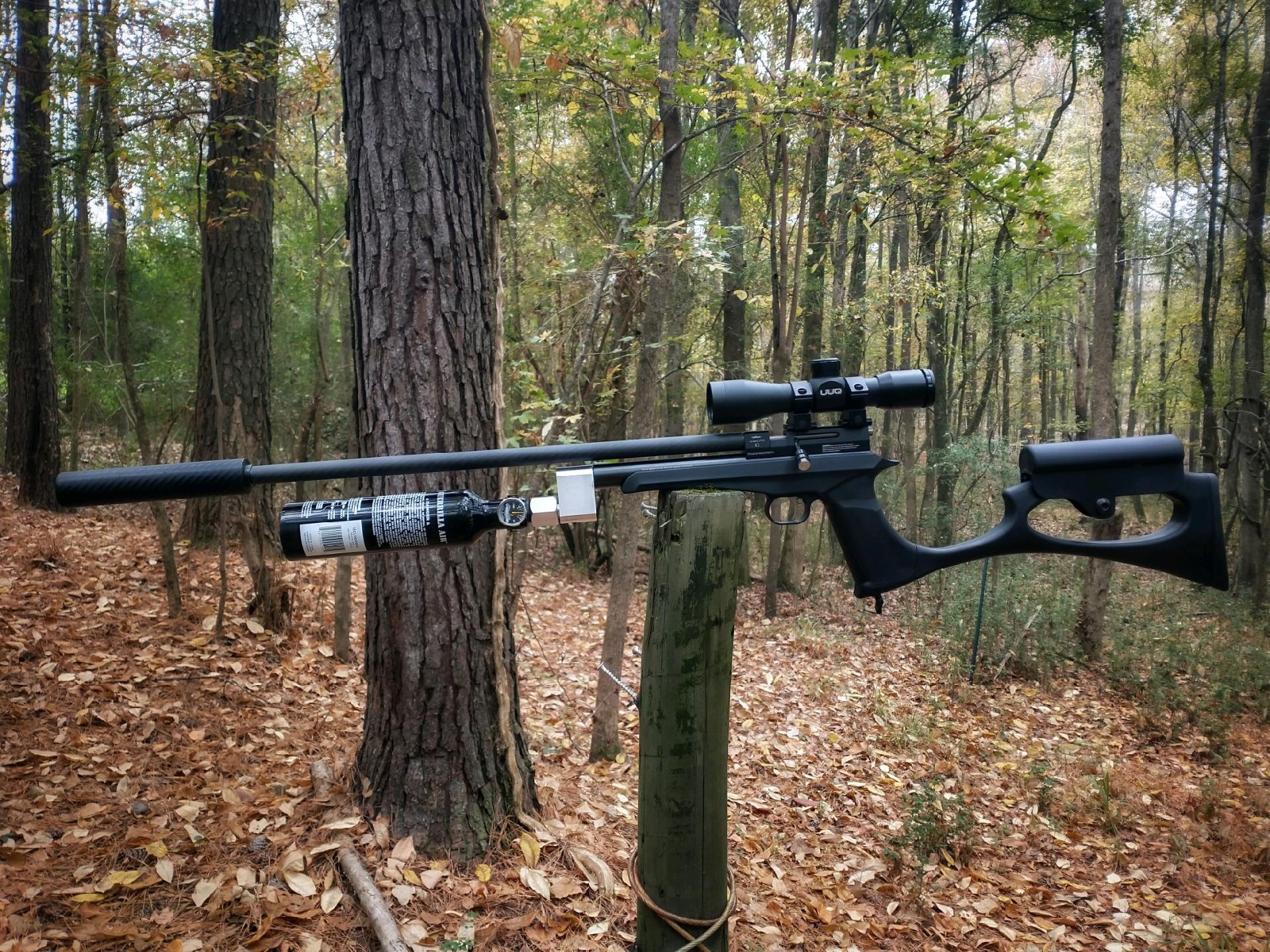

So you all know, I let her try out my Brocock Sniper XR at about 8.5 pounds all in and she was having a hard time with it. @EndinGa you may have a winner there now that I can see the full size! Once she got it on the tripod (Primos trigger stick) she was fine but it was a bit of work for her. An Air Force would work, but I'm afraid her dexterity with loading a single shot may be hard. She really enjoyed shooting the gun so I am trying my best to get her something she will enjoy.
