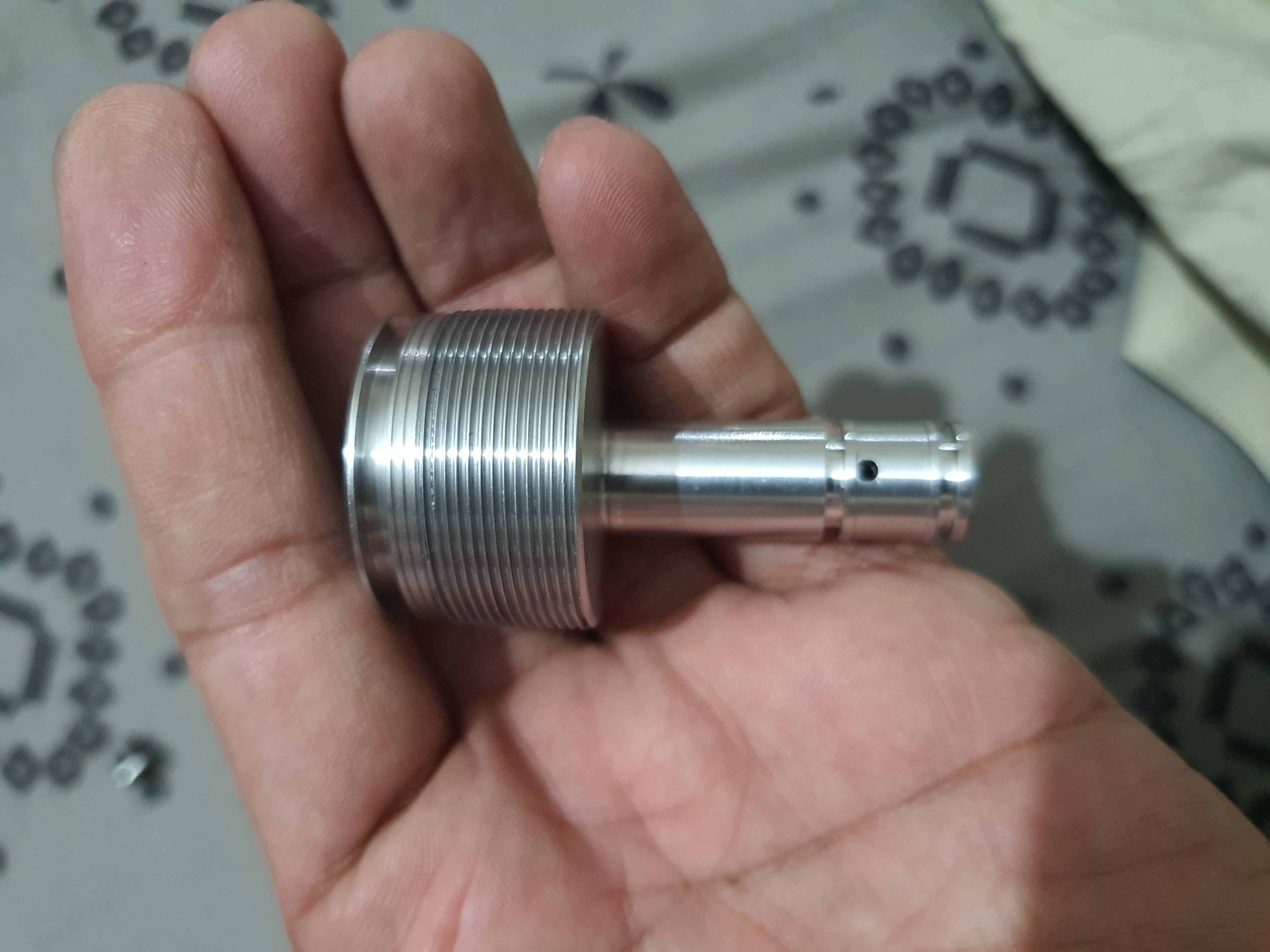

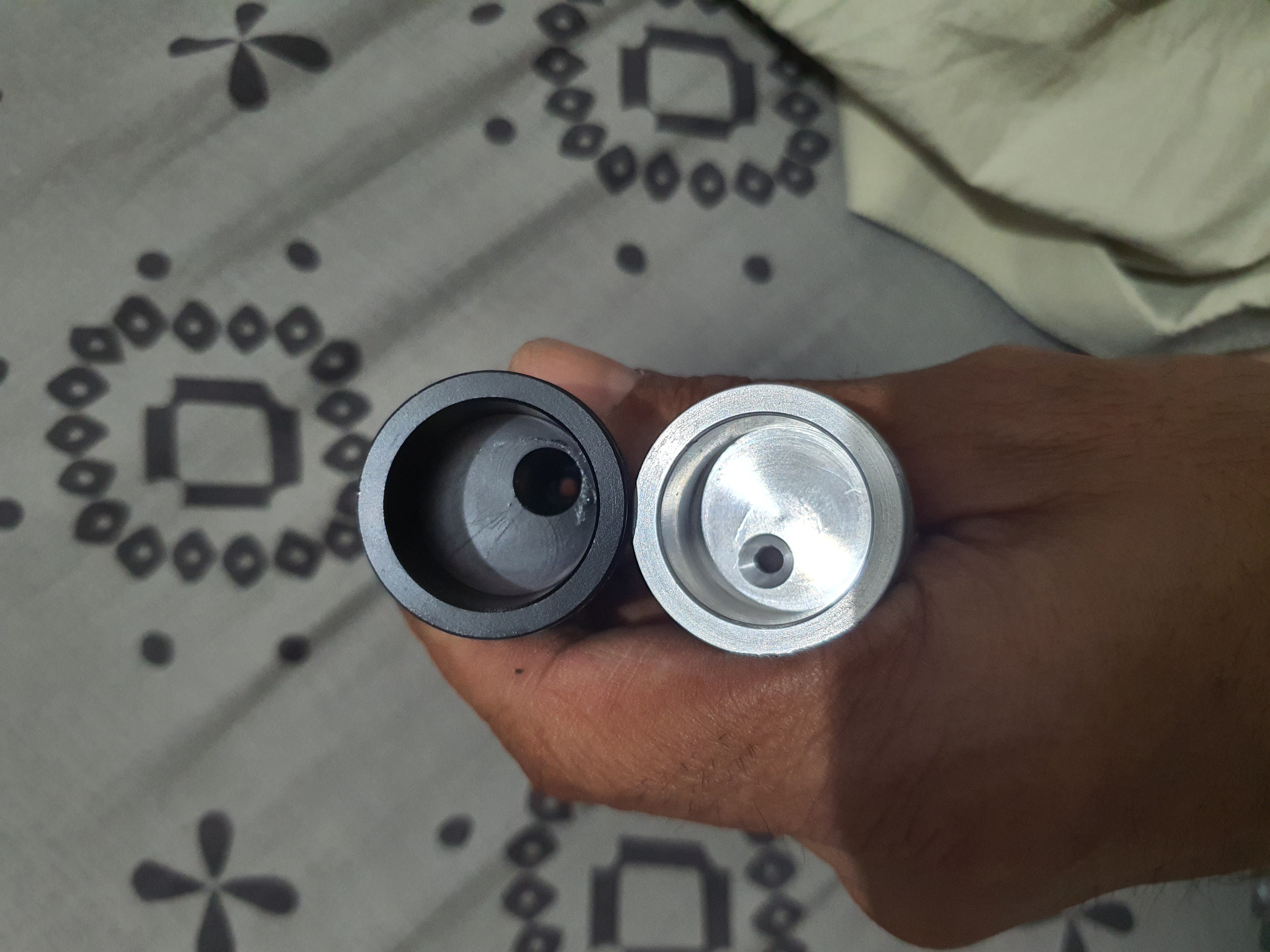

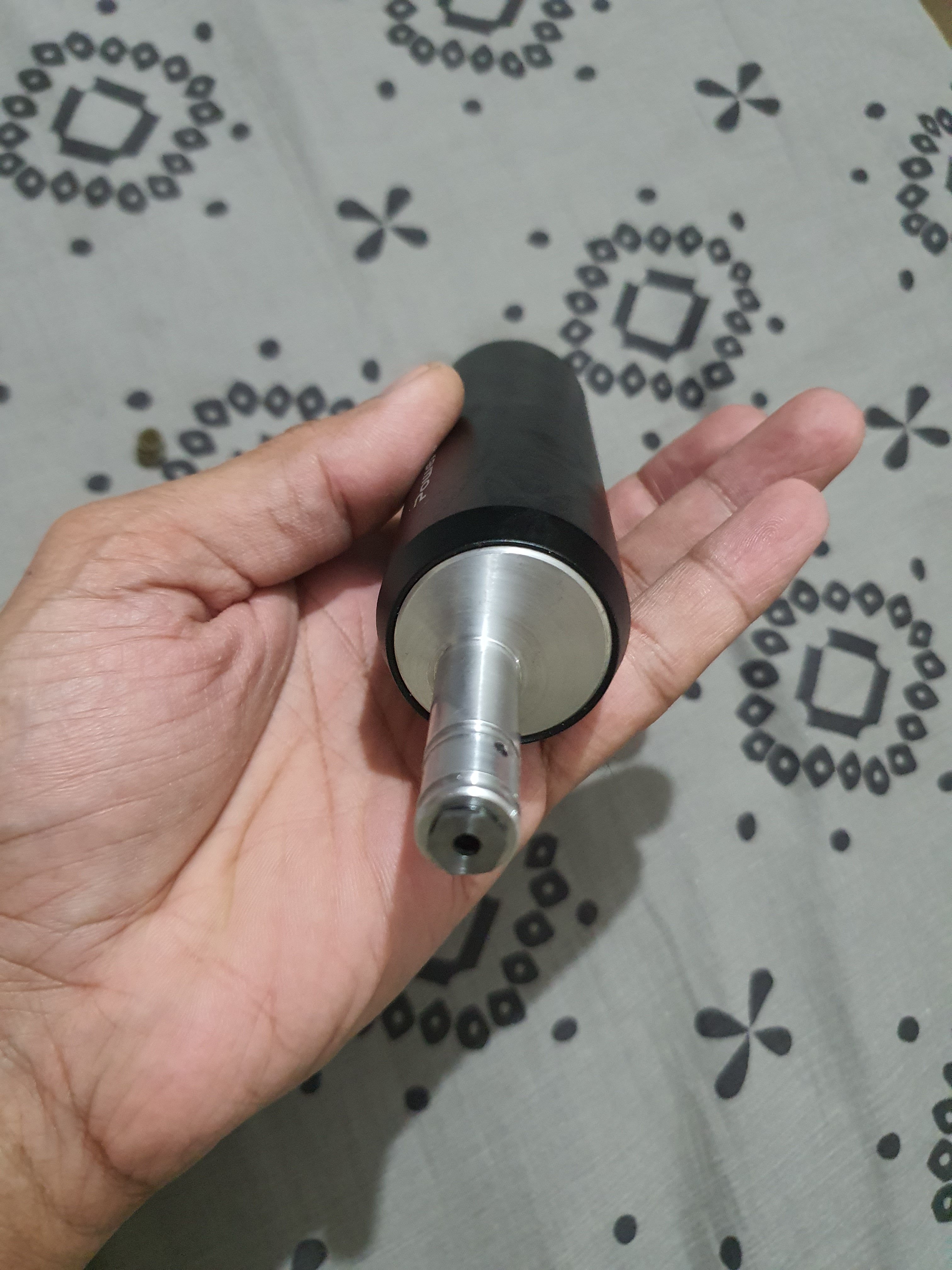

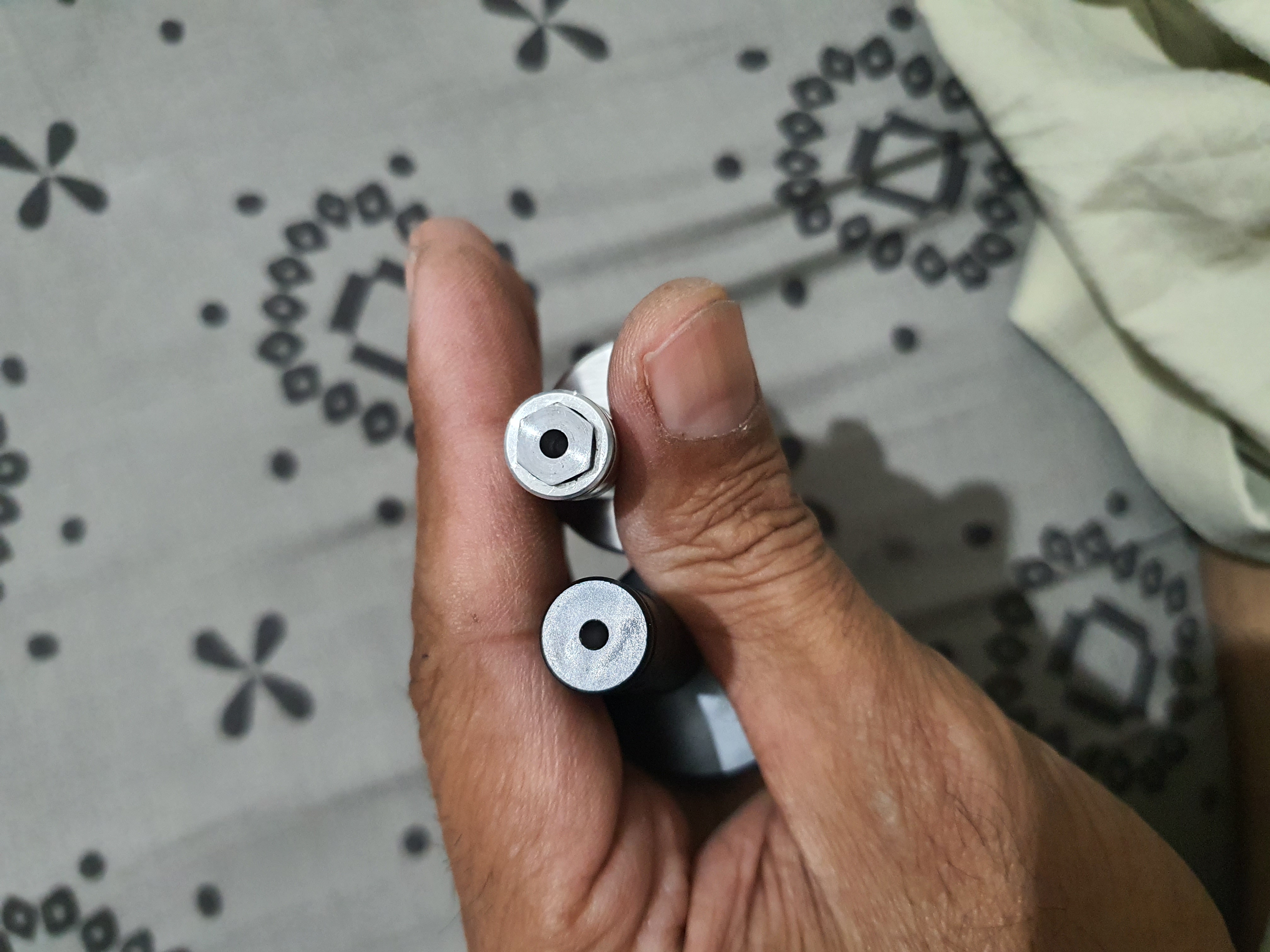

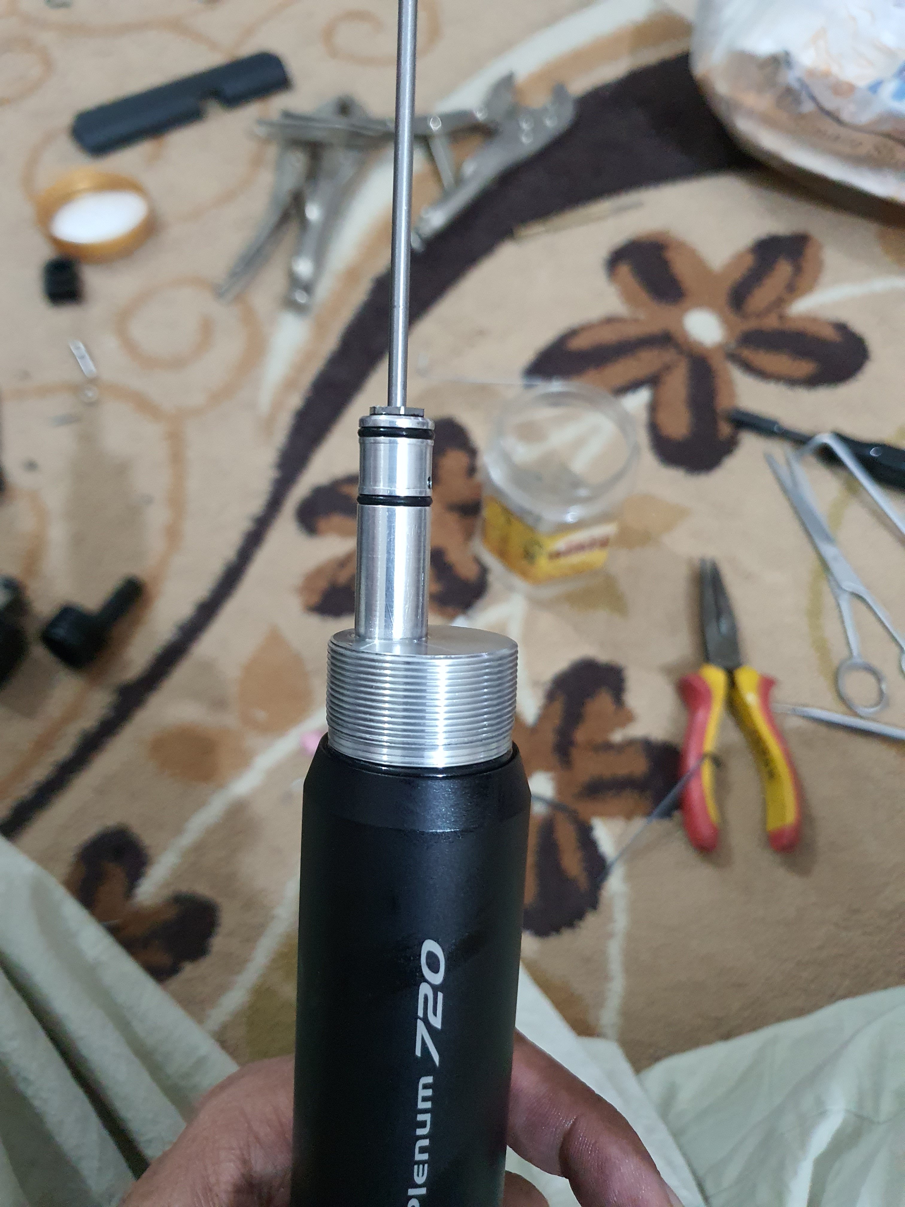

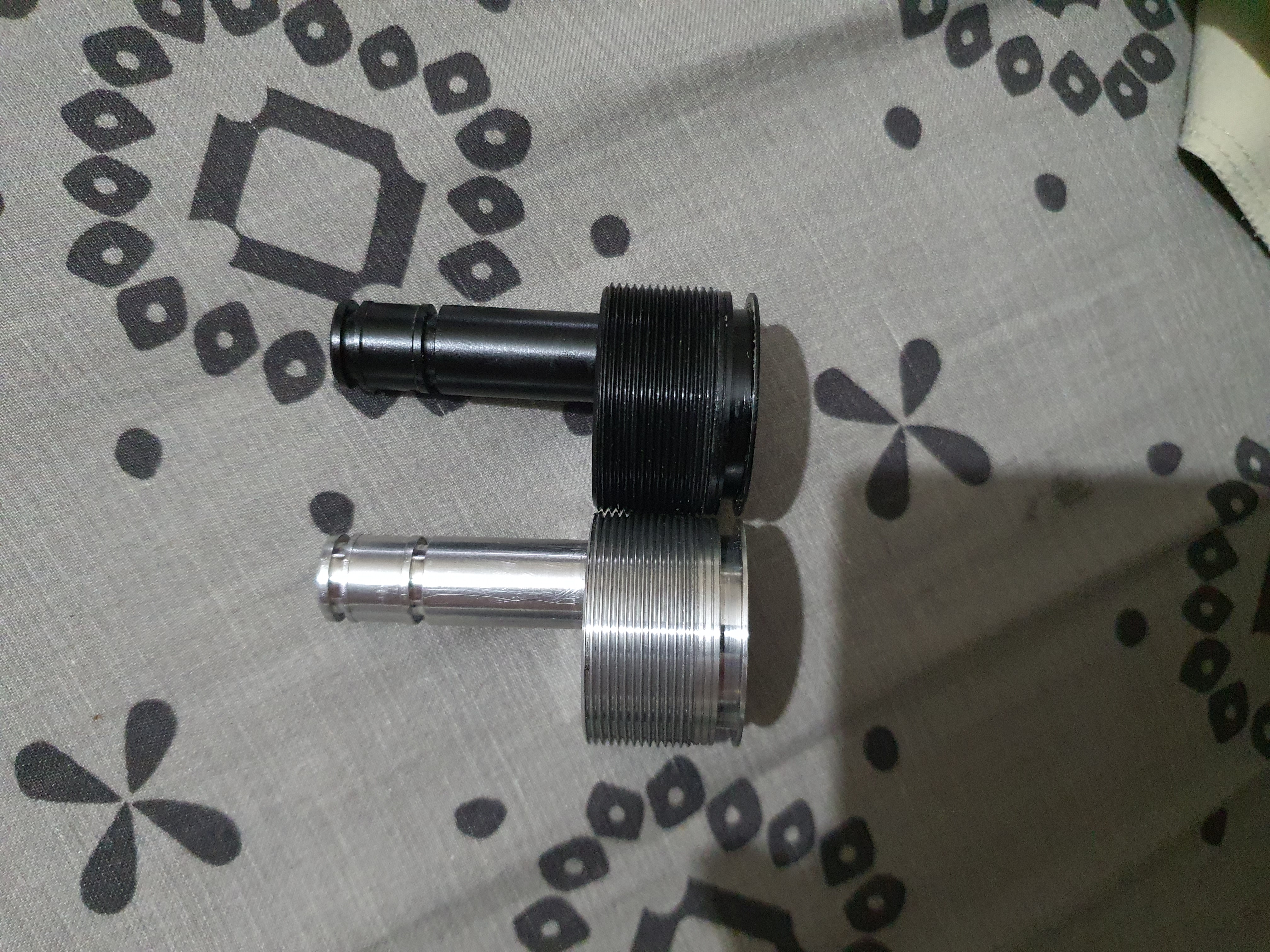

Initially I did the same. With high powers it works. The reason being the NBR doesn't get flexible after some use hence not notable extrusion.
The other way is to increase the hammer strike and restrict the valve travel by tightening valve adjuster.
But ultimately the comfort I had with FX impact mk1 with O ring from front style plenum could not be achieved specially with 18 grain .22 pellets.
So I made the front plenum part in mk1 style. It took some time to break in but after breaking in, I enjoy my M3 much more than before.

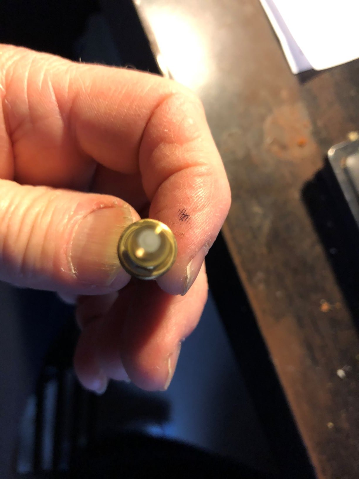

There are a couple ways to try to skin this cat but probably only two ways to do it properly. If you decide to try to overcome the sticking stock PUR oring by blasting it with a heavier hammer and spring, you’re going to have to control that with your valve knob. If you’re not shooting with very high reg pressures, you’re going to punish the valve spring and if you have a M3 the rubber balls also. If you just stick a Viton or NBR oring in there without a peek washer, that things lifespan is going to be short. That’s why FX used that big nasty PUR. It can handle extrusion without coming apart. So, either you peek washer/90 it or replace the plenum piece with a mubhaur piece.

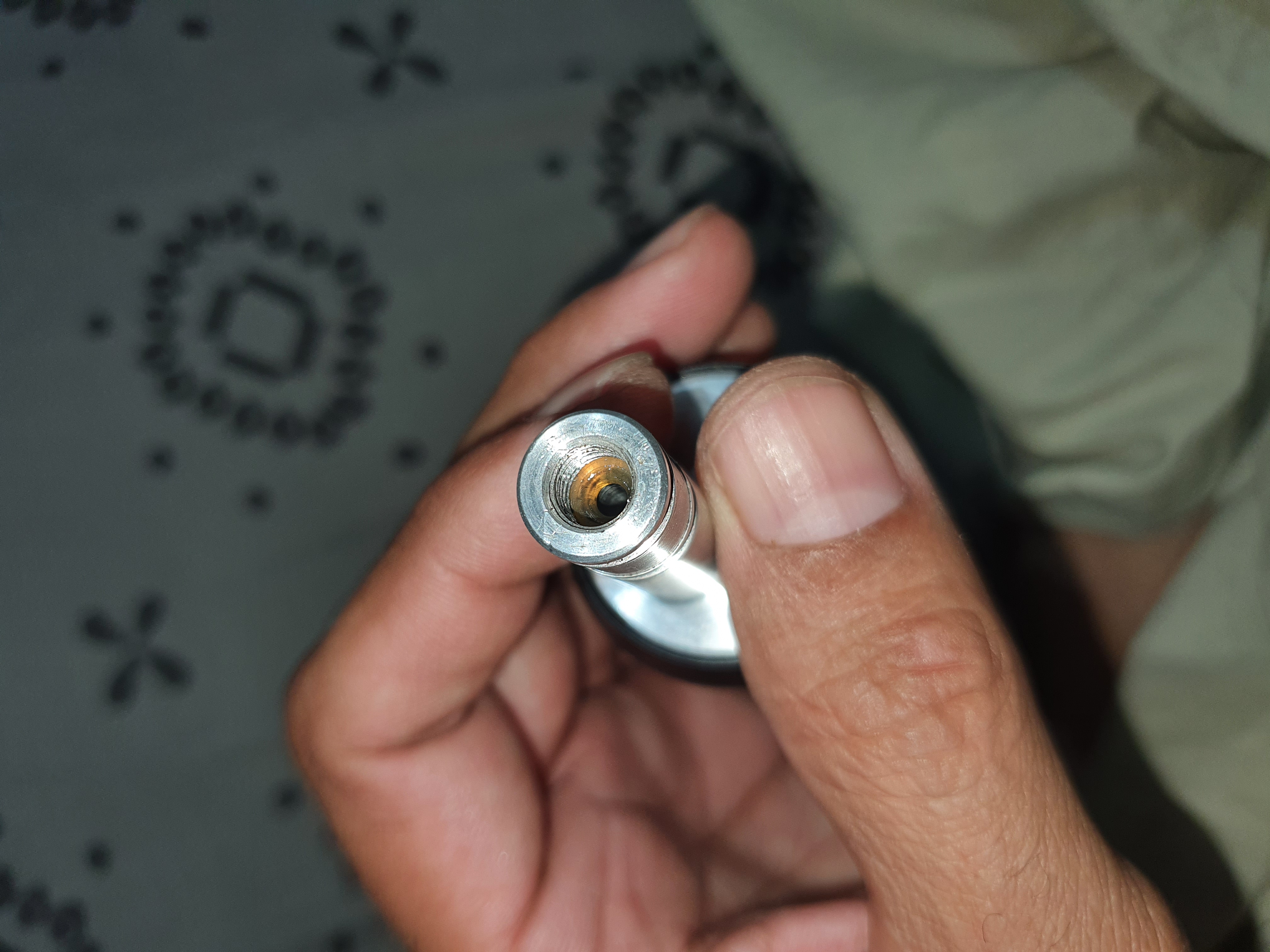

Actually that PUR90 oring suffered from extrusion in my case. I even posted a picture of that in the mentioned thread. A peek washer or mubhaur's plug is a must regardless of the oring used.
Yes but the PUR won’t fail as quickly as a Viton or NBR if you skip the peek disc. I am kinda curious how long a NBR 90 will last being pressed into that cone by 140b.
