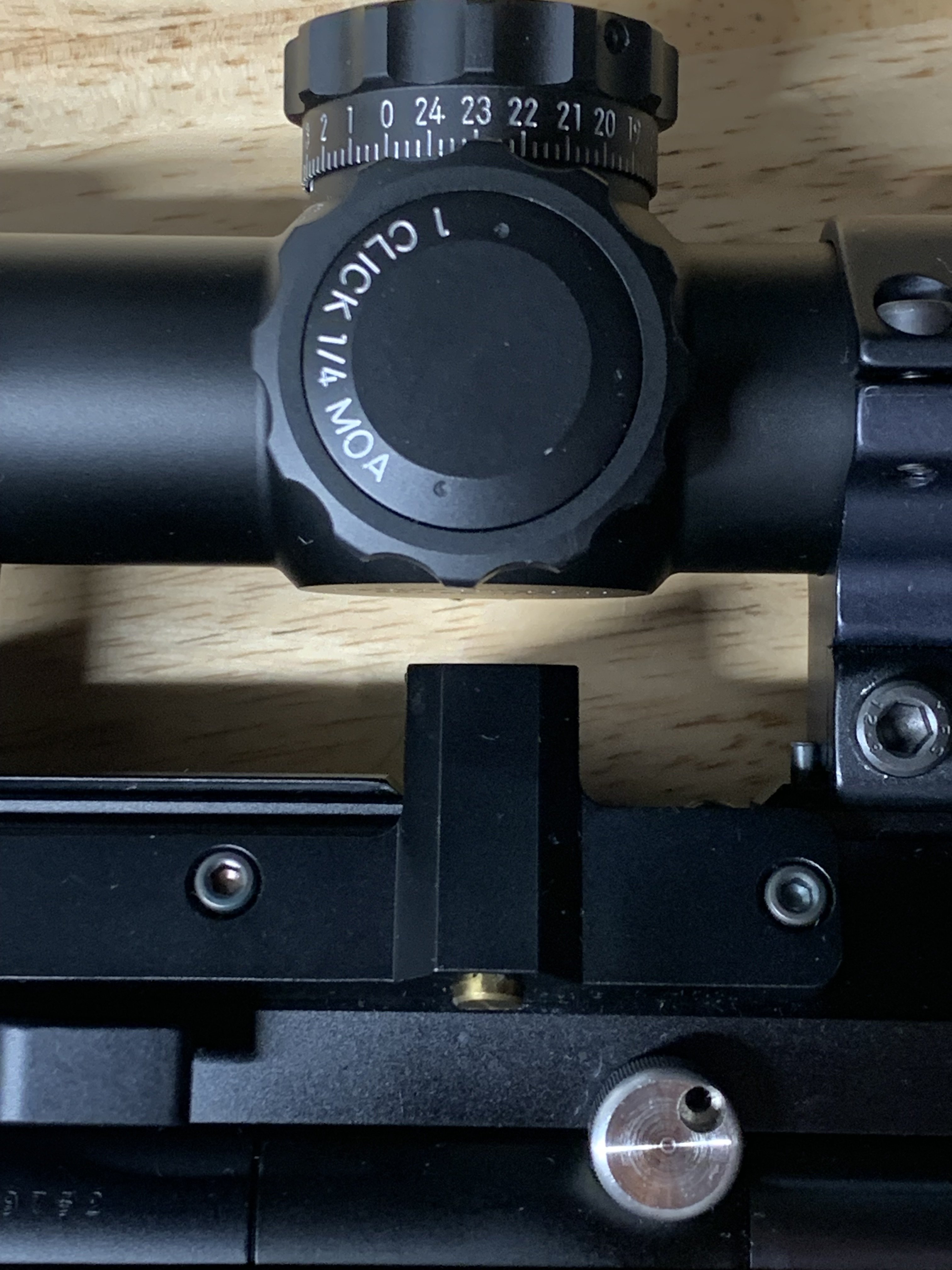

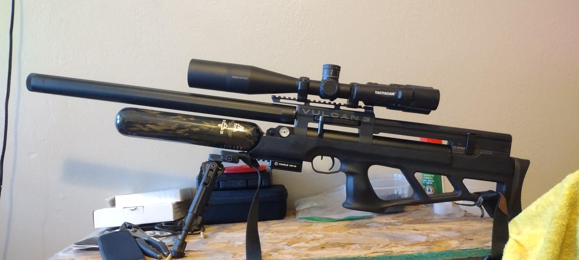

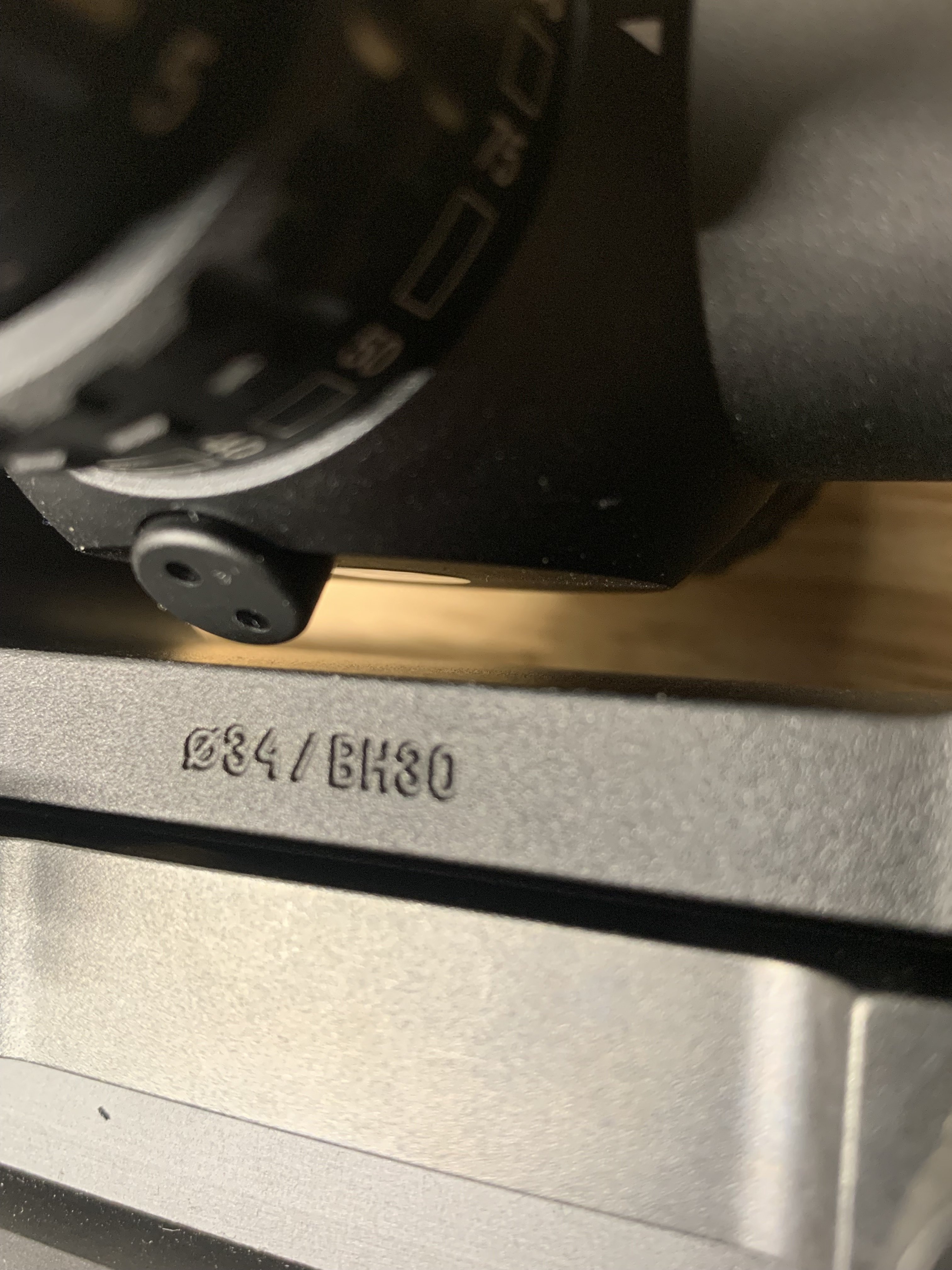

I use Sportsmatch high rings and have no real issues with comfort or ergonomics. A little lower would be nice too, but you need to clear the top of the mag of course, and Arken scopes also have a larger turret housing and plug on the underside of the saddle. Sportsmatch list their scope heights kind of weird, so top of the dovetail to centerline of scope is 1.3” on their high rings. Many manufacturers’ medium rings would be 1.25” for the comparable dimension. Here’s a few pics. Scope on the gun is a 30mm tube for reference. My Arken is a 34mm tube, but the erector plug looks similar between their different lines.
