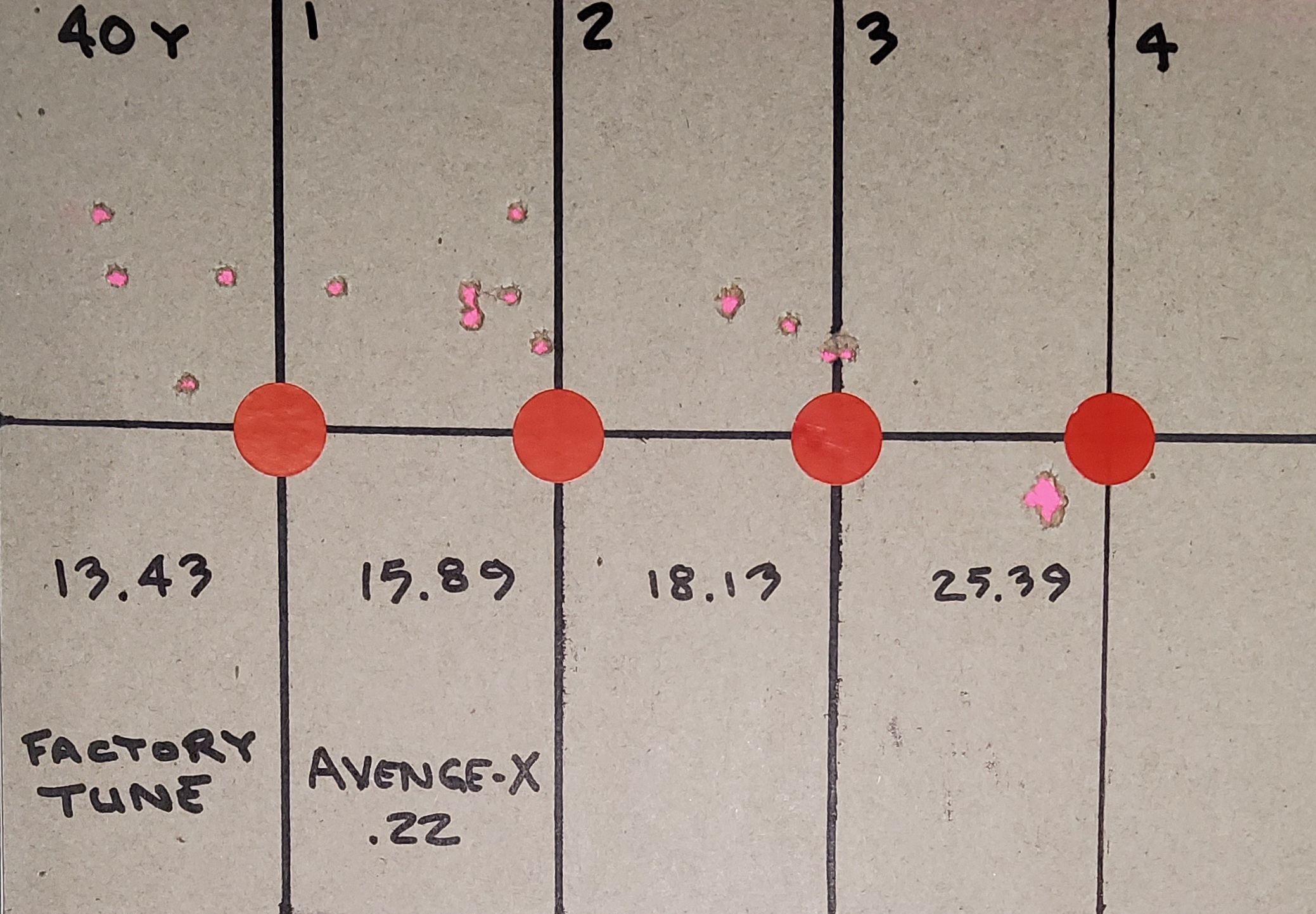

My .22 caliber Avenge-X was factory set to shoot 25 grain pellets very accurately, anything lighter was scattered into a loose pattern.
The problem was that the regulator was set to minimum at 150 bar and (mechanically) could not be reduced to shoot lighter pellets. Crosman 14.4 grain were running around 1000 fps.
I had intended to get .177 and. 25 barrel kits for the Avenge-X and test the whole spectrum of weights on that platform. Given the regulator issue I canceled the project and returned the PCP for refund.
.177 target rifles usually are setup to shoot wadcutters at 500 to 650 fps. I've had good luck shooting .22 caliber wadcutters at low speeds (guessing around 500 fps) from my Benjamin 392 multi-pump but since I was just plinking, I never checked the velocity of did any grouping.
Suggest that you check to see how low you can set your regulator.
Below you can see how the pellet weight affected the (5 shot) group size. Obviously, my Avenge-X was tuned to the 25 grain pellets.
