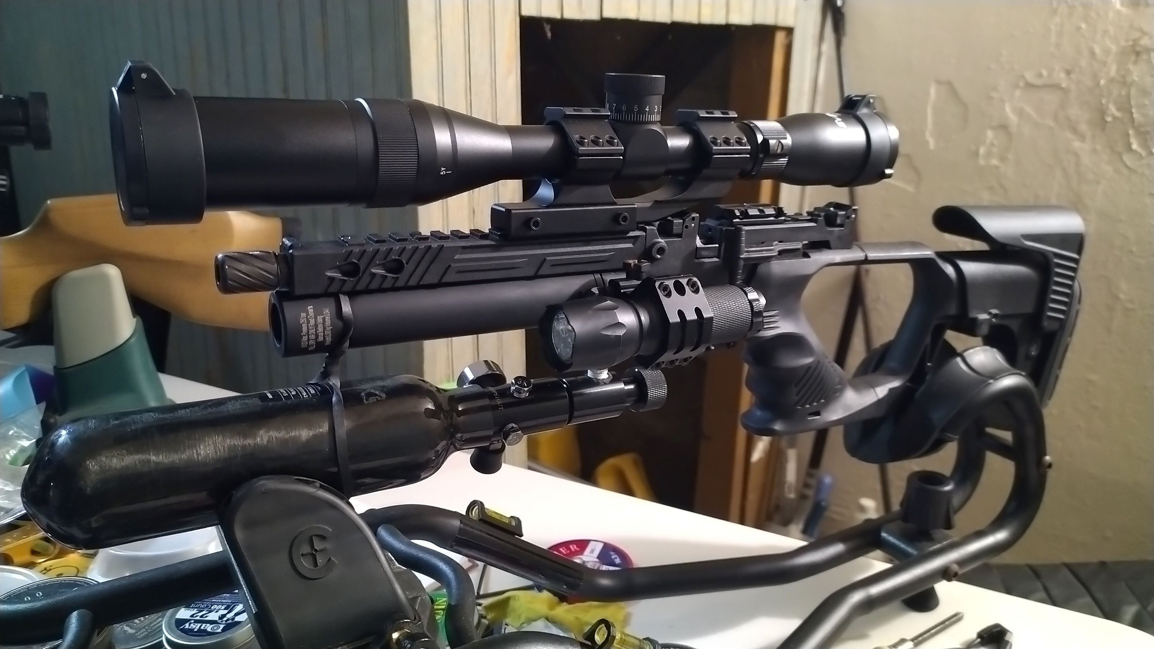

My first P35 was a 25 because that was all I could find. I tested various pellets and settled on 20 grain H&N FTT. I lowered the regulator and had them going over 800 fps. A little over 30 fpe. I took 18 squirrels with it at that tune. Whacked them hard. A jaw impact crushed the skull. Only 3 pellets failed to exit. It's tuned for more power now for the occasional bigger critter but lower power 25s definitely work.

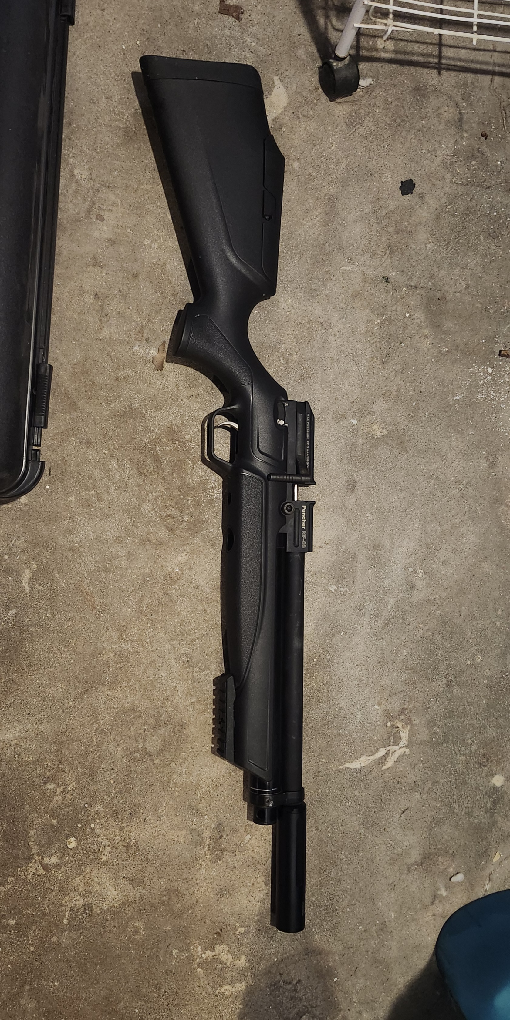

I’ve already been producing these .25 barn guns and field tested for 5 years now. Guys are buying them for multiple uses because the power range goes from 400 ft./s to 700 ft./s.. They are even a hit down in Florida for iguana hunting. Read the specs. M&M Guide Services use these for their customers to shoot.
