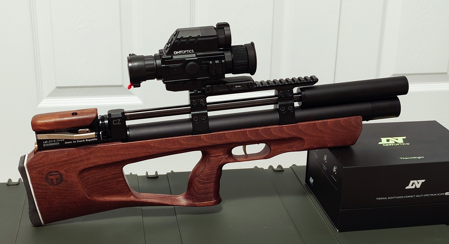

Here it is guys! I really love the way it looks! The wood stock is visually well proportioned to the size of the rifle. I've been a Taipan fan for almost 5 years now but I've never even considered buying the Compact before. Now that I have it though, I really like it! It's noticeably lighter and shorter than the Standard Veteran. I can't believe Taipan gave up on this size rifles. I think it's perfect for a modest tune.
I had a little bit of trouble tuning this one tonight. It came from the factory shooting about 42 FPE. I didn't do much shooting at that power but from reading other people's experiences, it probably gets around 30 shots on the reg from a full 250 bar fill at that power tune. I initially wanted around 20 to 23 FPE with the .25 JSB King 25.39gr but I ran into an issue where the hammer spring is just too much even backed out all the way. Meaning that for a particular reg pressure that would give me 23 FPE, I am unable to back out the hammer enough to give even just 2% lower velocity than maximum. That was at 50 bar and 60 bar reg pressure where the hammer spring was too much. I could probably achieve that tune with a lighter hammer spring but I just decided to tune it up a bit instead.
I was successful tuning it at 70 bars reg pressure. This gives a maximum velocity of 695 FPS with the 25.39gr JSB. I then backed the hammer spring down to give a final tune of 675 FPS (25 FPE). I haven't done a full shot string, but from the tuning shots, at 25 FPE, it's using only 2 bars per shot. This gives 90 shots on the reg from a full 250 bar fill! :eek:
In comparison, when I had the reg pressure at 60 bars, even backed all the way down, the hammer spring tension was still too much for that reg pressure that the best shot count estimates I got was only 57 shots. The valve was just too light at that pressure.

Yes you're right, Taipan basically discontinued the shorter guns and started with the Long size now only getting longer from there. The Compact might generally be not popular but I think many people will actually like the size of it if they've had the chance to see it in person and actually get the chance to use one. I'm one such person. I think the size and looks are just awesome.
I finally got the chance to shoot the rifle tonight outside of just chronograph testings inside my enclosed gun room so I now have a better idea of the gun's loudness. I'm not going to over exaggerate and use terms such as "mouse fart quiet" or "I thought the gun was broken". It is still a 25 FPE gun after all. Having said that, it is noticeably quieter than my Veteran Long in .22 tuned to 32 FPE. It is also quieter than the Veteran Standard in .22 tuned to 27 FPE. With the 30+ FPE .22 caliber Taipan rifles, I always have to wear hearing protection whenever I shoot more than 5 or 10 shots in a session from inside a window because it really hurts my ears and I get a major headache afterwards. No such issues with the Compact... and I shot waaaay more than just 10 shots tonight. The sound of the Compact at this power tune is so smooth. The best way I can describe it is a hollow tube "thump" sound letting you know that a projectile has been blown out of the barrel.
I've also gotten a better idea of the shot count estimates. Based on all the shots I did tonight, it is giving me a calculated estimate of 83 shots from a full 250 bar fill.
The tune also has a great shot to shot consistency. Although I have not done an actual one session shot string, every time I chronograph at the muzzle, it's always been around 674 FPS or 675FPS. The highest I've seen it is 684 FPS when the rifle has sat unused for 16 hours. This is why I really take my time with the tuning because as a standby varmint rifle, that first "cold barrel" shot is really important to me.
I also chronographed the gun at 32 meters and it's giving me a pressure corrected BC of 0.042 for the JSB King 25.39gr.
So far, I'm really happy with how this "low power" venture is turning out to be... The quietness and smoothness of the shot cycle, the high number of shots per fill, the shot to shot consistency, and the size, weight, and overall appearance of the rifle all seem quite awesome!
