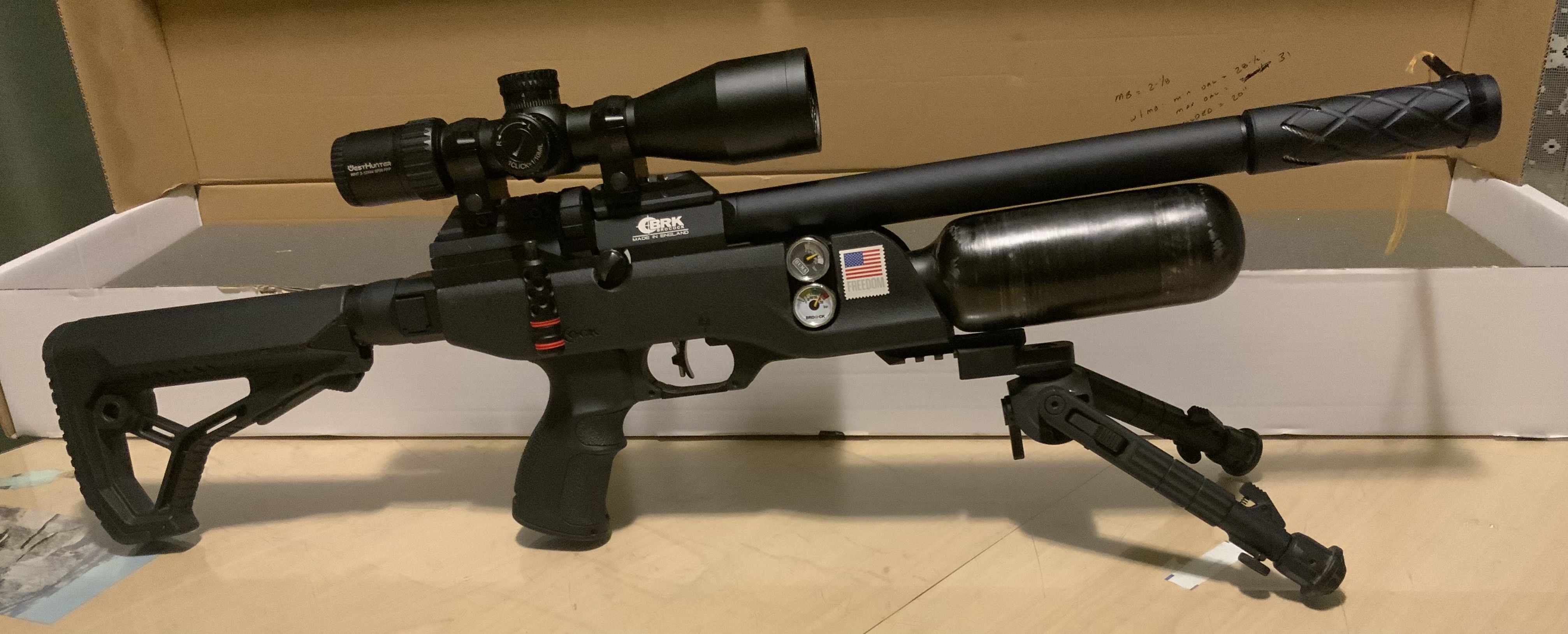

Agreed with the above or, simply sell the Evol and buy a PCP that’s easier to tune up or down via exterior adjustments… Can’t resist showing my current favorite BRK, the Pathfinder XR. External adustment available without special tools: TP (knob on side) regulator (underside) and HS (via a hole accessible by folding the stock. Of late with the TP on low, she has been stellar out to 50yards sending CPHPs.

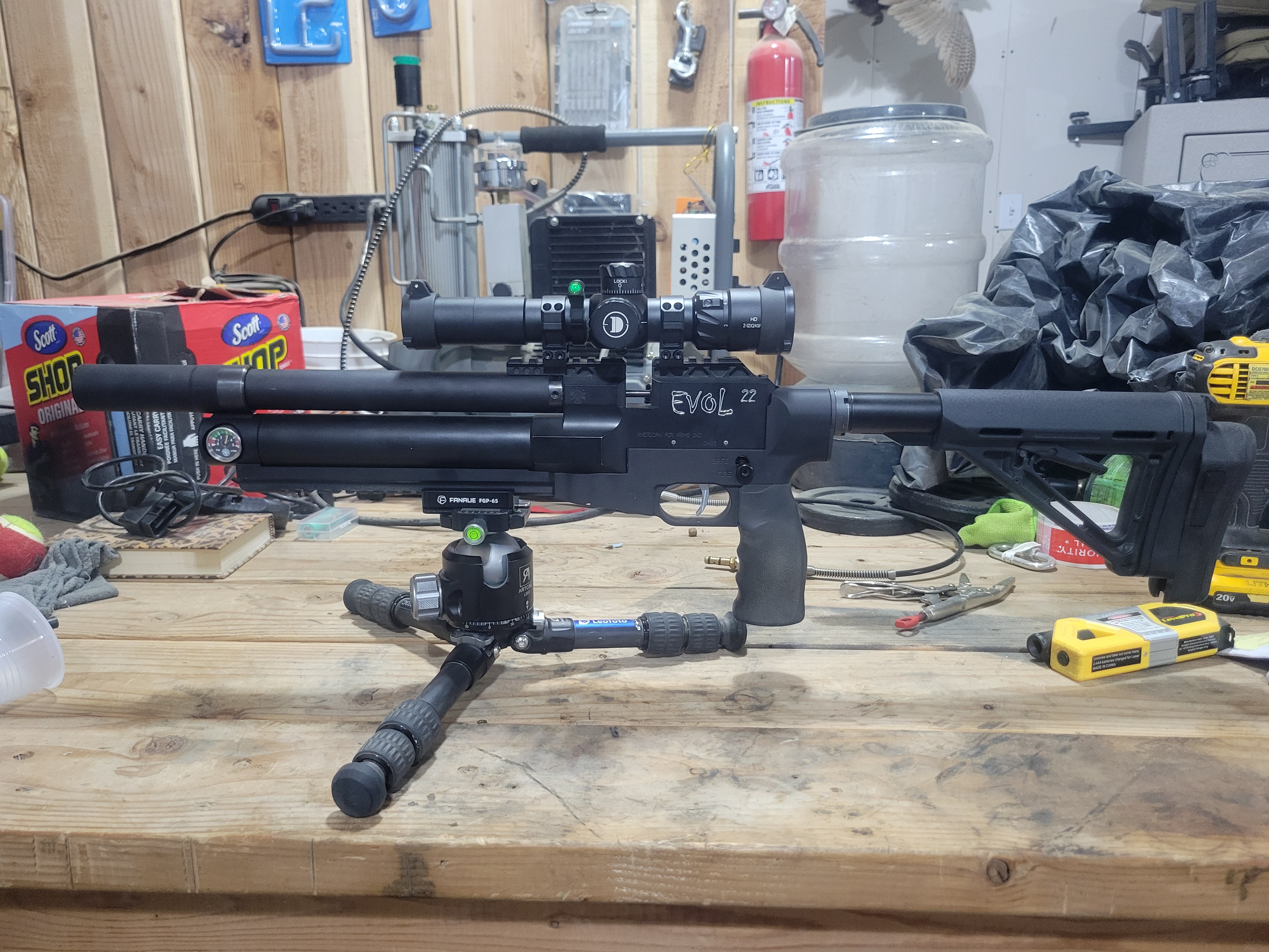

Got it setup with its new scope. 7lbs and 3oz minus the tripod. Can get it even lighter without the adjustable buttpad adapter but shoulders better with it. Ready to sight in in the morning. View attachment 499419
Look forward to hearing your thoughts on the scope here or in the other thread. Looks awesome with that size scope. Good fit.
