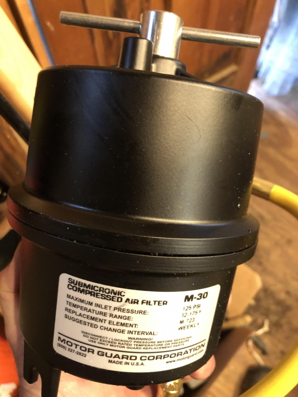

I fill with an Altaros Booster and like to filter humidity and debris between the Shop Compressor and the Altaros, as well as after the Altaros.
Recently I noticed my filter took a dive and left me hanging with a big leak. I’m looking for recommendations for an effective and hopefully inexpensive alternative to mine. The media was kind of hard to get and expensive for what I need.
This is what I had:
1548625782_15266844395c4e2776c0b4c1.01949146_B3F23EA7-9535-4394-8784-25C18AC7A56E.jpeg
did you try and lube the square o ring when you connect them togetheror is it leaking from a crack we have 3 of these inline at work for our plasma and they work pretty good you be surprised what a toilet paper filter will keep out
Will inspect more closely, but I think the metal may have decayed. Probably my fault, should have changed filter sooner.
