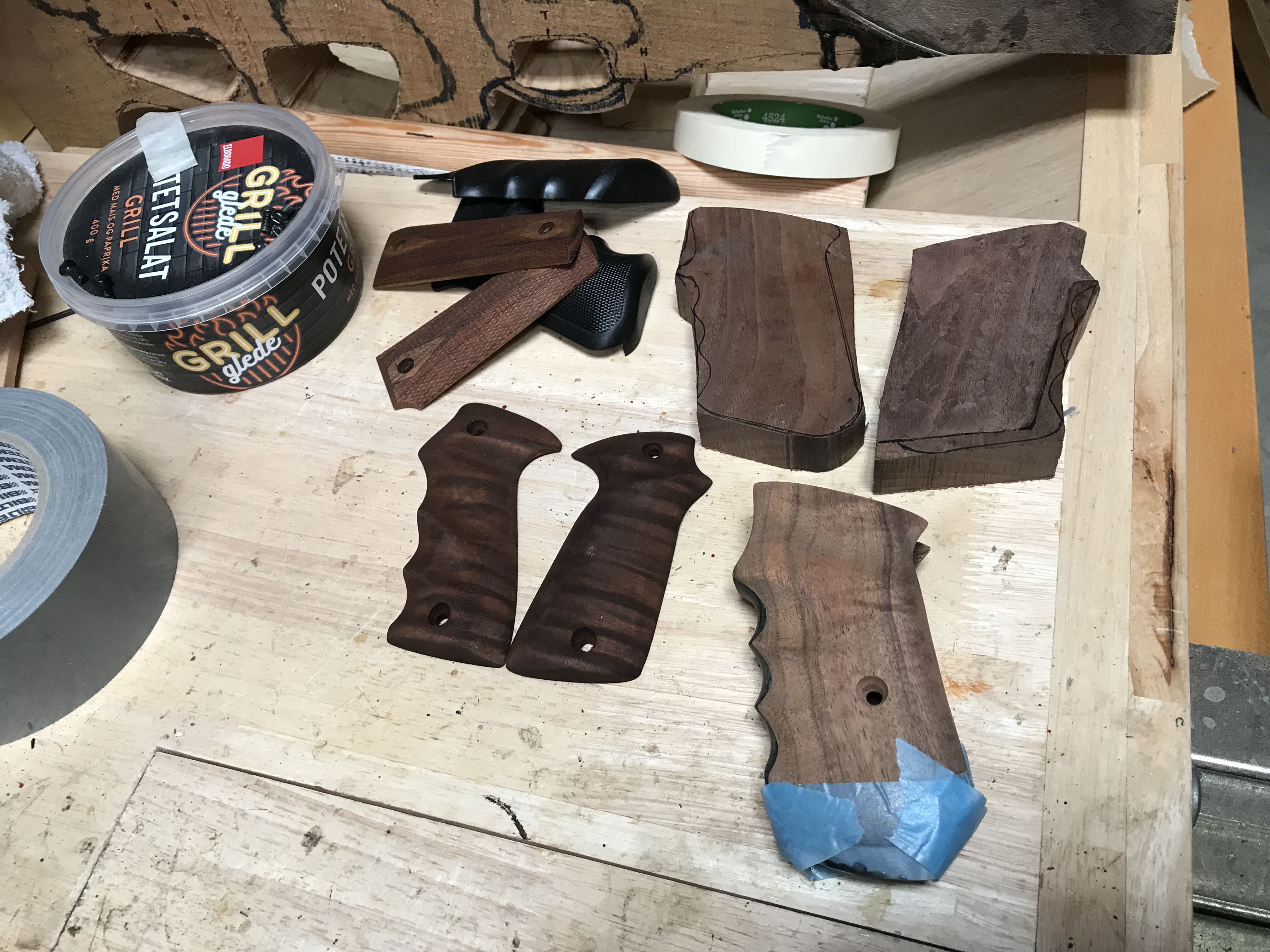

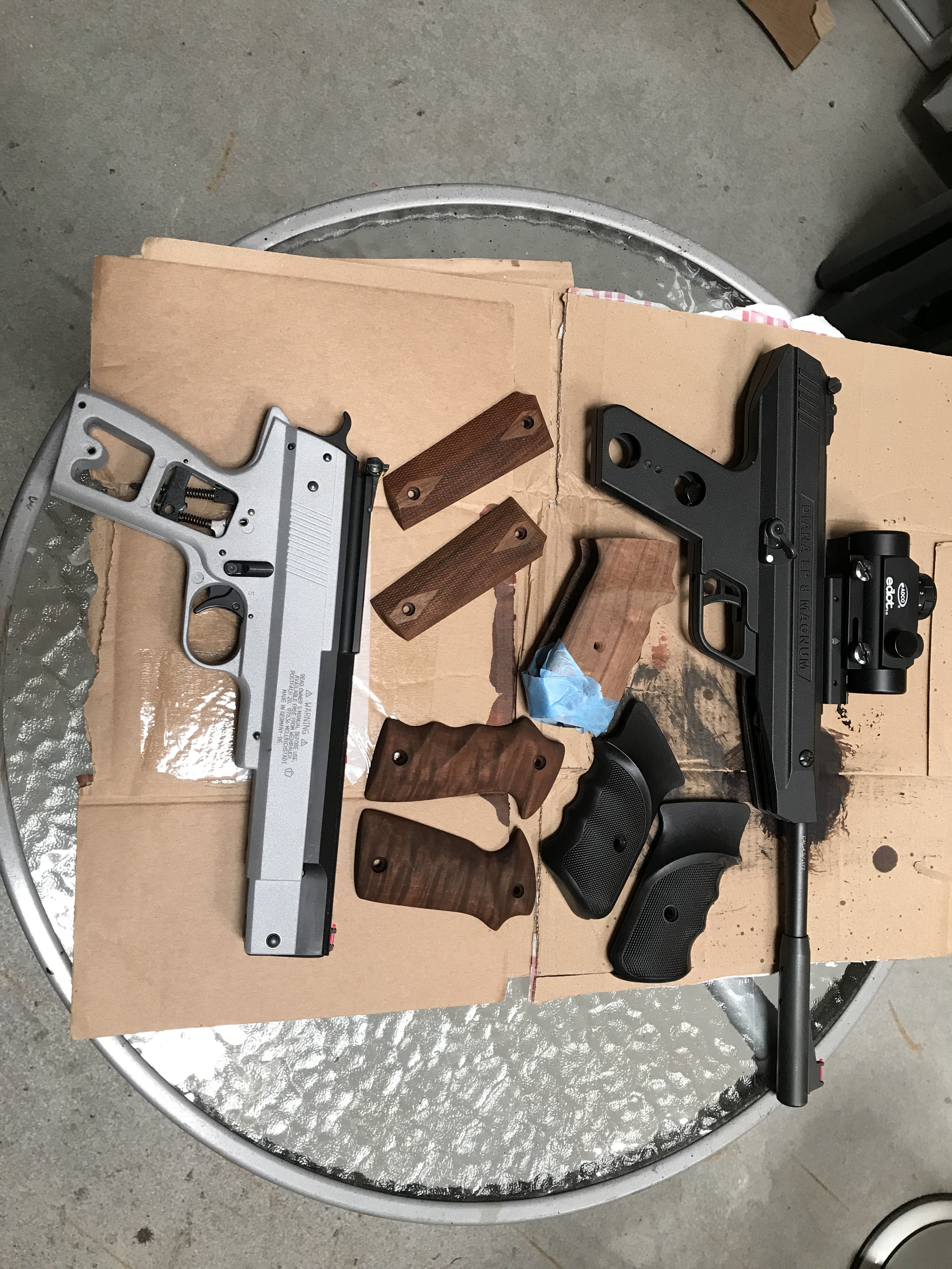

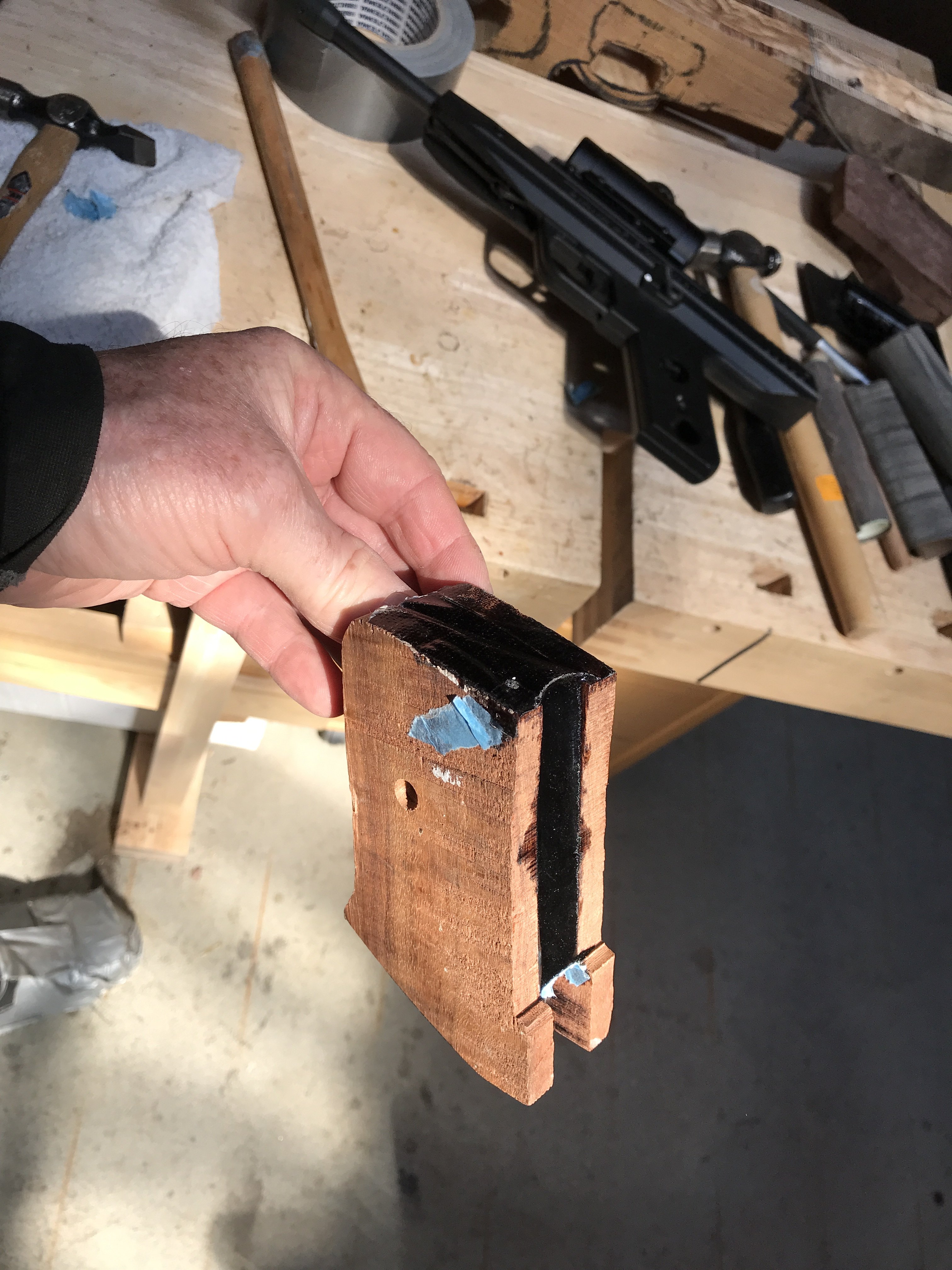

Well Marflow, some of the process are explained here:
(It was made at the same time as the HW45 side panels. Therefore these pictures are a bit confusing, but I think you’ll get it)
First I contoured the piece to fit the outer measures, and then i split the piece in two halves that I hollowed out to fit the pistol tange. I taped the tange and used it as a stopper for the black epoxy. The day after I loosened the shaft and grinded it to fit my hand. Then sanding and polishing. I made two shafts, but the other went west.
