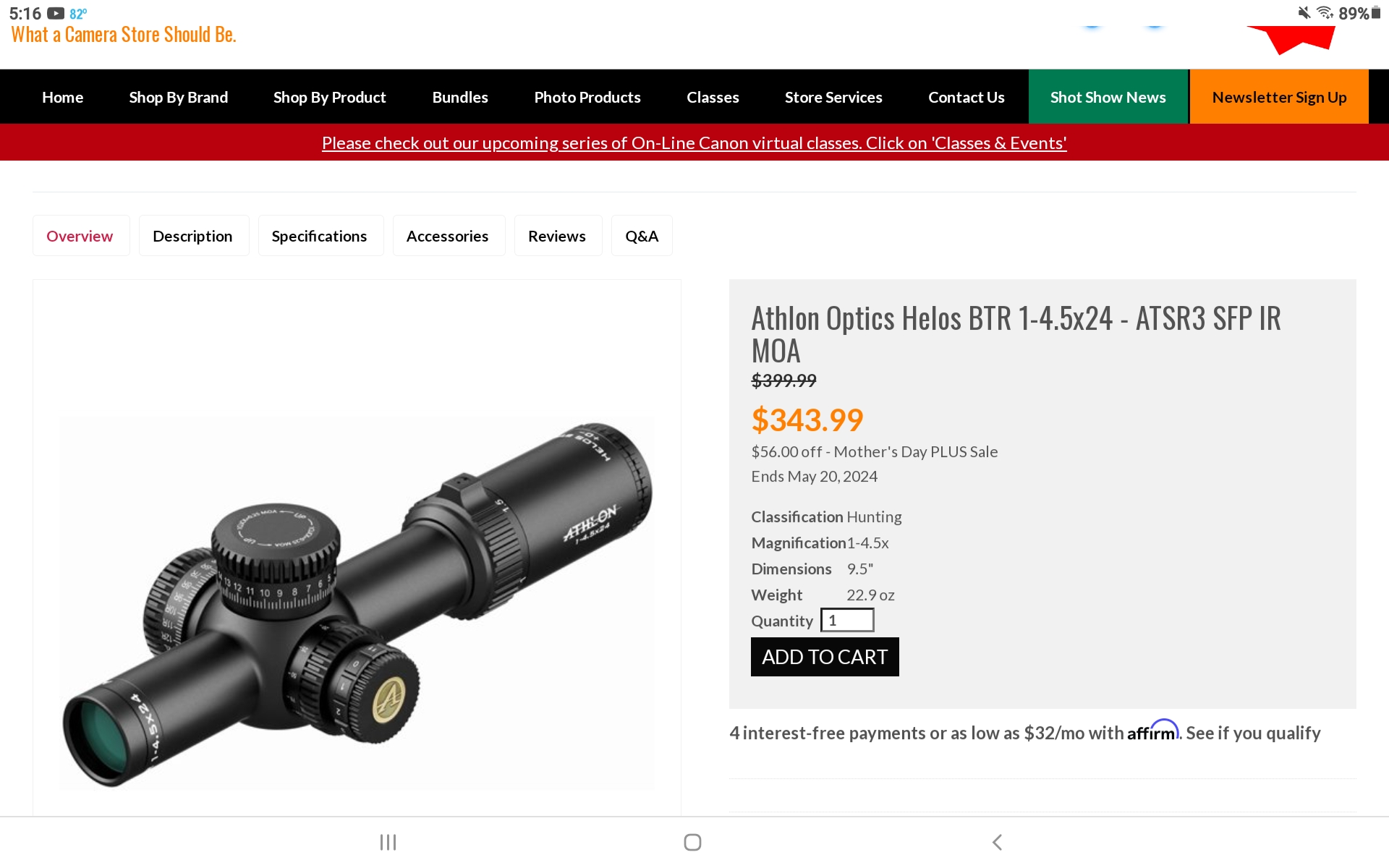

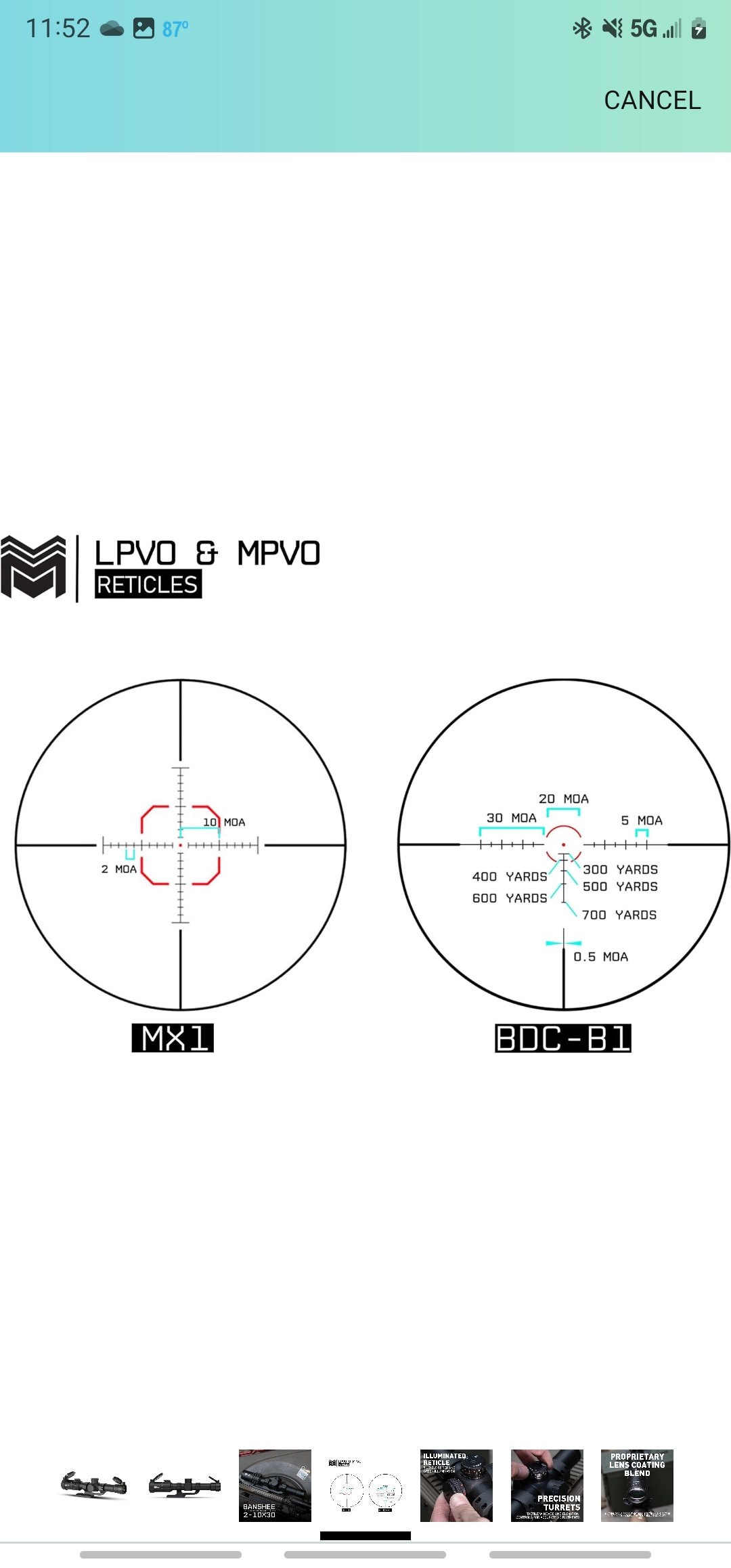

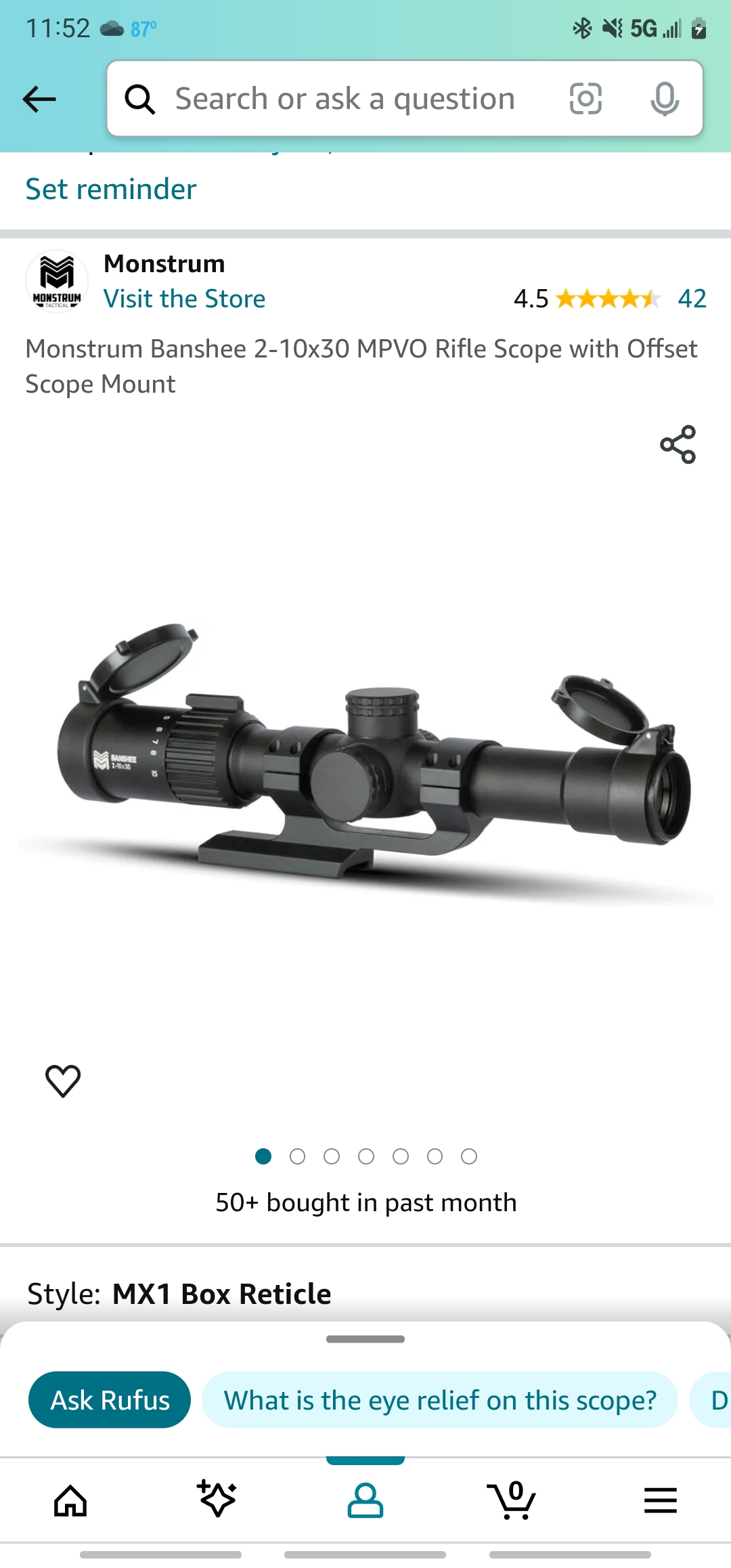

If not then I'd recommend this one.
I picked it up as a consideration for my GK1 as well but I rather have the prism.
It has very clear glass, the reticle is a little on the thick side but it didn't bother me.

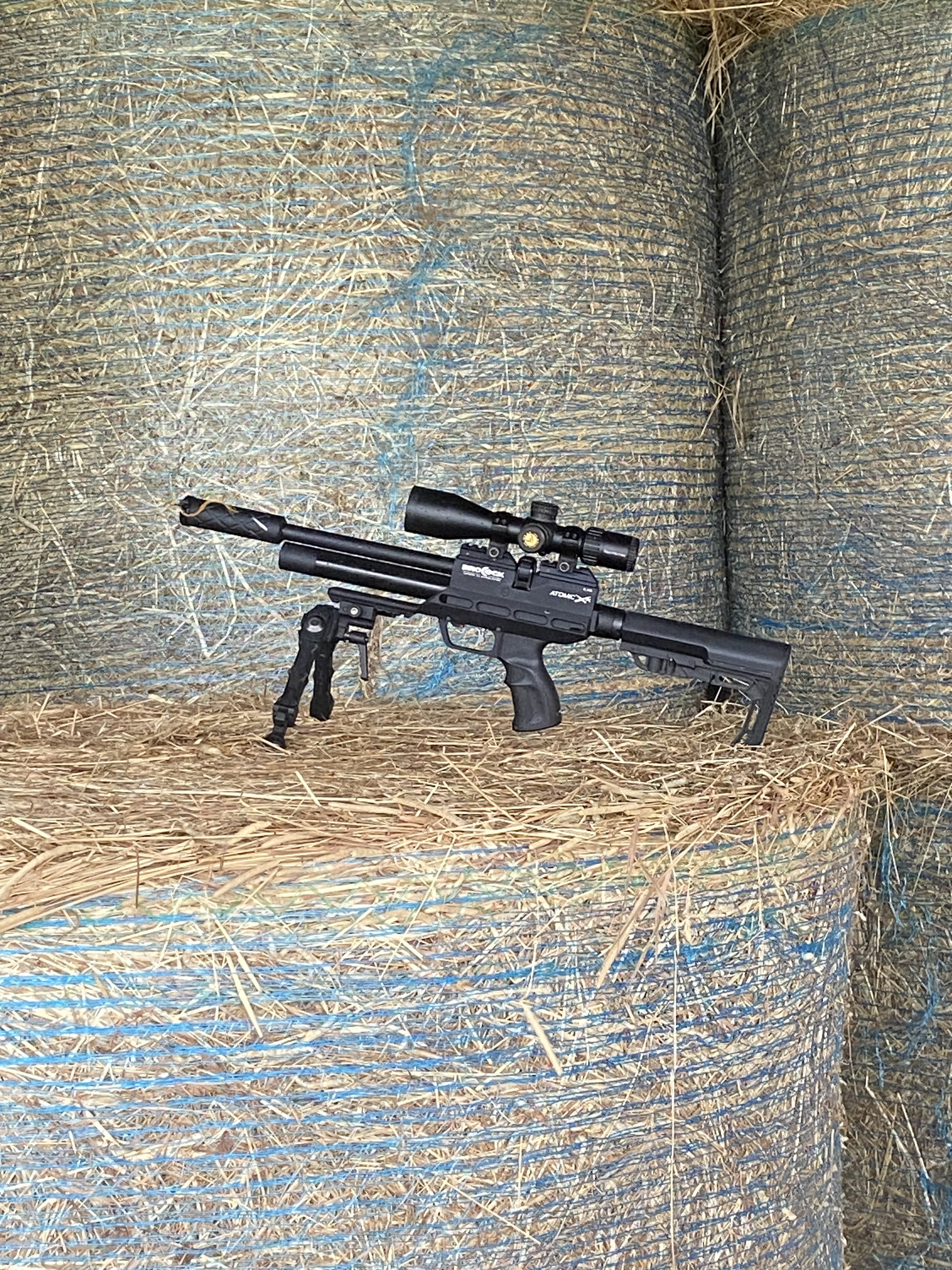

This is the perfect scope for what you described. On sale now at cameraland.
I absolutely love mine I to wanted something more precise than a red dot but with similarly quick target acquisition. THIS IS IT.
Side parallax ( mine focuses downto 12 feet not yards feet , huge field of view, love the reticle for pesting/hunting . Check it out you will not be disappointed.
Don't worry about the 1-4.5 mag it plenty for 60 yards and in pellet gun hunting sfp reticent makes that possible.
