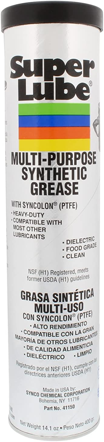

I can't seem to find any good info on lubes for GX CS2 type compressors. I'm not at all concerned about the gear box and connecting rod pin, as these can be lubed with any decent moly grease. I think Redline CV2 red moly, or Molykote G-2008 or similar would work as good as anything you can buy.
My main question is for piston and cylinder lube. What do you recommend for this area? I'm guessing something like Syn Super Lube with PTFE would work, Some other kind of Molykote?

Somthing as This may help choose
This maybe a safe bet

According to BJS here on AGN this is the lube that GX recommended to him for the GX compressor pistons. Enough for many rebuilds / lube services on the GX or similar compressors.
I posted this same information in the other thread started by me on CS3 lubrication.
It looks like there are two factory recommended options for those wanting to get more than one rebuild's worth for $20. Buying 14 ounces at $10 / 10 ccs would cost you $414 not including shipping, so that is not an option. I will go with the 44 cents / 10 ccs rather than $10 + shipping. I am sure I will be rebuilding it several times over the years and can definitely find other uses for the grease as well.
