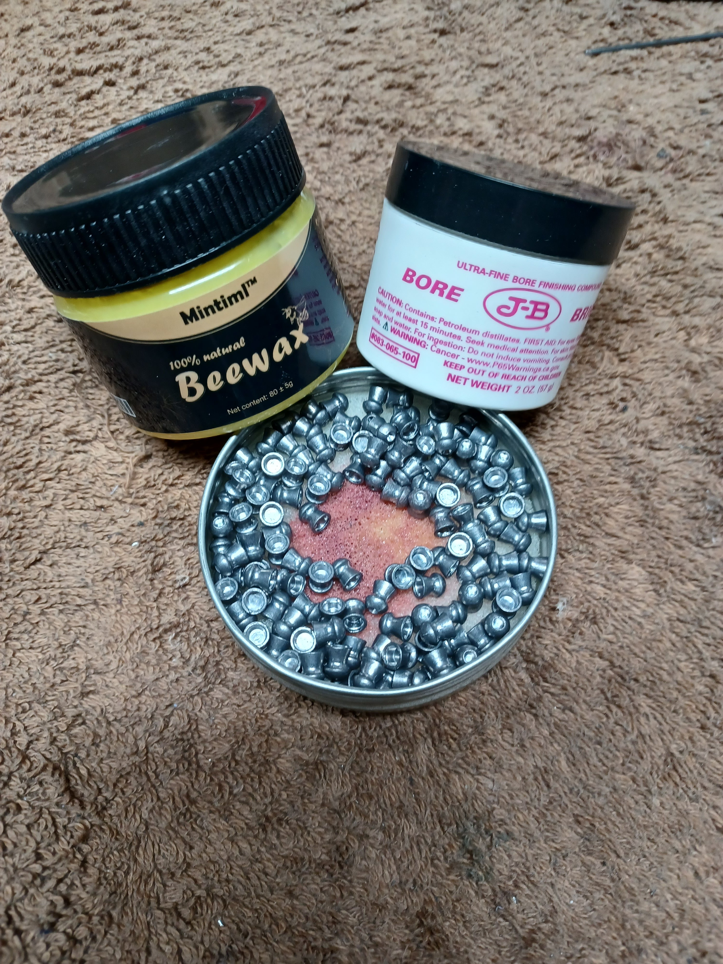

I've experimented for fps and accuracy and it had lttle or no effect, but a couple tins of pellets started to sulfate and turn to powder, so thats what gave me some interest in lube, i put a dab of this lube and a dab of barrel polish on the foam of some pellet tins so that it lubes a little and polishes a little when using that tin, have had no ill effects and gaining slight accuracy, no more powdery pellets.

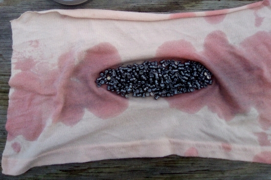

Thing is keeping the inside of the skirt clean of combustible oils or thick stuff that can throw balance off. You get corn cob packed in sid the skirts tumbling you got your hands full of a mess..lol. Anymore i lightly coat a rag and tumble buff to coat just the outside / heads / skirts only..
Just grab the rag at the ends and shoeshine tumble and buff the pellets nice and even.

Right now im using PS/ auto trans fluid typeF . If i think i got too much i just transfer the over lubed to another dryer rag and re buff/ tumble. Mostly when i re wet the rag after several tins it just then needs a small drop . The first time getting the rag oiled / prime is thick too much but you get a feel on just right or add a drop after that as you go. So i use the same oily rag over and over / dedicated..
You can pretty much ise what ever in the rag its getting the rag primed to apply just the right amount . I guess its a experience feel thing you learn doing it a lot.. lol
Like the spray furniture polish. Spray the rag and work it in then add the pellets and tumble buff.
Edit...
I used the word primed but i mean seasoned . So once your lube rag is seasoned right then all it needs is a drop or 2 to keep it freshened as needed ad you go ..
