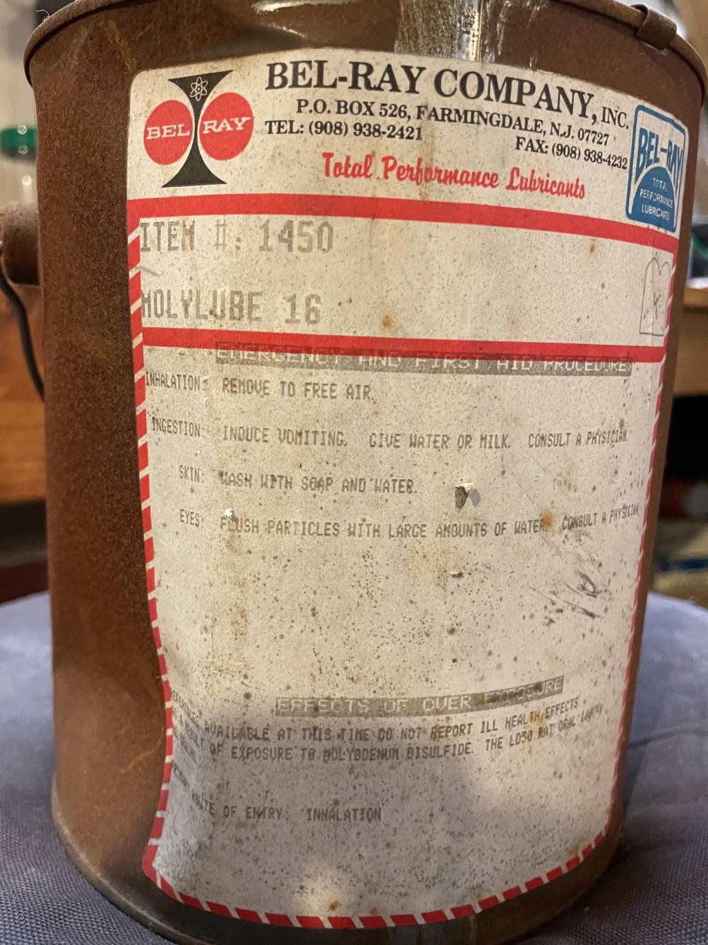

Here’s my take, firstly I do not lube pellet at all! Secondly if you want to lube anything it should be the barrel, “WHAT” yes the barrel.
Molybdenum disulfide or graphite, dry, no carrier or grease. Put on a bore mop and burnished into bore, this will take more than a couple passes a lot of passes back and forth. (If it’s true dry molybdenum you should wear gloves and a respirator) now mind you before you do any of this procedure the barrel has to be free of all lead and I would polish it.
If the barrel has any significant perpendicular machining marks across the barrel which is normally at the leade or crown this will be a big waste of time as will lubing your pellets, the machining marks will strip lead wether it’s the pellets or the bore which is lubricated.
This is why I don’t lube pellets. Lead is a natural lubricant and will fill minute machining marks anyway.
I’ve tried lubing pellet and bores on and off for awhile trying to improve groups! Didn’t work!
True moly! Used in high PSI, High Temp. Applications.
