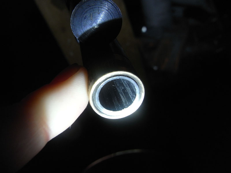

With only one thin coat, even though I used Zombie Green you can barely see any color, but it's was keeping the fouling down and the selected bullets gave the accuracy the gun is capable of. I had coated a bunch of the not 'perfect' bullets too and shot over 200 of them and although there was some slight fouling that I think might have been traces of Hi-Tek, I did not see any leading.
