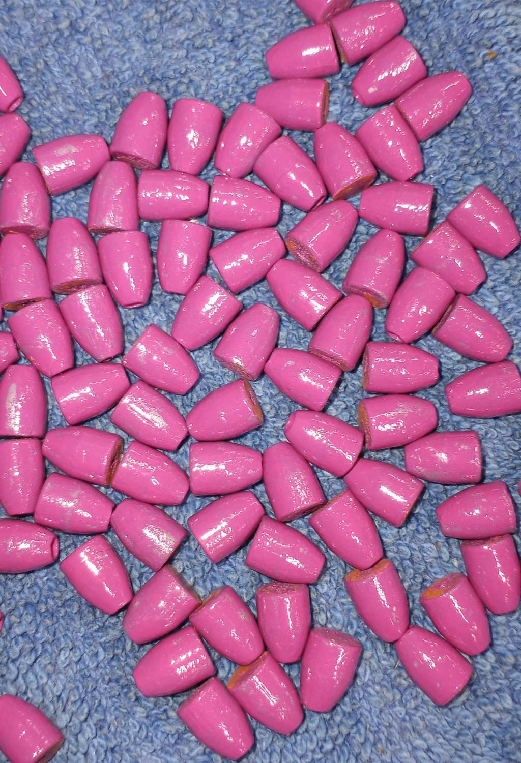

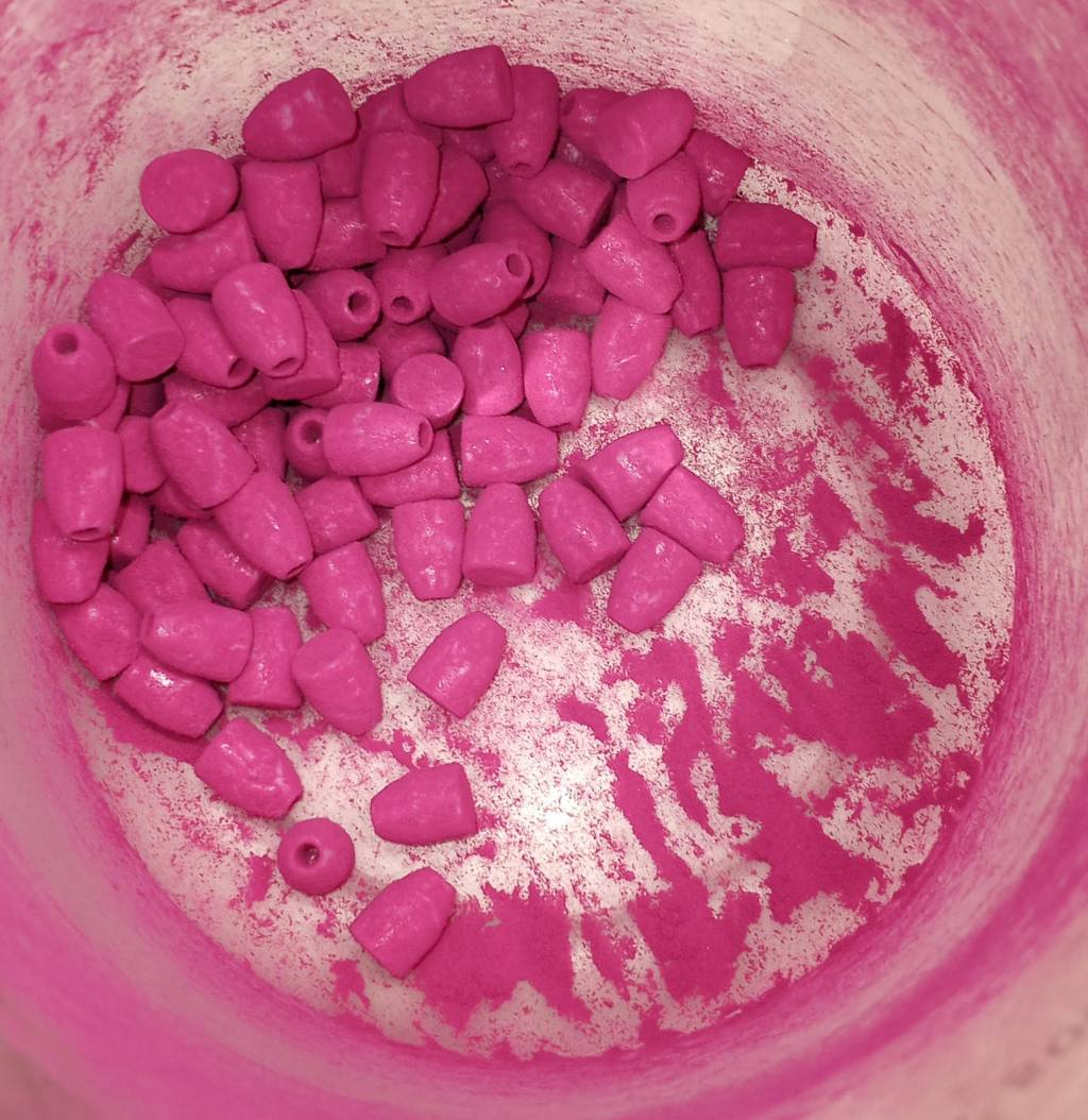

I dont think you have seen powder coated slugs then? Here is a batch I cast, powder coated then sized to .248". EZPZ, and IS exactly; "which is an electrostatic spray coating of plastic powder and then baking in an oven melting the powder." Here they are right out of the oven.

Here is another pic after a different batch has been sized.
