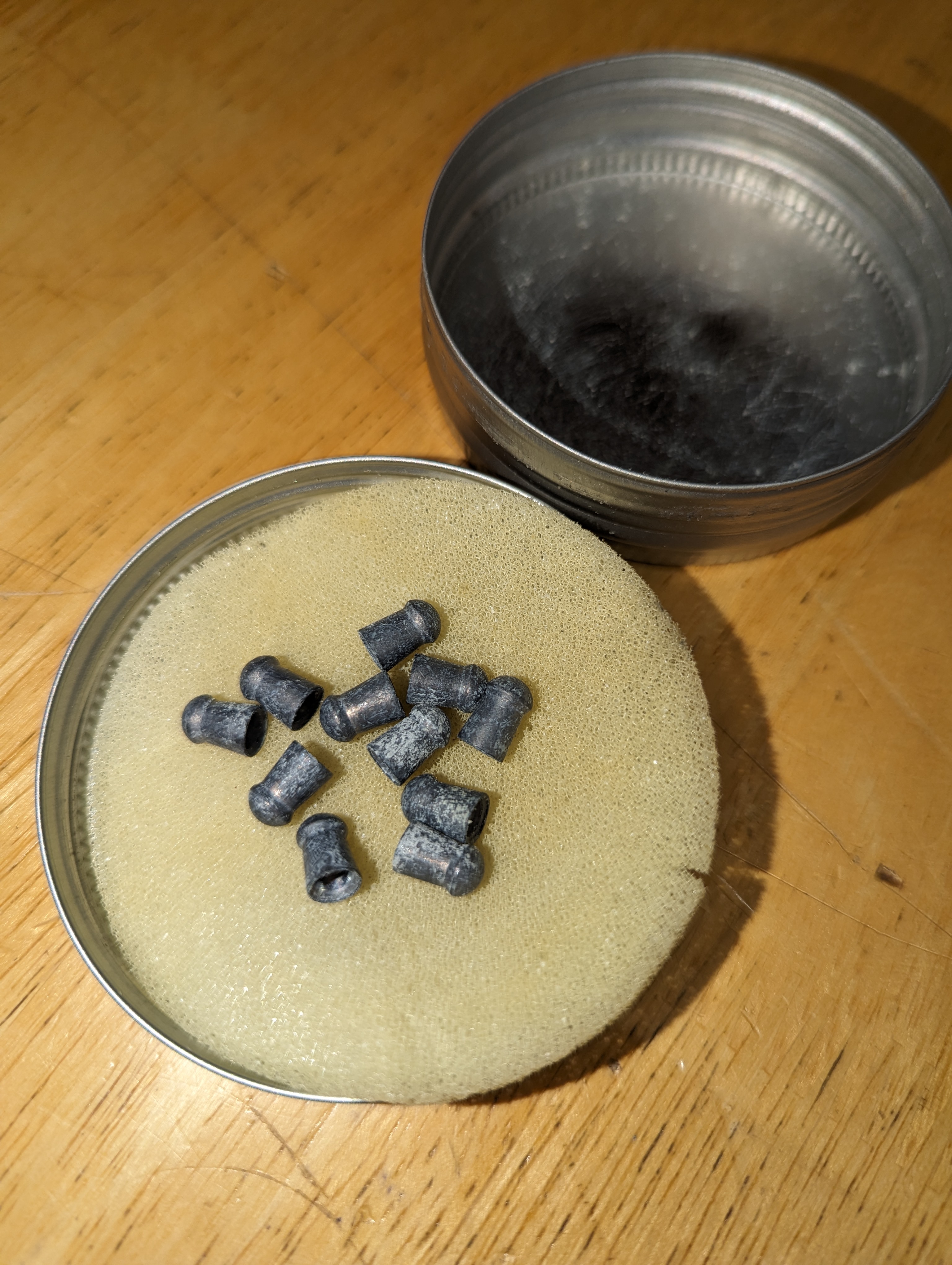

Lubing with Gunzilla
I've had a couple of barrels that benefit from Gunzilla lubed projectiles...
I just found a couple tins I lubed maybe 18 months ago in this state....
Luckily it's only one full tin, and a couple tin remnants like this one.
The carrier in Gunzilla seems to have gassed off, leaving the solids. This looks like oxidation but isn't, as it can be wiped off easily. It's almost like a toothpaste consistency.
I was warned of this but hadn't yet encountered it myself.
I'll still use the Gunzilla as a lube and especially as a barrel cleaner, but will be more careful not to get too far ahead of my active consumption with lubed projectiles.

The evaporation of the carrier in Gunzilla may be related to the typically low humidity here in AZ. So I'm not sure t'll be a problem everywhere. But yes, I shared to maybe prevent a fellow airgunner from needing to wash the creamy residue off of some pellets to revive them like I'll need to do with these.
I'm mighty glad I didn't prelube the other 11 tins of this batch!

I found an old tin several years ago that looked just like tat but X 10.. Love the stuff but unless it's air tight it does that right there.

I think that it is just the wax solids and not oxidation or corrosion. I suspect (but could be wrong) that they would shoot just fine.
100% agree on the wax solids. As I stated, it rubs off, think cream or toothpaste consistency.
I'm not willing to shoot them as-is. For a couple reasons, this stuff is more tenacious than the liquid form of Gunzilla. I don't really want to gum up the barrel with the solids. And it may not even gum up the barrel, but just thinking g that it might would mess with my confidence in the barrel and gun. Maybe just superstitious. Also, it looks like it attached itself unevenly, maybe imparting imbalance? I'm envisioning the process that created this mess as a little microenvironment inside the tin-like making rock candy. The Gunzilla solvents gassed off, likely taking some of the rest of the ingredients into the air inside the tin, then it somewhat crystallized back out of the air (not crystals but similar process) kinda attaching itself in varying degrees to the best "seeded" areas of the pellets.
All in all, not something I want to shoot through my barrel now that it's not the same composition as what it used to be.

Gunzilla is good stuff, just don't want to get too far ahead on lubing. Or you end up with a mess.
So, you treat the barrel with it. The barrel must look like this after a nonspecific amount of time. Also tooth paste is gritty. Is this stuff gritty feeling?
Between frequent pull through and less frequent patches on a rod, it never sits in my barrel as long as these tins sat. Looking through the barrels when off the gun has not shown the residue/gunk/buildup like shown on the pellets in the first post here.
No, not gritty, perhaps toothpaste is a bad example. Just the consistency of toothpaste, like a cream.
