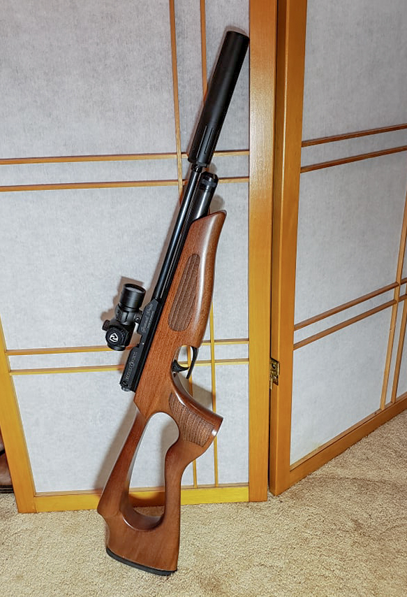

Hello I have done, and still do a lot of shooting with a red and this has been my experience: with a 2 moa dot on a PB with a little work on my part I can hold a 1.5 moa group at 100yd and just under an inch at 50 this is achieved with AR platforms in both 5.56 @50 and 308 @100. As for airguns several of my guns have red dots Ataman ap16 just under an inch at 25 yds, Air Arms t200 ( chipmunk gun for the 10 yd bird feeder ragged hole @10 yds) and LCS19 22cal ragged hole at 25 yds. A 2 moa dot covers 1 inch at 50yds and 1/2 inch at 25yds. With a little practice with the red dot it should be no problem, just remember focus on the target and let the dot superimposed itself ( thats what I have found works best for me with both speed and accuracy). As for the 1-4 you just bought that should be fine and giving you the best of both worlds , just make sure that when you mount the optic that on 1x when the gun hits your cheek you don't have to hunt for the reticle (its right there and your ready to fire, as you got up in magnification you will be taking more time to aim and therefor will have the time to adjust the gun) Well I hope this helps and any questions just ask, also good luck with you hunting Eric

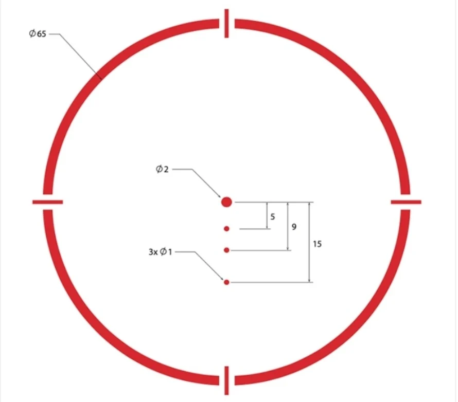

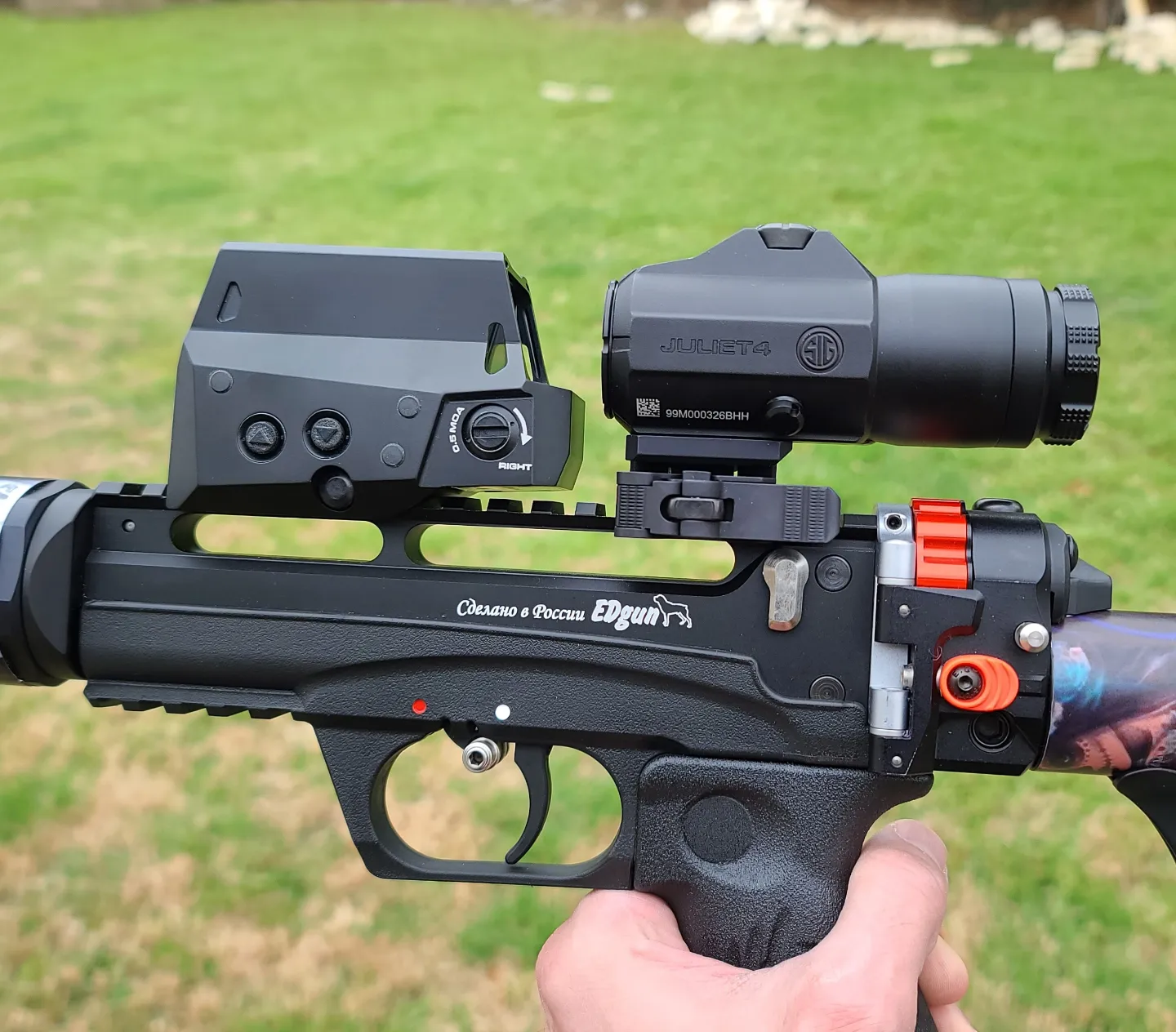

I have some experience with both. The challenge with a red-dot is that unless you have multiple dots, its difficult to determine the proper holdover. I have trouble shooting anything small past 20 yards with a single 1x red-dot. Now a red-dot with multiple dots and a magnifier is a different story! But the cost is nothing to scoff at.

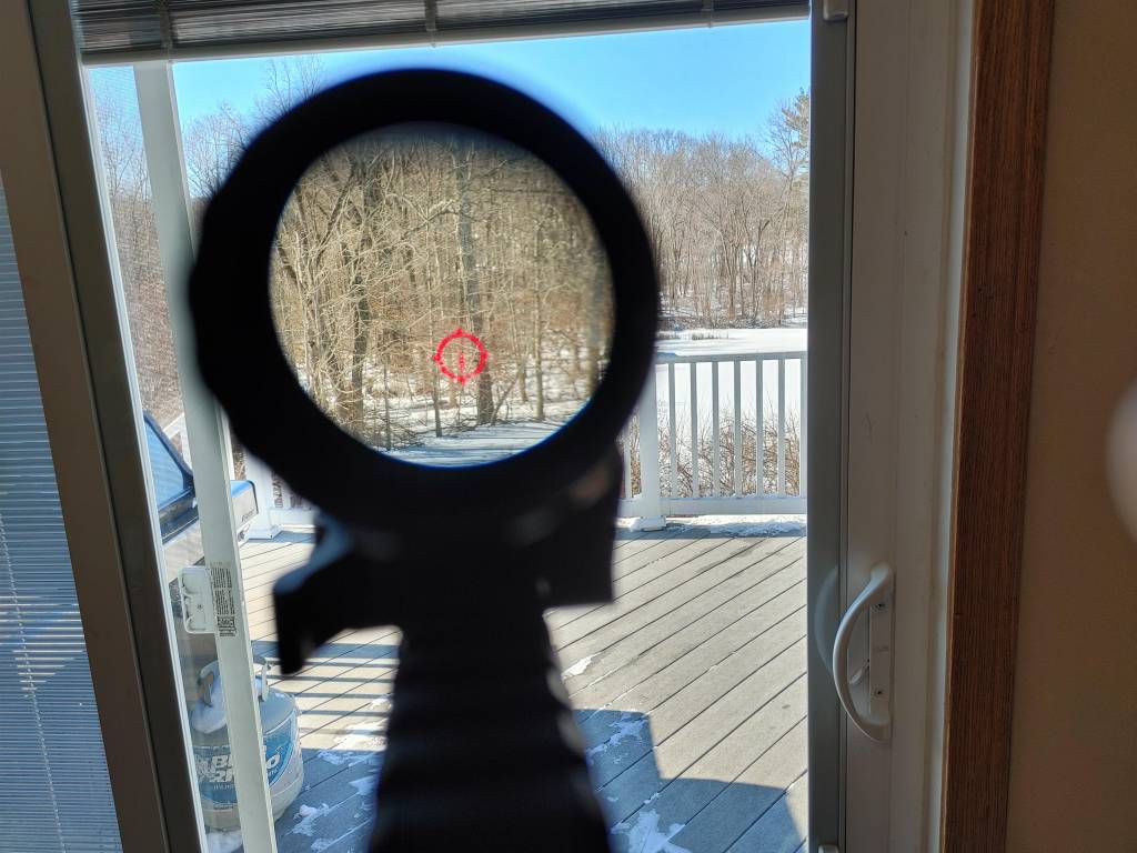

Another option might be a 3x red-dot with a holdover reticle like this https://www.edgunwest.com/store/optics/delta-optical/item/hornet-3x-prismatic-sight/

My magnifier is 4x and for me that's good to +/- 50y. LPVO's are certainly more accurate.

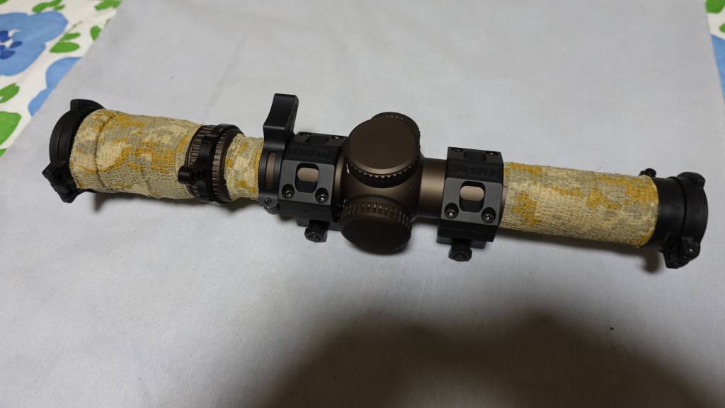

Now me my self I love LVPO much better as you can really streach out the shots and precision is much better , I used to run 5 or 6 of the lvpos , Bushnell 1-6 , swfa 1x6 hd , trijicon 1-8 accu-power and my newest one I use now is called a vortex razor 1-10 , now again these were built for mid range out to say 800 yds with 308 or ar , but great for pcp guns , While the razor3 has no parallax adjustment with good glass and design it is fine in close range you get crystal clear images , however this optic went up like 140% with MSRP isince I got it , The reticle is well thought out and has a great tree type reticle good for quick follow up shots , great in low light and even magnifaction is superb compared to other ones I have tried , and Vortex is great if they ever need service ,a good company. and weighs only 21 ounces and has a 34mm tube ,
