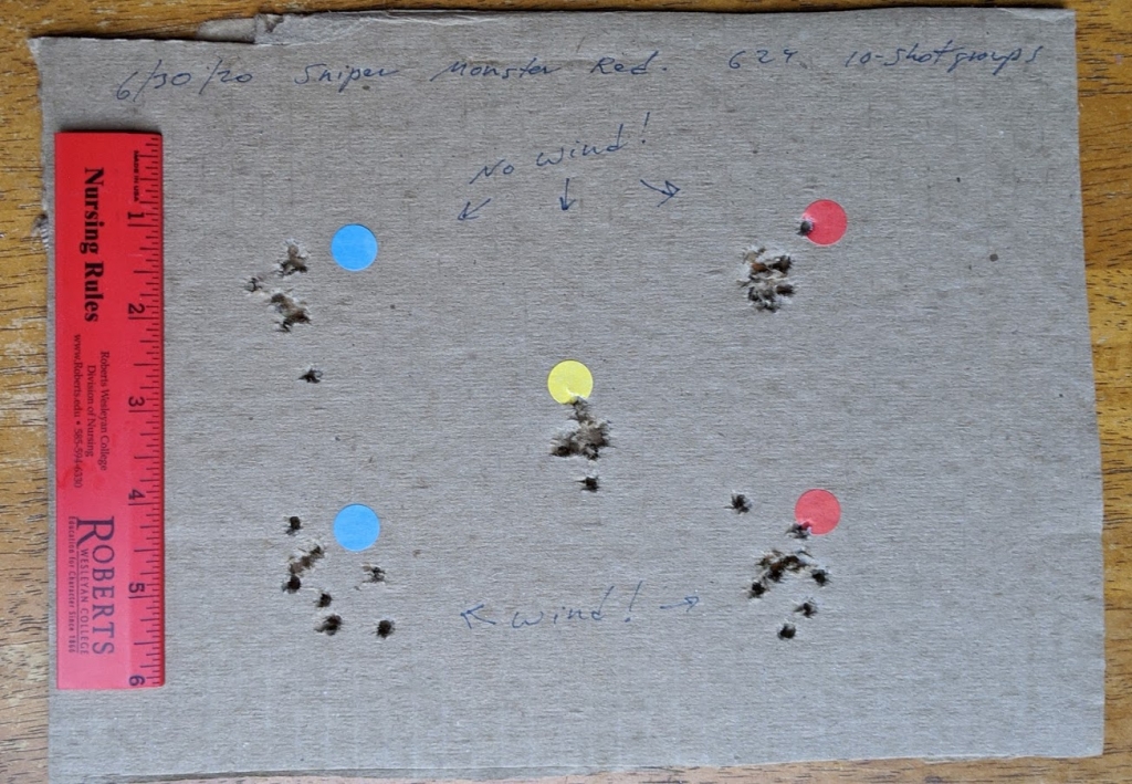

Hi @elh0102, thanks for your advice! Here's a quick update after a good cleaning. (no JB Paste yet) I definitely think this barrel show potential. Here are 5 10-shot groups at 62 yards. The top 3 were essentially shot during a period of dead-calm. The bottom two were affected by wind. I did finally get around to ordering a Patchworm kit. We'll see if that's able to pull out any fresh gunk from the barrel 👍
Nothing wrong with those groups at 62 yards
Thanks @Motorhead. FWIW, the gun developed a leak at the firing valve and being under warranty I shipped it to AoA. They fixed the leak and replaced the barrel. As you saw above the original barrel did perform well but required cleaning about every other fill. When cleaned I pulled out very large slivers of lead buildup. The new barrel is just as good but goes much longer in between cleanings.

Both this and the original barrel shoot the .22 Monster Redesigned well on high and (ironically) CPHP well on low. How's that for an odd combination? It still hates most other JSBs. I do like the fact that when I clean the new barrel I get very little lead flakes out. It's nothing like the 1st barrel in this regard!
