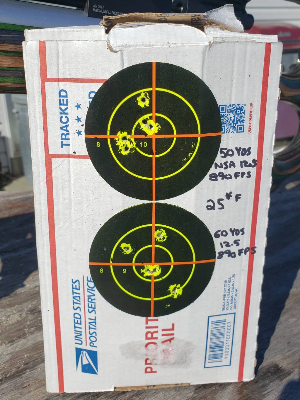

Readers digest: regulator @128'ish, hammer spring dialed up just one turn, 905fps with the 12.5's. I did go out into the back yard and quick tested at 25 and 50 yards and ... looks promising. ;-) Weather supposed to be better later in the week ... I'll play / test with it more then.

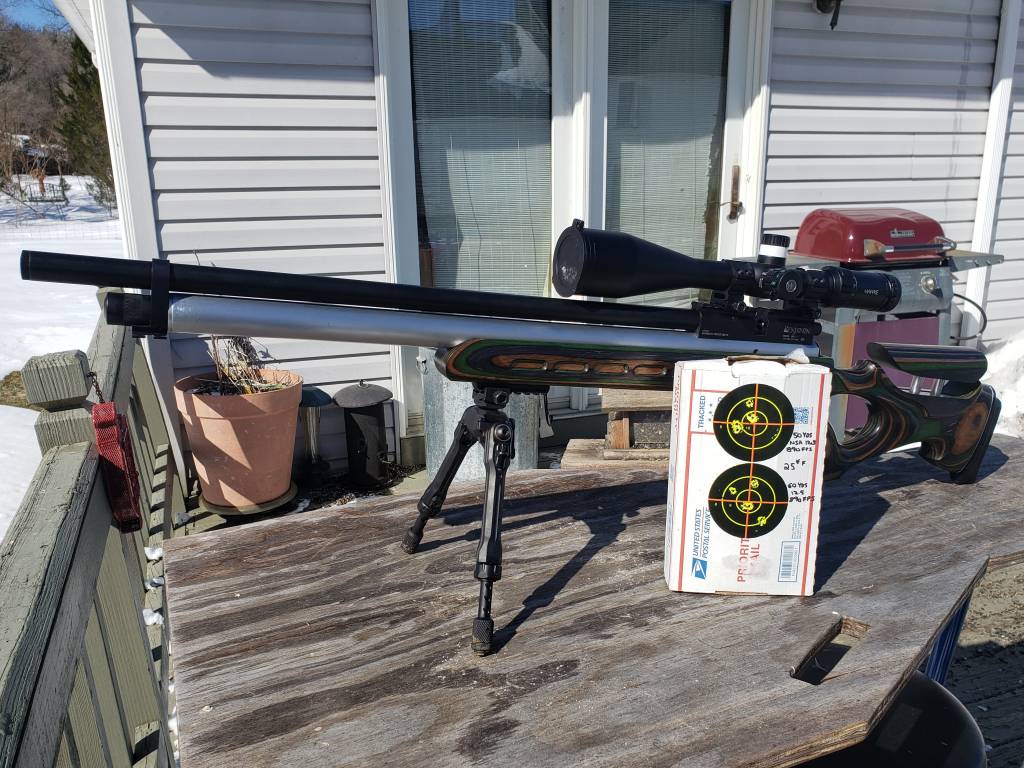

Previous post was Saturday the 6th and what was going to be a simple test to see how fast they would have gone @the previous tune turned into a rebuild due to an apparently bad / leaky o-ring. Anyway -- it held air overnight so guessing the leak issue is resolved. It seems to be topping out @905fps and while yesterdays shots weren't bad - they weren't spectacular either. As I can't get it to go any faster and not wanting to dissemble it again - degassing and pulling the reg up / upping it to 130 (or more?) - I figured I'll start ~slowing~ it down a little and see what happens as that is something I can do with it right now. I backed it off to 890. It was at 905 yesterday.

It's a nicer *looking* day out - clear and sunny - but still cold and a bit of a swirling breeze - mid-20's temperature. I know - these ain't great and could certainly be better - I think there is potential here for this little gun and these slugs. I'm going to buy a box of 'em - I've still go 50'ish left of the samples to play with - but based on the very little play I've had with them so far - I think I can get 'em dialed up and shooting pretty consistently and accurately. With any luck I'll find a happy speed @less than 900 and I can be "lazy" (lol) and not have to fiddle with it. Who knows - I may have the throttle it up on the reg and get it above the low 900's . . . we'll see. Supposedly temps going to be in the upper 50's - possibly even hitting 60 later on this week. Fingers crossed.
