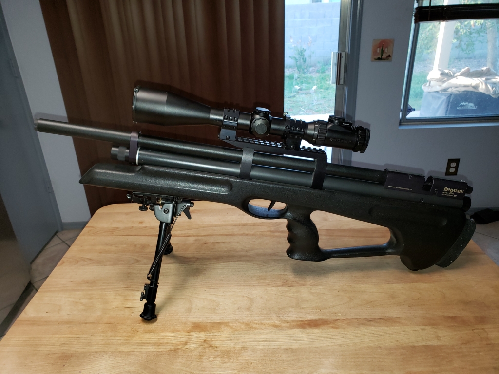

Actually in my opinion the above pictured MDRL Bullpup is the best upgrade you can do for really balancing the stock front heavy Marauder! It does cost a fair amount though (I have 3) lol. Another fine upgrade is a balanced valve from JSAR but it works best without a regulator.
Once I felt the difference when I shouldered the M-rod after doing the bullpup conversion I was totally sold on bullpups. Yes it is a costly upgrade but was totally worth it in my opinion.

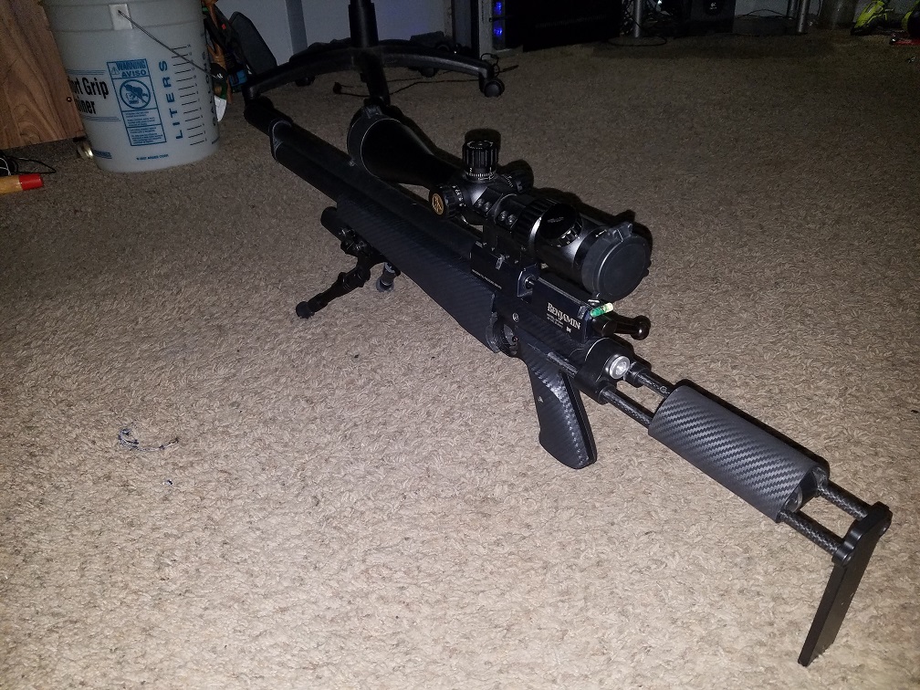

I run mine with a prod trigger group (moves trigger forward around 2"), along with a re-worked stock valve (.23" valve exit, .24" throat, .05" poppet stem in throat (made from hss blank), .28" poppet OD, a 48 gr MDS hammer, a custom version DIY SSG with 7.7 lb spring, custom aluminum reservoir tube made my Lee545, collapsible butt stock, custom collapsible LDC, custom rear adapter to allow swapping of SSG's with locked in tunes. A custom external plenum extension that adds 33 cc's to the existing 20 cc's without losing volume on the HPA side. At a regulated 1950~ psi I can make up to 60 fpe, and I can detune it down to 12-18 fpe in seconds. Cheek riser holds 3 magazines underneath. Gun weighs 5.2~ lbs undressed. You'd think the rifle was a money pit but I did a lot of the work myself. A valve from crossman is only 20$~, and I find it quite gratifying to do work myself, I went through 3 valves before I got it right but that still cost me roughly 70$, which was a good learning experience, resulting in a cheaper, and IMO superior valve than after market.
So the better question may be, M-rod - Upgrades - Where do they end? ;)
-Matt
