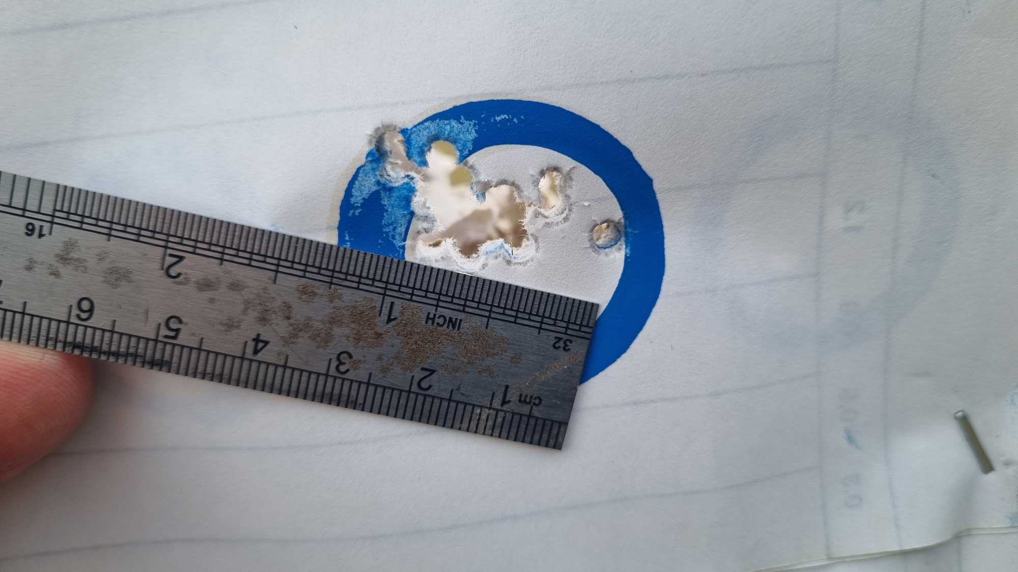

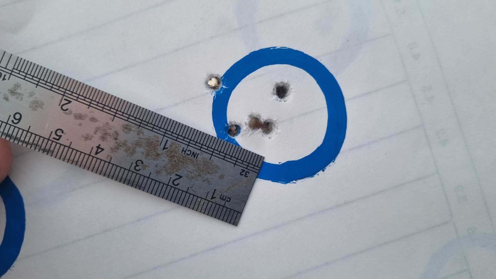

FX M3 @ 1100fps Results might surprise you !!!

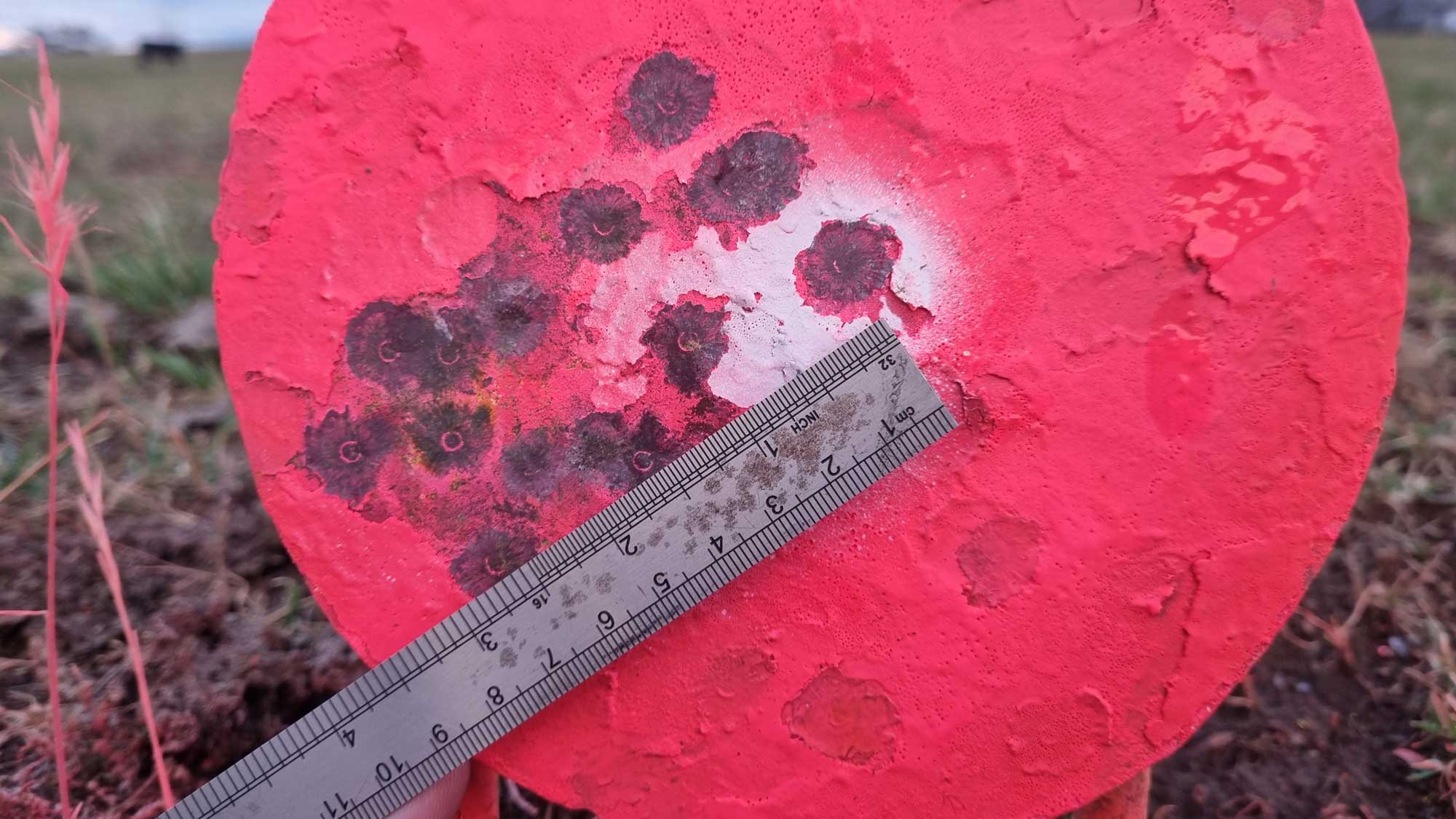

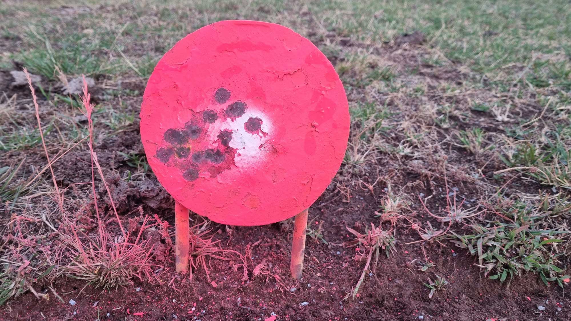

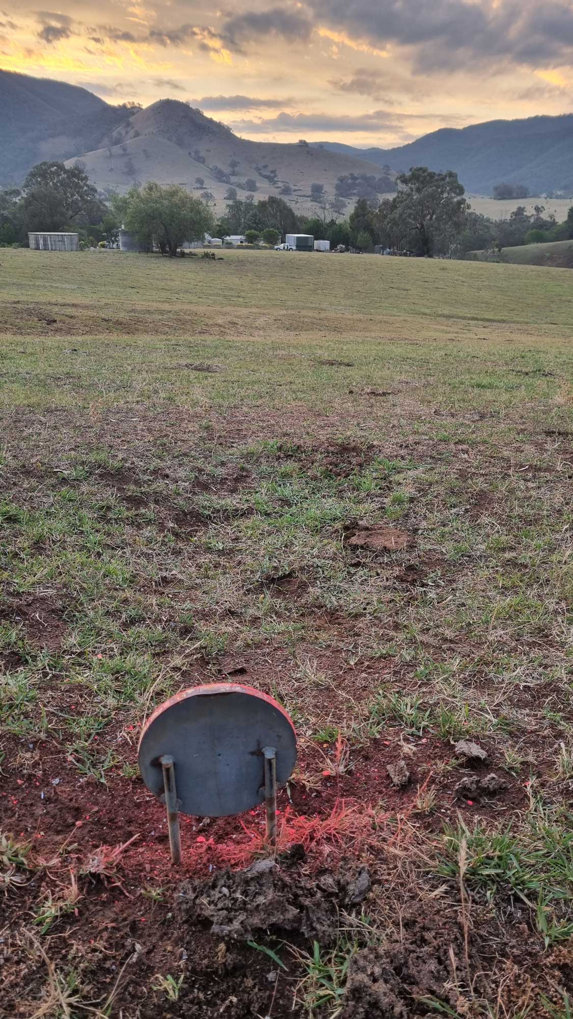

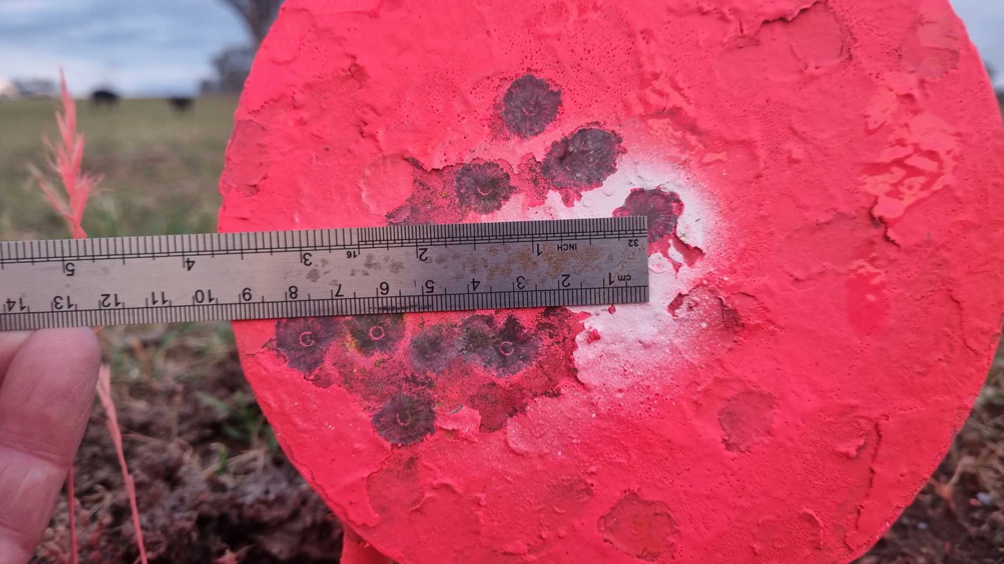

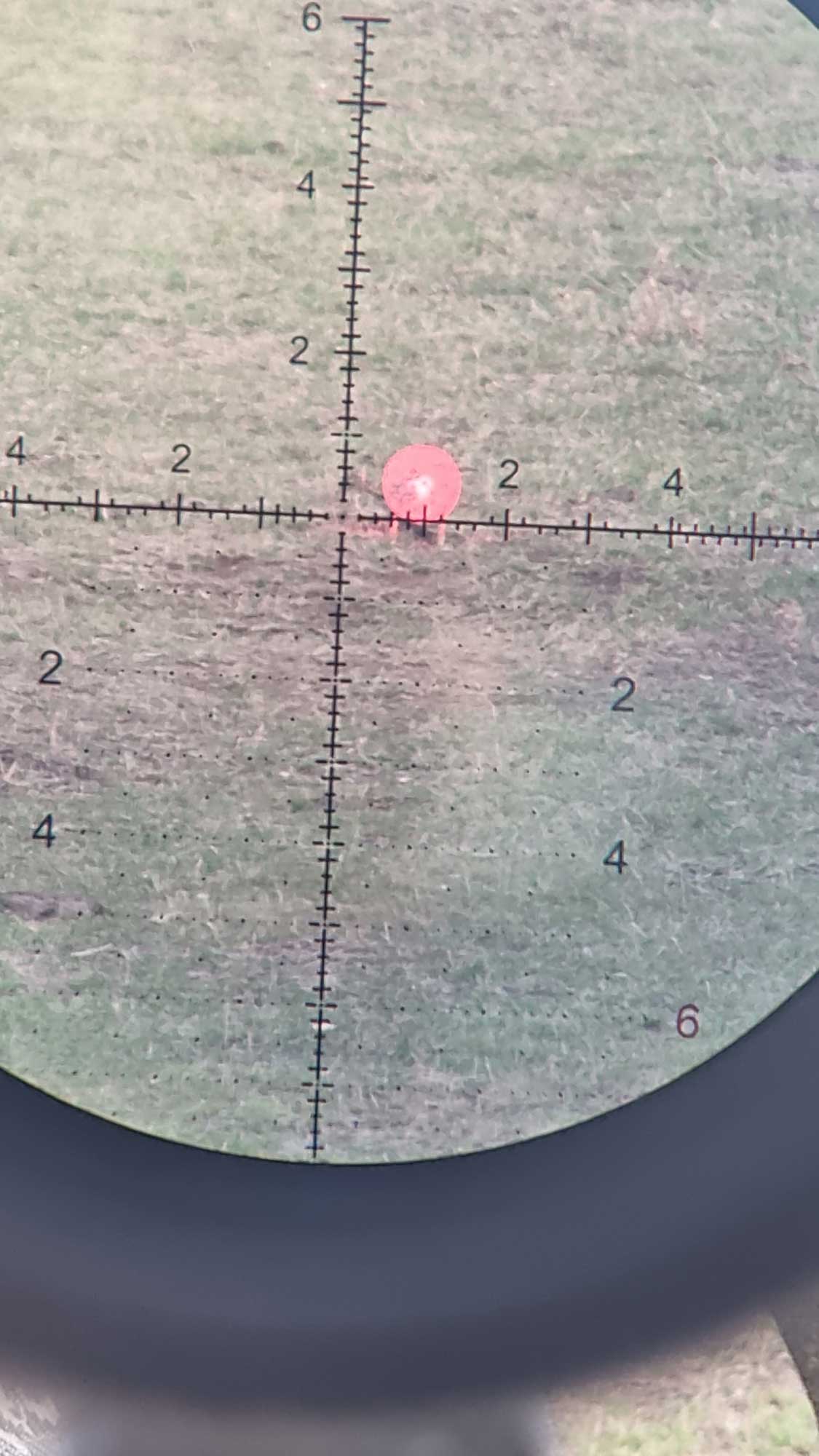

More this evening.... 350yds ... very small gentle breeze..
My stuff up.... dope was a little low.... :( group fell in lower plate section with some hitting the legs and a couple in between. The majority was spread over 5 - 6 inches ....one "flyer" up on top plate edge..
Sooo... majority went 1 1/2 to 1 3/4 moa still quite reasonable ( and consistent) at this distance..
