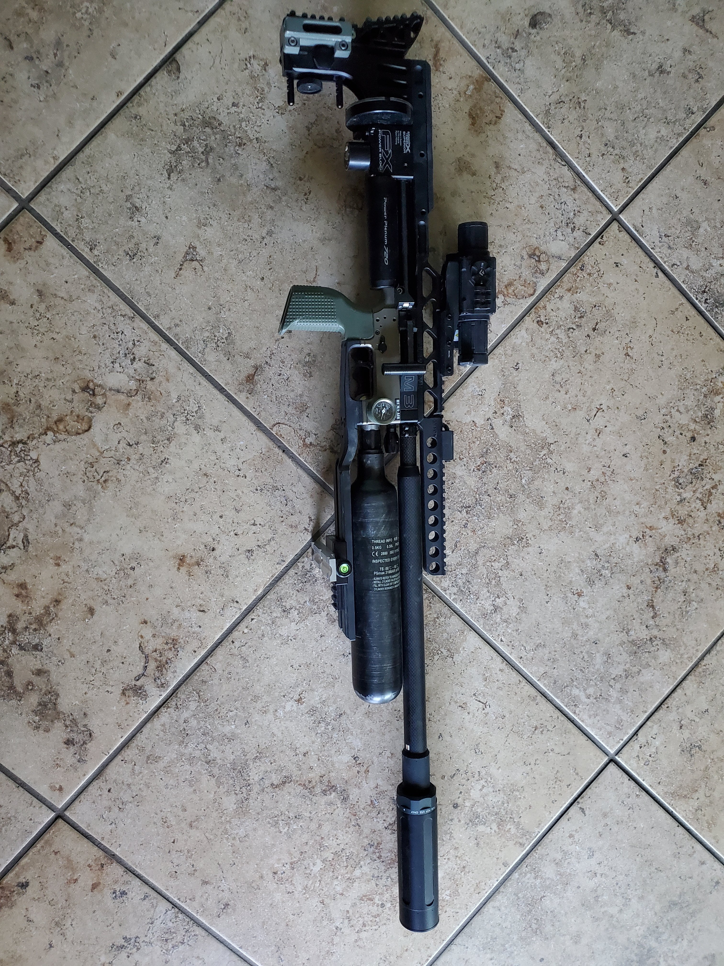

do you tune with harmonic balencer or do you use it just for supression on barrel tenisoner , I think that is what you are saying about ring you made, can you show me where how it is on gun...but dont do that if it opens up for re-tune, messing with it causes re-tune I got that...man thanks for chatting and helping....I live In Arkansas , but was born and raised in San Joaquin valley Hanford Ca
I do use the balancer to bring groups in tighter, and the shroud helps quiet it. If your tune is pretty good now there won't be a need for a retune but you may have to re zero after the poi change. I don't have a ton of pictures but basically make the hole in the back of the shroud big enough to go over the tensioner with an oring or 2 in it. You need a lathe or somebody who has one.
