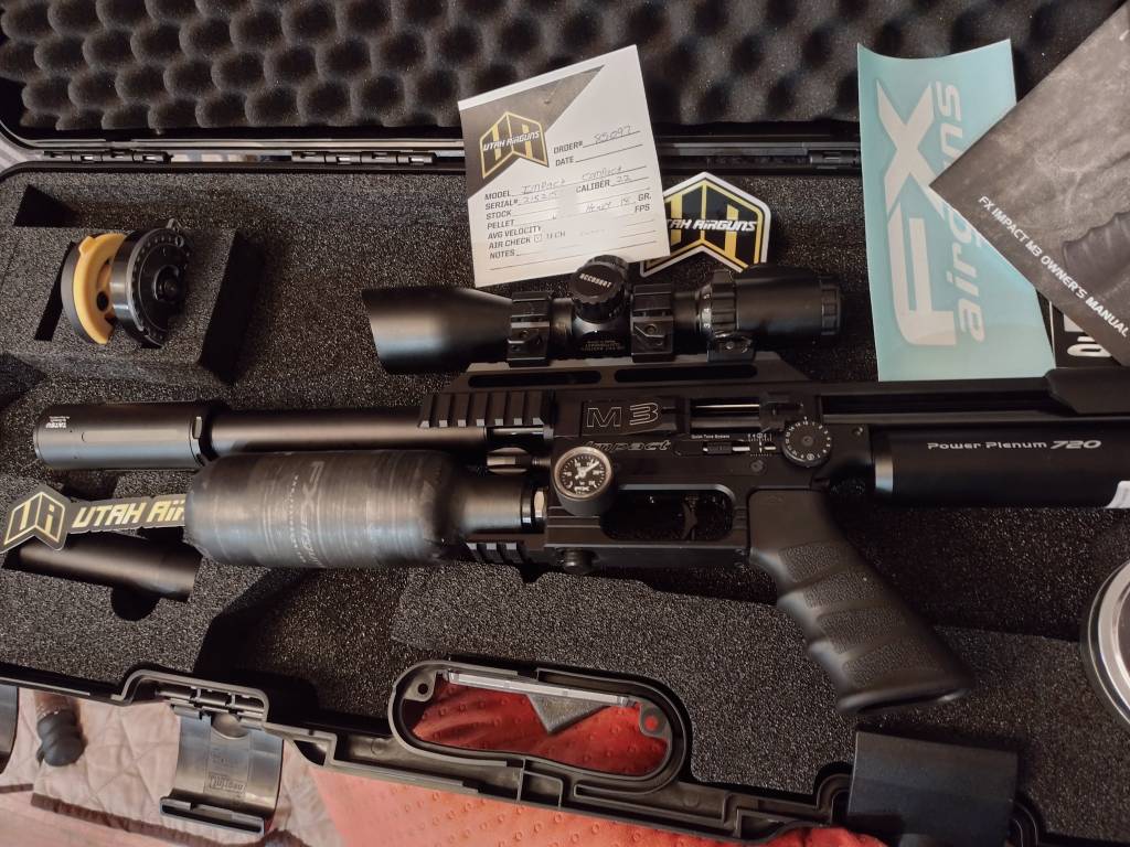

Tuning M3 compact.22
Shooting 18gr @910 1st reg 170 2nd reg 97
Quick tune 3
power wheel 16
Four line out on vaule adjuster!
Is this a efficiency tune? Or could you guys suggest something better? I was thinking lower speed for higher shot count for sure. This thing sounds hot atm! Let me say its a laser atm!
I wouldn't worry about the delta between regs right now. That should be fine. If it is loud, though, that suggests it is not efficient. Valve may still be open around the time the projectile leaves the barrel.
How far below max speed are you at that reg pressure? The simplest tune you can do for a regulated PCP is to find the max speed at a given reg pressure and set your speed to 95-97% of that. You may find good accuracy even below 95% and it will be even quieter, however depending on the gun you may see more shot to shot deviation.
