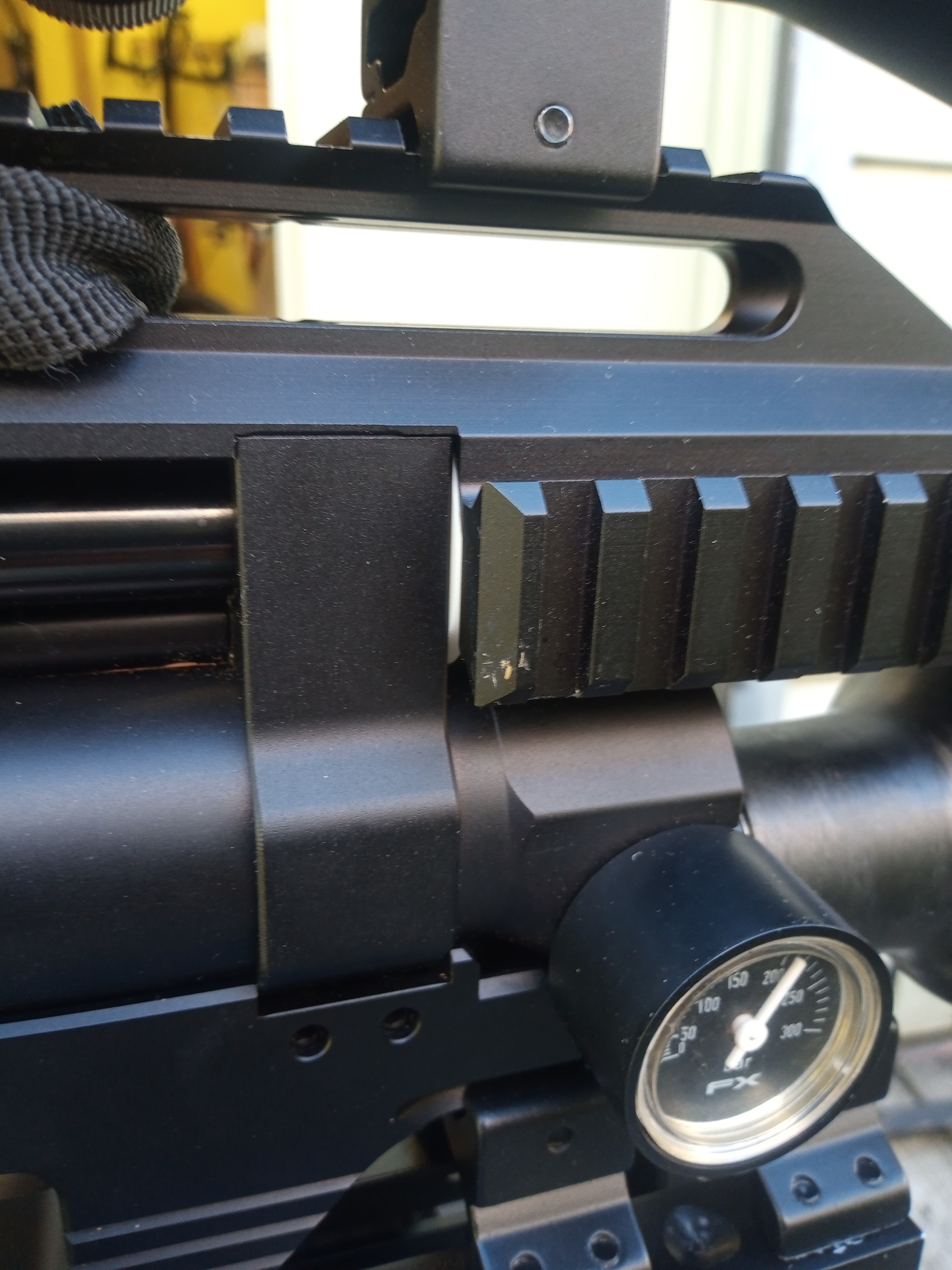

No problem
First bit is easy..
Starting with the FX liner and original steel barrel tube, Bond the FX carbon stiffener to the liner . Bond the liner and stiffener to the barrel tube. Bond the SS barrel nut to the barrel tube.
This is done with Loctite 680.
Machined a piece of 7075 seamless Aluminium tube to fit over the steel barrel tube. .005" clearance. This is then bonded using the Loctite 680. A carbon outer tube is then press fit over the aluminium tube .
I machined a replacement front receiver "clamping" block that has a extended cylindrical section that goes over a small step on the carbon tube. This is indexed and permanently bonded.
To remove the barrel assembly i undo the 2 cap screws through the forward barrel clamp and receiver .
Effectively the whole assembly is a complete bonded unit...its VERY stiff.
Since doing this mod i have had very consistent accuracy and POI..
The standard FX liner is obviously very accurate, but there is just to much flexibility in the original setup.

First bit is easy..
The harmonic problem of POI is not very clear. Can you explain it in more detail? The carbon fiber casing is bonded to the inner lining, and then the carbon fiber is bonded to the outer tube. How to do it in the end?
The outside of the outer tube is the shield. Where is it installed using 7075 aluminum tube?

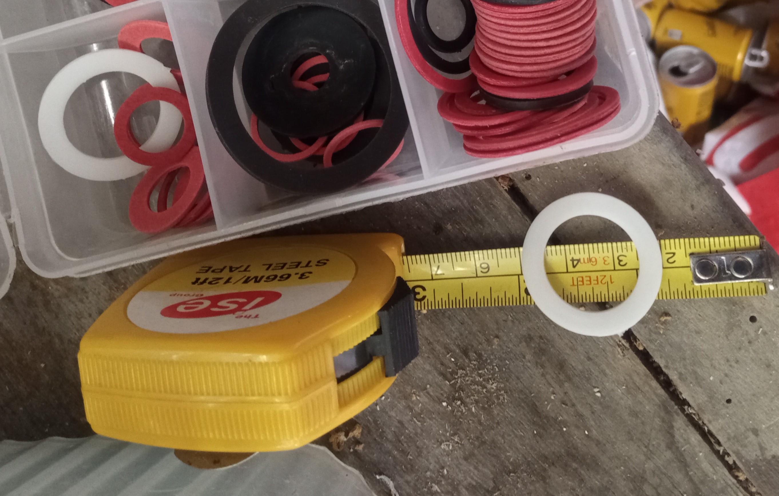

Excuse this if it's been done before. I didn't want to crash in and start a new thread. I have a maverick .22 running 23g zans at around 1035 . Mostly a well behaved gun .
However with hunting and in and out of the gun safe I had the poi shift . I found a cheap easy solution that stiffened the shroud tensioned the barrel and sorted the poi shift . No tools 5 mins . Plumbing washer between shroud and frame . MODS ,If this is inappropriate or in the wrong thread please move. It's working for me thought I should share. Regards Chris UK.
