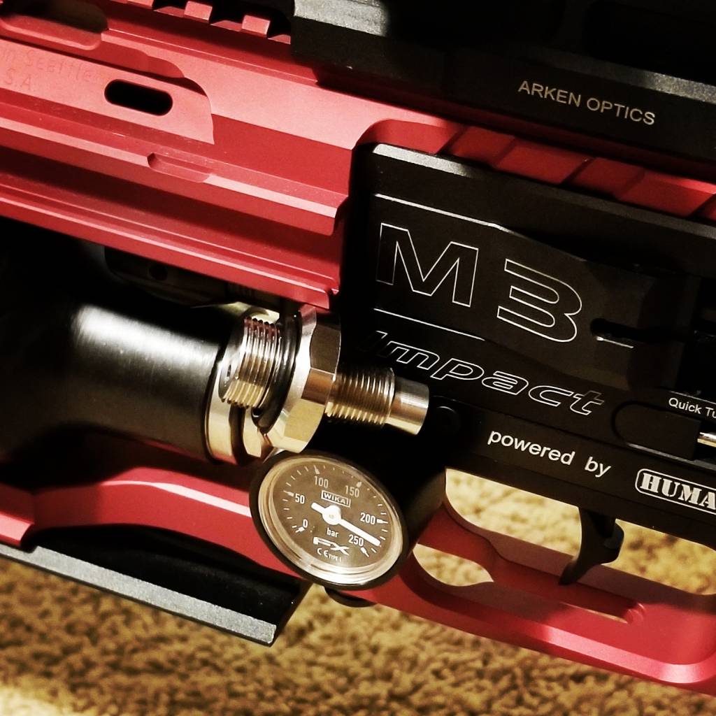

M3 Delete the Reg!
Ok, so I know there are going to be some haters on this one but I'm excited that my KL M3 Delete the Reg arrived yesterday!
But some background...I have a 2nd batch M3 and just had no luck with the front reg. It was back to service after 3 weeks as it blew out. Mine had the creeps worse than getting the Radiohead song stuck in your head. I've cleaned, polished, re-stacked...you name it, I've tried it. It's a slug setup M3 at 150bar on the rear, popping 34.9's at 950. I have really tried to love that front reg, but we are breaking up. My favorite memory of our relationship is during a nrl22 match when mrs. front reg decided to either go to the setpoint of 190-210 (I'm a creep...) OR not go past 140 bar...that was a fun match.
To prepare for making my M3 a glorified MK2, installed a Huma reg that'll hold at 150bar for days (even against full bottle pressure as I had since turned the front reg all the way out). I will say this--would I do this with a 300bar bottle and stock amp reg? Nope. Will this void my warranty? I have a feeling, it likely will. Do I care? Nope, because the gun is shooting great without the front reg in play with a Huma in its butt.
The current combo of Huma rear/front reg disabled has made me love my M3 again...and this weekend my shiny new reg delete will be mating with its new home!

Andrew, please explain why you are using the K&L reg delete fitting vice just dialing the front reg to maximum? Thanks.
If I'm not using it, may as well remove it! One less thing with parts in it that's on my mind...and honestly, it just made me angry.
That being said, comparing the airflow restriction with just my eyeballs, the reg delete offers a path of less restriction (vs a little side channel cut on the reg screw)
@kiba get what you're saying--once I swapped out to the Huma, I did a similar test but with the front reg disabled. 149.8 bar overnight for a week straight with a full 250bar bottle fill.
