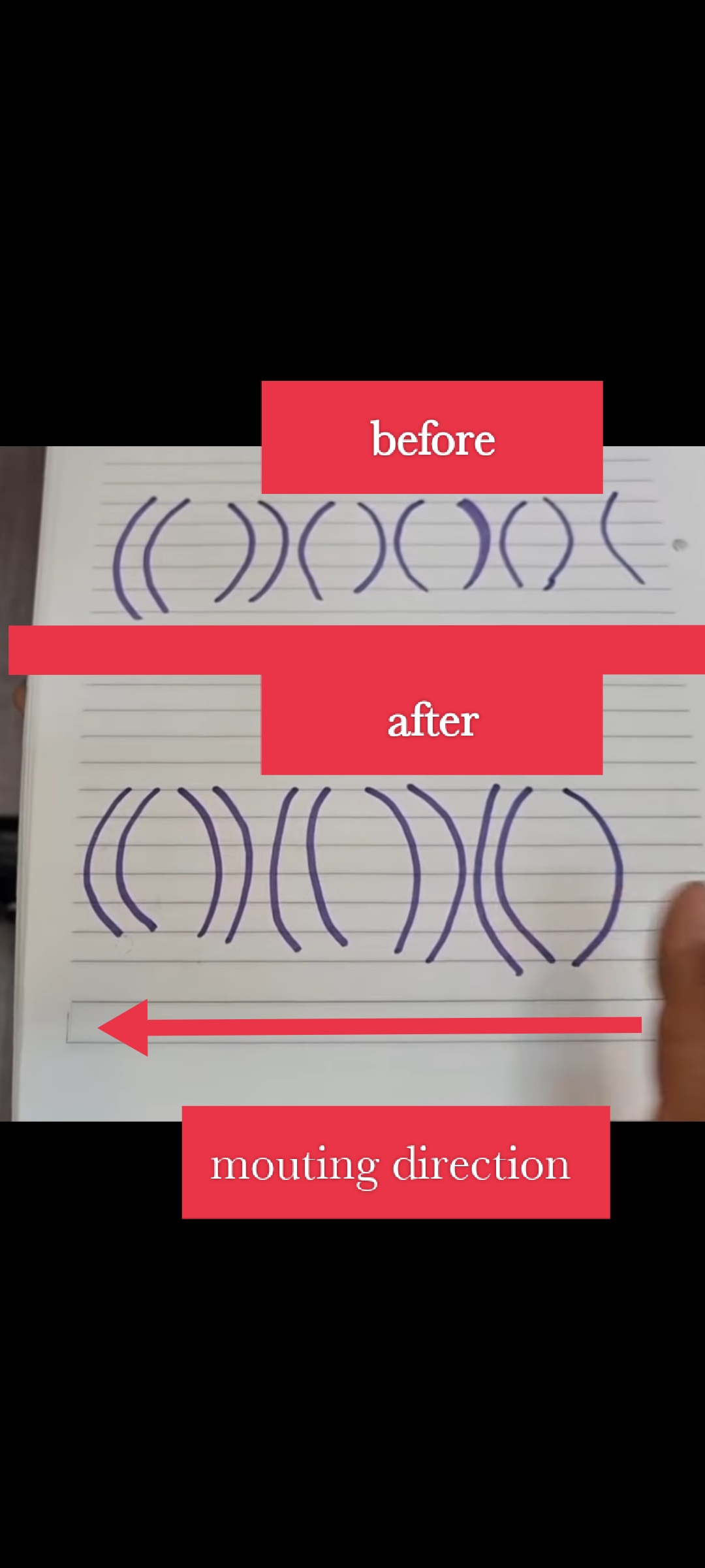

Open it and change the order of the rings inside it
Like the picture
