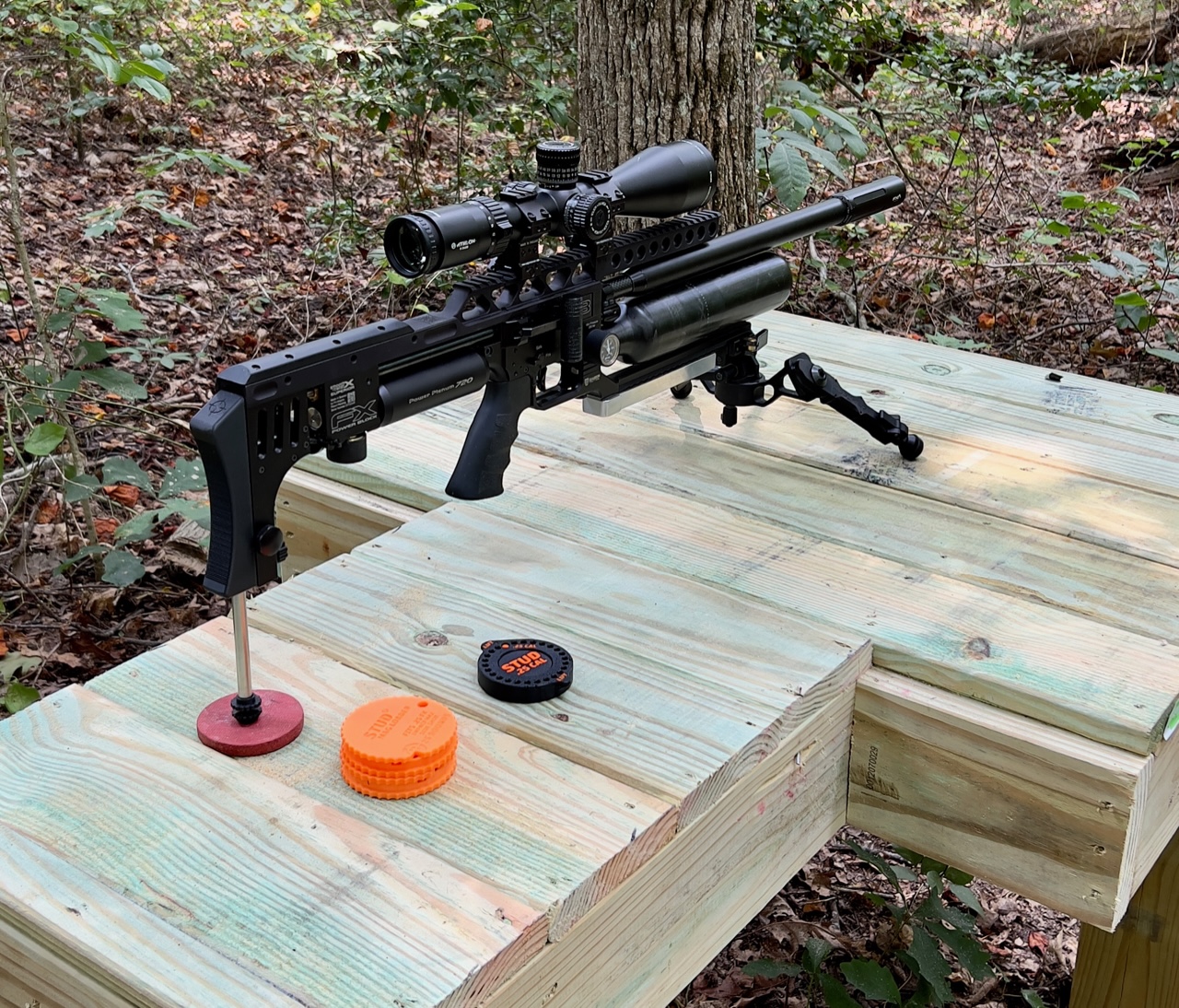

I've got the Stud magazine and the speed loader kit for my .25 cal. MK 3 and I love it. I've never had any problems at all with it and I shoot almost every day on my own range here at my home....:)
