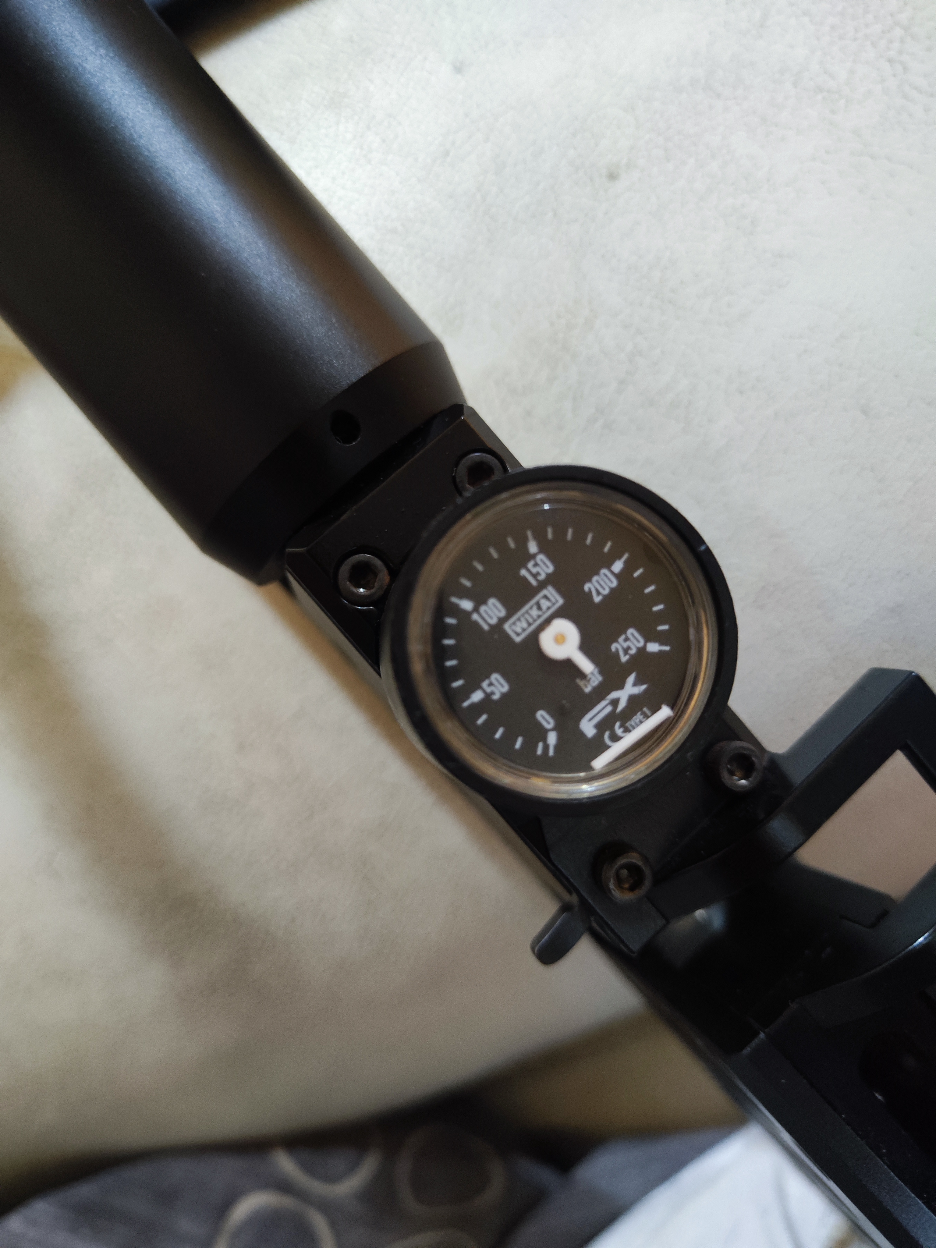

And today something happen again... My second reg gauge needle is broke.
Any the gauge is expensive in my country.. Can anyone give any alternative for the gauge that can fit in it?
