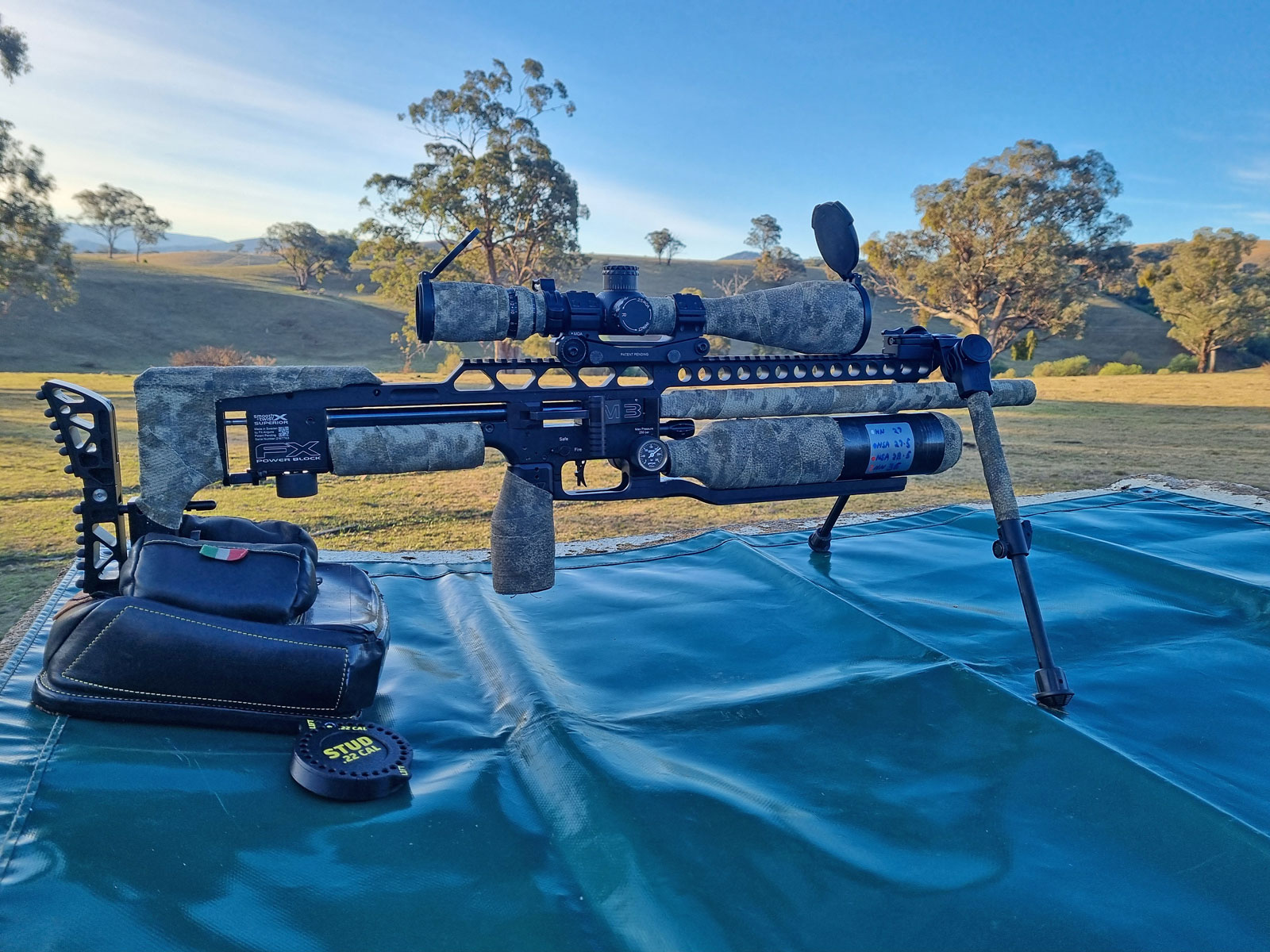

Well..... i usually run 22cal .218" 27.5 or 28.5gr NSA Slugs at around 1040-1060fps with fantastic results.
I am using the STD liner . I have previously tried NSA 31.5gr and they were OK, but not brilliant. I was under the impression that circa 33gr was the upper limit of the STD liner for stability.

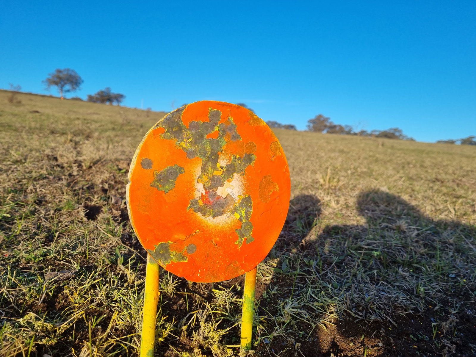

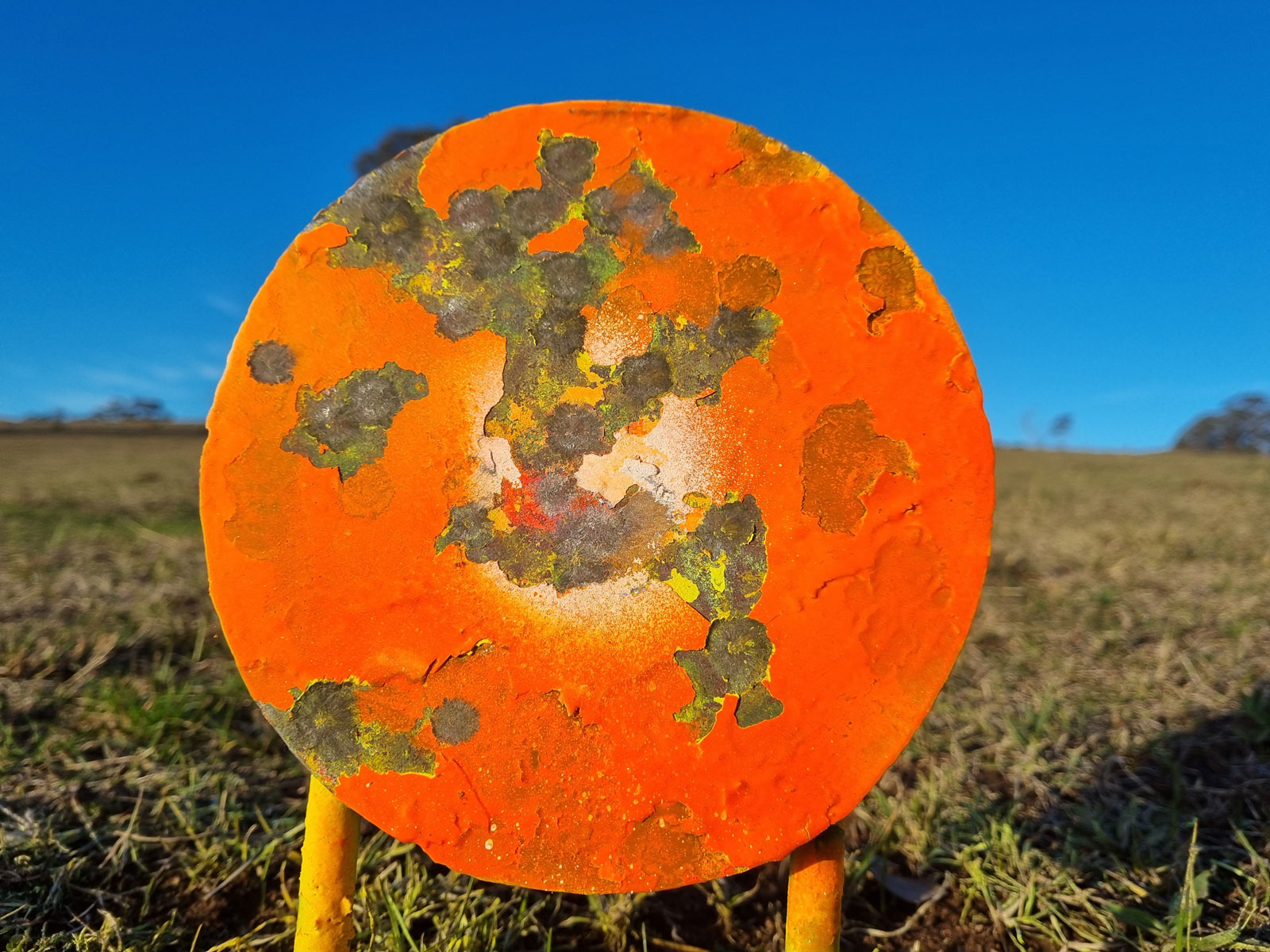

Well......Today i thought what the hell and tried some H&N 36gr .218" ...... What a surprise !!! Not only did they stabilise , straight off the bat they are circa 7/8 moa at 1020fps.......Christ was i shocked.
What is the max weight others have successfully used in the STD liner??
