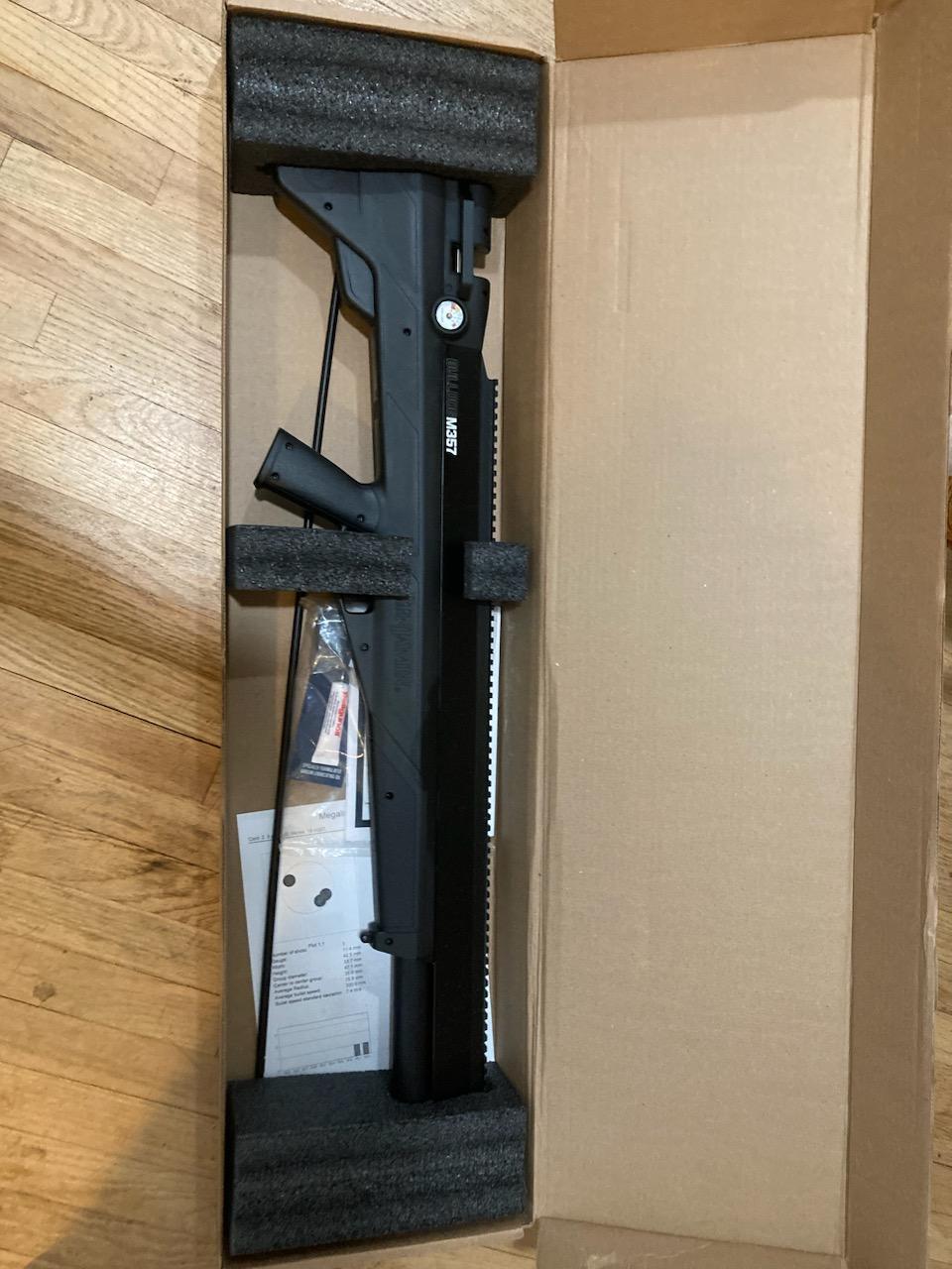

I just recieved my bulldog from pyramid air. Do I need to do anything to this other than fill with air and shoot it? Sorry this is my first pcp.
As a first time PCP owner, there's a few things I'd recommend doing: Look it over real good to get familiar with it and the magazine, (particularly how it operates and how they work as a unit when cocking because some pcp's are susceptible to double loading slugs in the chamber). Clean the barrel until your patches are white to remove factory manufacturing debris. Mount a solid sighting apparatus of your choice on the rail. Fill it with air to the recommended fill pressure, sight it in, and enjoy learning it.

@bubatrucking Definitely clean the barrel. Know that this is a loud airgun that is not backyard friendly. Also be sure to have a safe backstop. A steel trap, deadfall, or berm would be ideal. Also learn your ranges and holdovers since it an unregulated gun. What sort of ammo did you purchase?

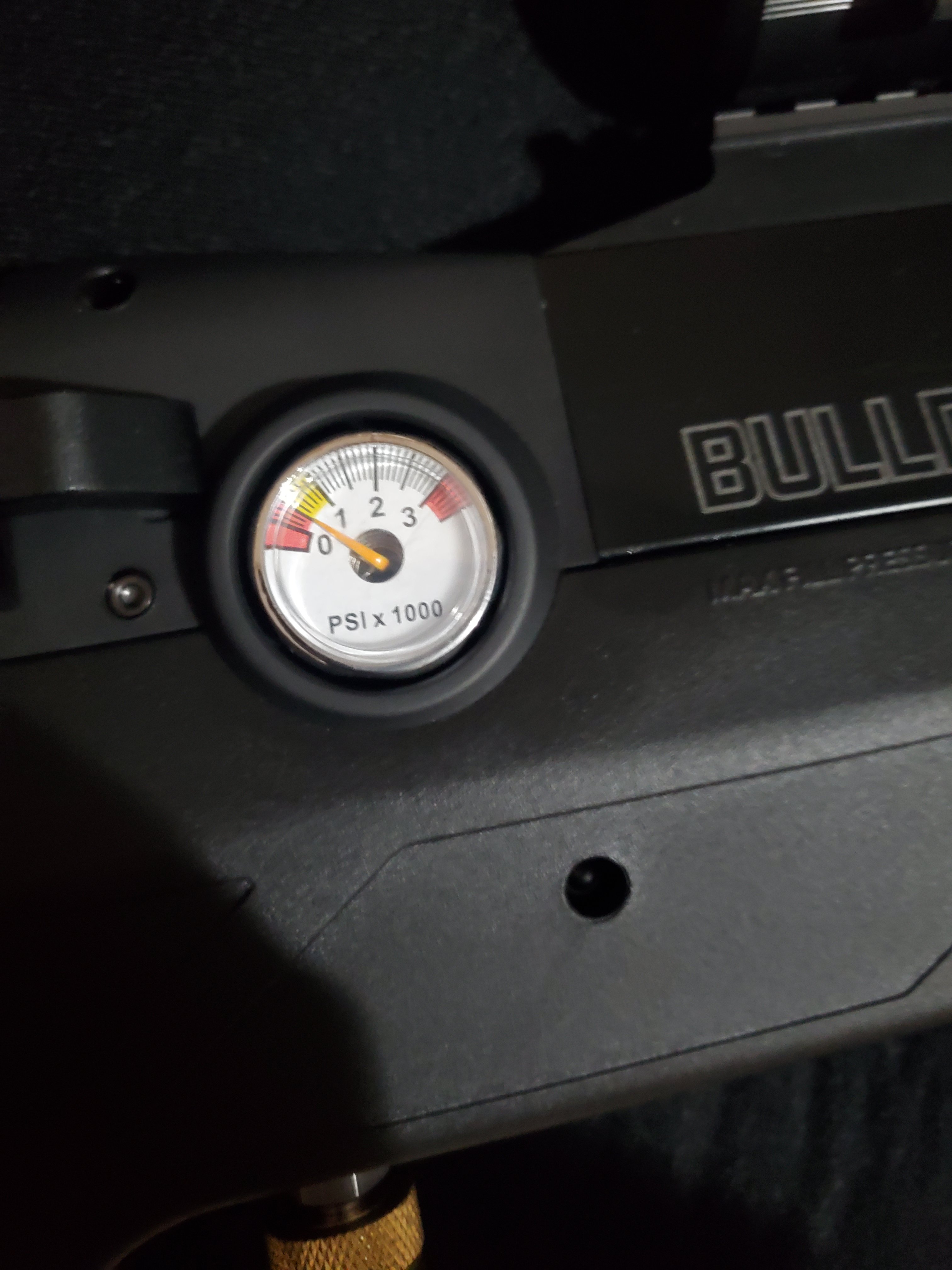

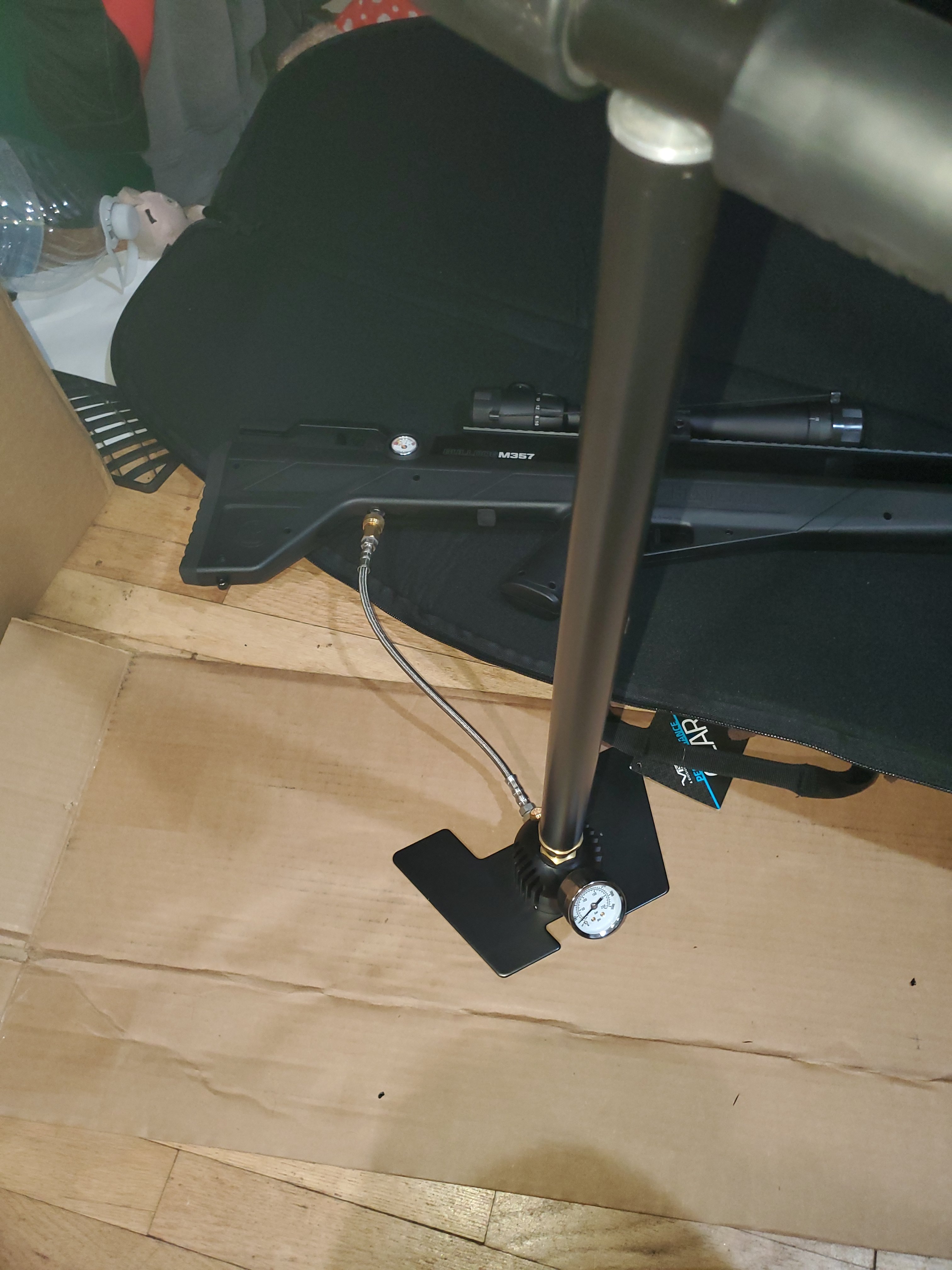

2 hours later I'm at 2k psi. It's getting difficult to pump .
@bubatrucking Now you're getting to see what it's allllll about. Keep this up and be sure to shoot a few times a week, get some good sleep, and maintain a decent diet and you'll be ready to peel that t-shirt off at the beach by summer 2024.

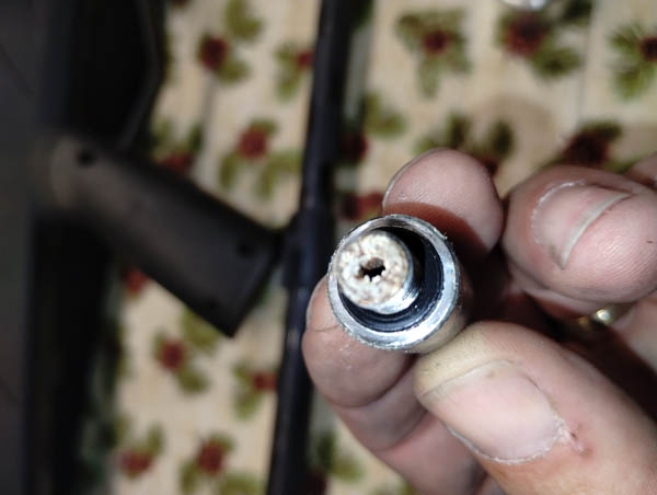

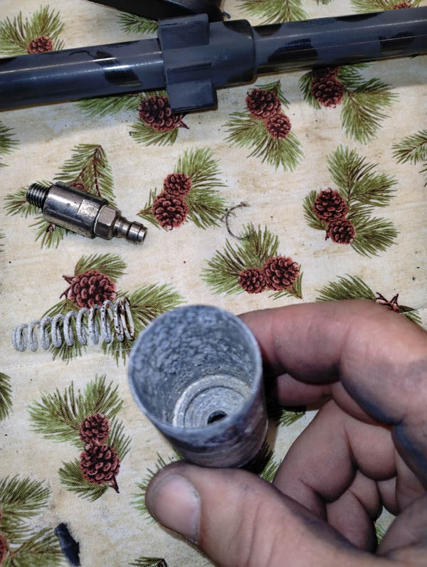

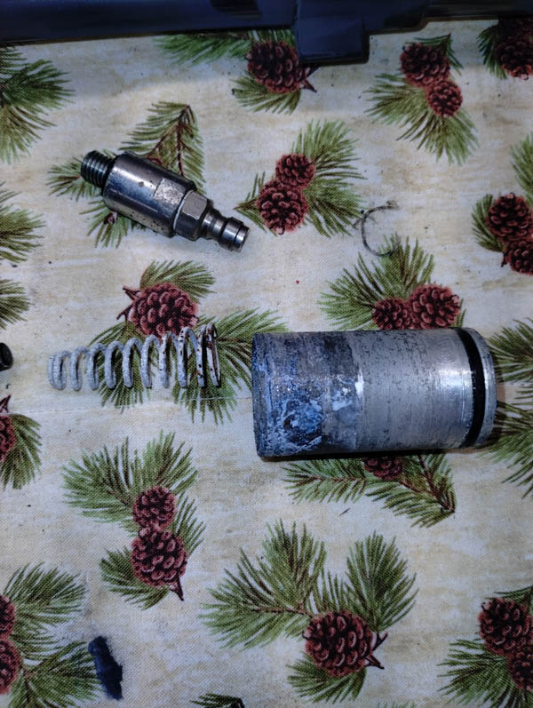

Bubbatrucking, if you are going to keep hand pumping for now I would suggest a good moisture filter, hand pumping can create a good amount of moisture and you want to avoid getting into an air rirfle. It can quickly lead to damage of internal components. As well make sure to utilize soft lead slugs. Hard lead slugs can damage the barrel. Make sure to check all screws to ensure nothing came loose during shipping. Have fun you are in a good community of folks who are alway s happy to help and welcome to the sport.

View attachment 409128View attachment 409130View attachment 409131
Holy poop! Is that all just corrosion!? And over what period of time!? Honestly that’s scary af

@bubatrucking - Welcome to the rabbit hole called PCP's! If I had to do it again, I would start with a portable compressor instead of a hand pump, then a tank and then a compressor. These seem to be the most popular self contained compressors. Do your homework and watch as many youtube videos you can find on the subject.
