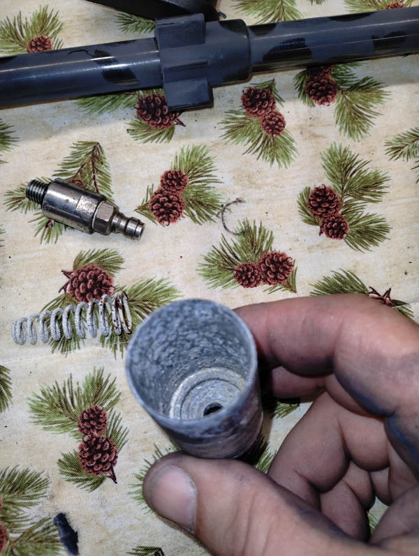

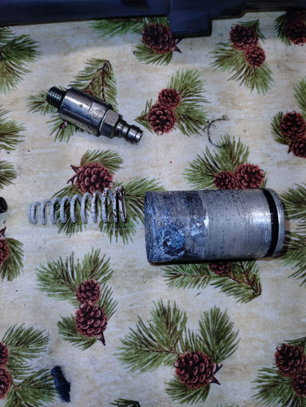

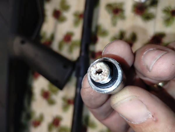

Bubbatrucking, if you are going to keep hand pumping for now I would suggest a good moisture filter, hand pumping can create a good amount of moisture and you want to avoid getting into an air rirfle. It can quickly lead to damage of internal components. As well make sure to utilize soft lead slugs. Hard lead slugs can damage the barrel. Make sure to check all screws to ensure nothing came loose during shipping. Have fun you are in a good community of folks who are alway s happy to help and welcome to the sport.
View attachment 409128View attachment 409130View attachment 409131
@bthurman has been saying this for a long time and backing up his prescription with photos. I recall that there were some naysayers trying to dismiss what he recommended when he mentioned the importance of dry air. @Humdinger is another that has been expressing the importance of compressors providing clean dry air. He advocates (and has been advocating for some time now) for getting a quality compressor for this reason. AOA is just releasing a video on this in late Dec 2024.
