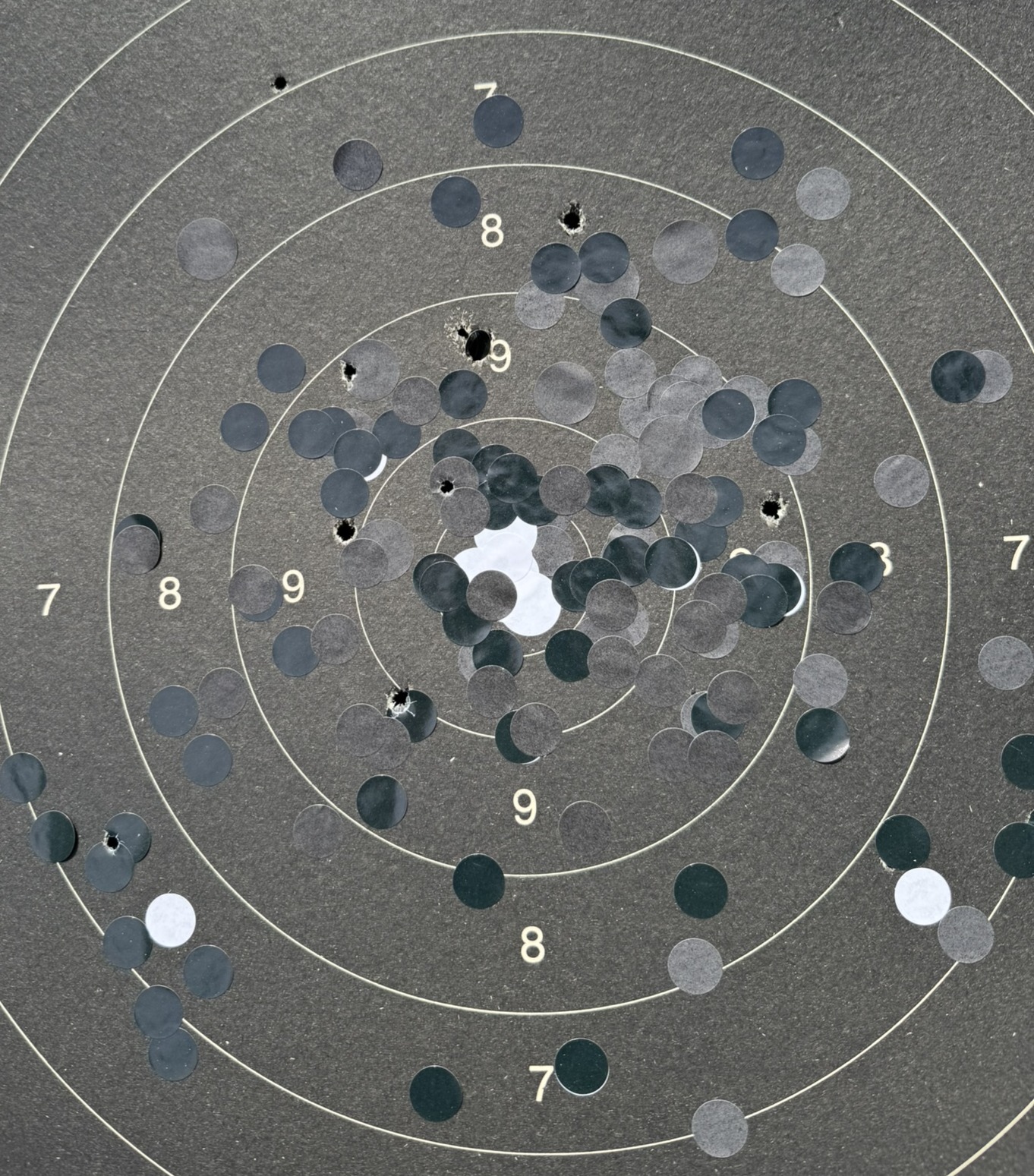

Hi,
Was testing my setup in 300m range. 130Bar, Ma8-Mi3, Valve adjusted to limit 10m/s from top velocity measured around 293m/s. It was windy and cold day, and also didnt have spotter or possibility to see hit, so basically eyeballed those holds from dust puffs. Was shooting from tripod. It was crazy, 2 to 2,5 MRAD windage hold from right to left wind.
H&N HP II .250 36gr (Factory BC .106) Funnily enough didnt run even close to those BC values in these conditions. FX TBC gave me 0.098 and below.
I think I am going to go ATP 49,5gr testing next..
