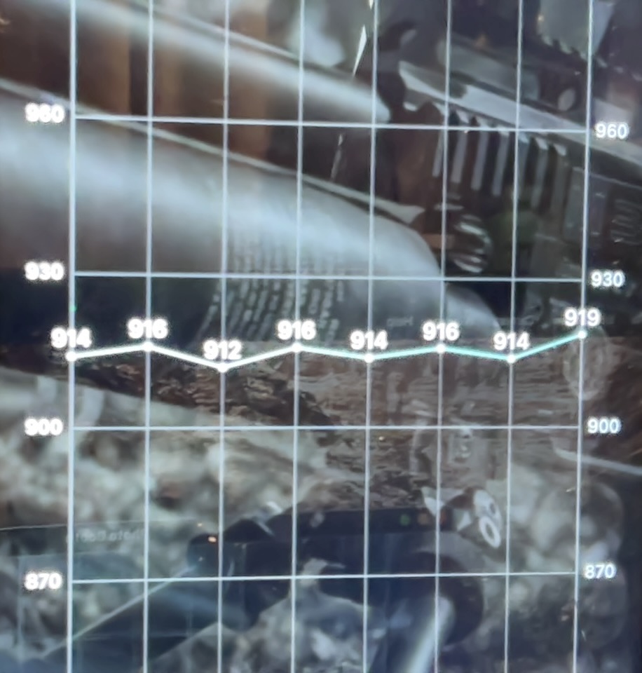

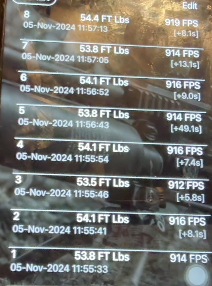

M4 .25 Compact slow the NSA 29 dished down from 950 fps to 915 avg. Stock except pin probe. Barrel on dual slug port. Shooting NSA 26.8, 29, H&N 30 and 34. Photos are. the NSA 29 Dished Reg. 120 Macro 8, Micro one click pass 3.5 VA just pass 4
