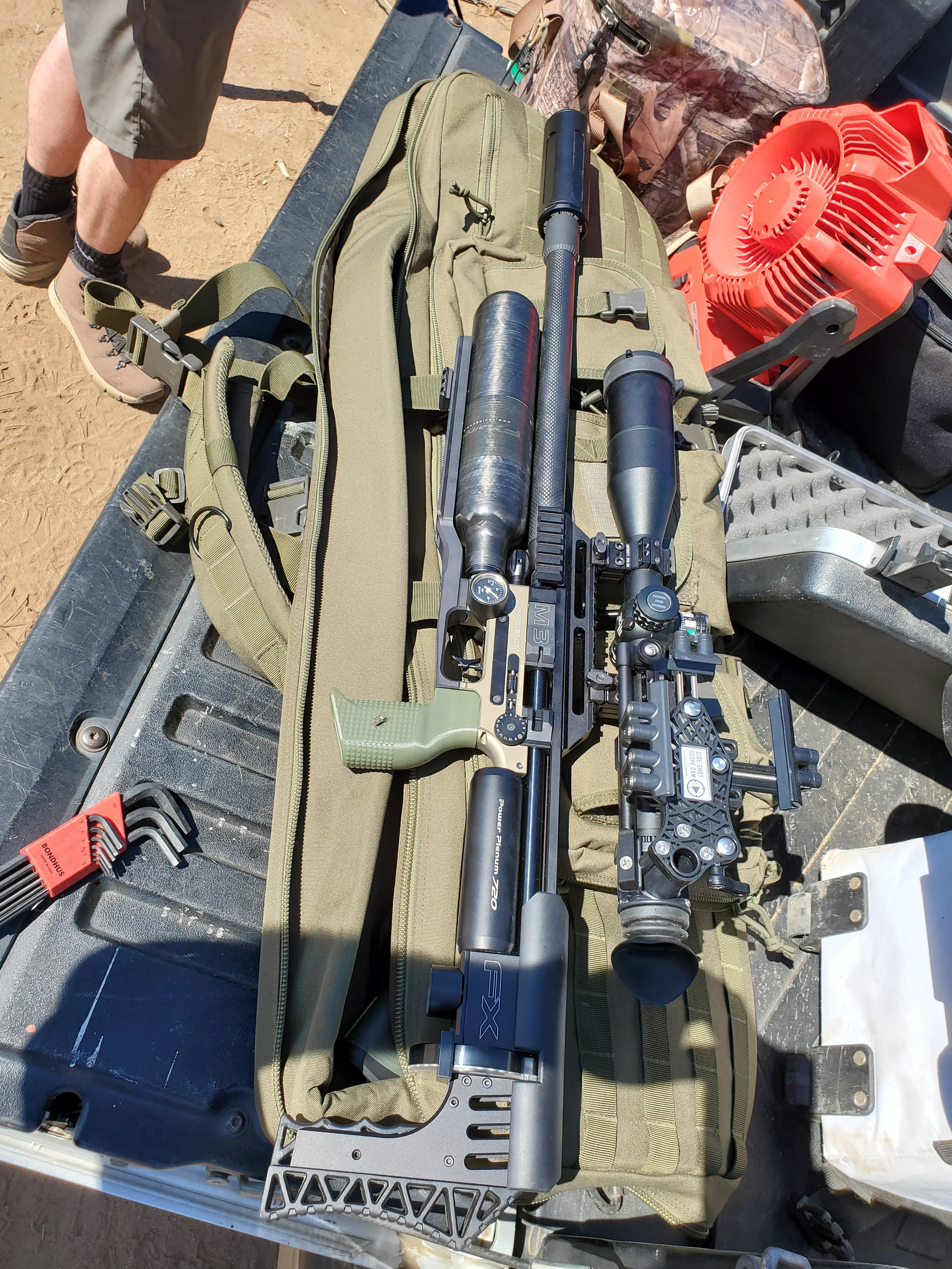

Got a picture of your rig? Mine was having poi issues in the field during a hunt!

After all the things I did, I can let the gun sit for a month and crack off an oddly specific 93 yard pigeon shot with a light slug just below the speed of sound with regularity and not get in trouble for sketchy stuff.
Key is plenum Pressure consistentency, 2nd put a spacer behind your shroud that let's you tighten the shroud against the body. Now you have a tensioned barrel. I bought the carbon tensioner and it's no better than the collar I machined... But it's extra weight and money that a 1 dollar part already fixed.

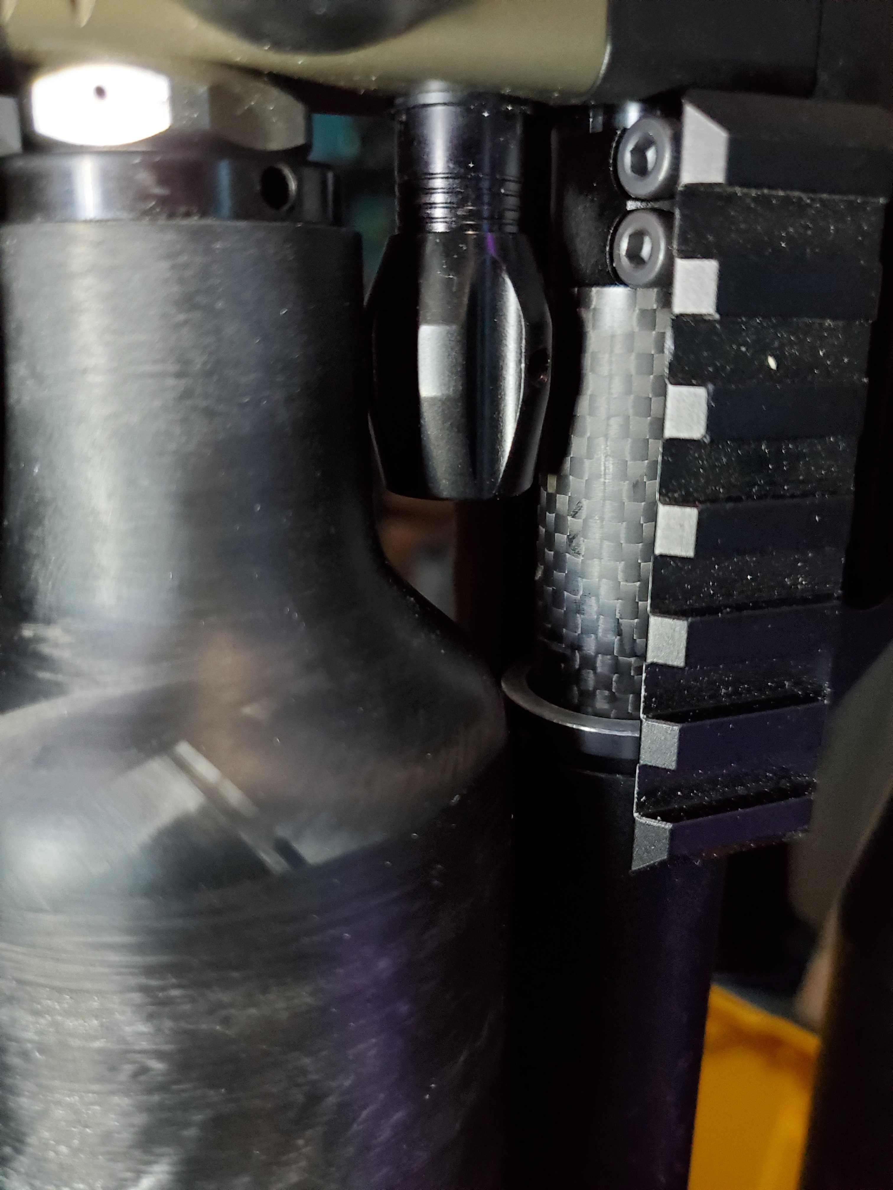

Got a picture of your spacer? I might look into fabing some stuff on 3 axis Haas mill
Lemme look. I just measured the shroud to action gap and added 20 thou on a piece of brass pipe I had and made sure the faces were parallel and tried it, then aluminum was made. No more barrel shift from rough handling. I have the carbon harmonic tuning shroud over a carbon tensioner with a carbon stiffener now 🤣. If you know the meme "cahbahn piebah"

I apologize in advance. I realized that this is the only pic I have of that spacer if you zoom in.
Hey I can work with that!

I did the tensioning thing in my Impact infancy. If the material used does not match the temperature expansion and contraction of the block and shroud, instant POI shift. But mind you, I’m sitting in the woods when the temp starts in the 40’s and swings up into the 70’s or vice versa. Now I just use real barrels and all that other barrel crap can stay in a box somewhere.

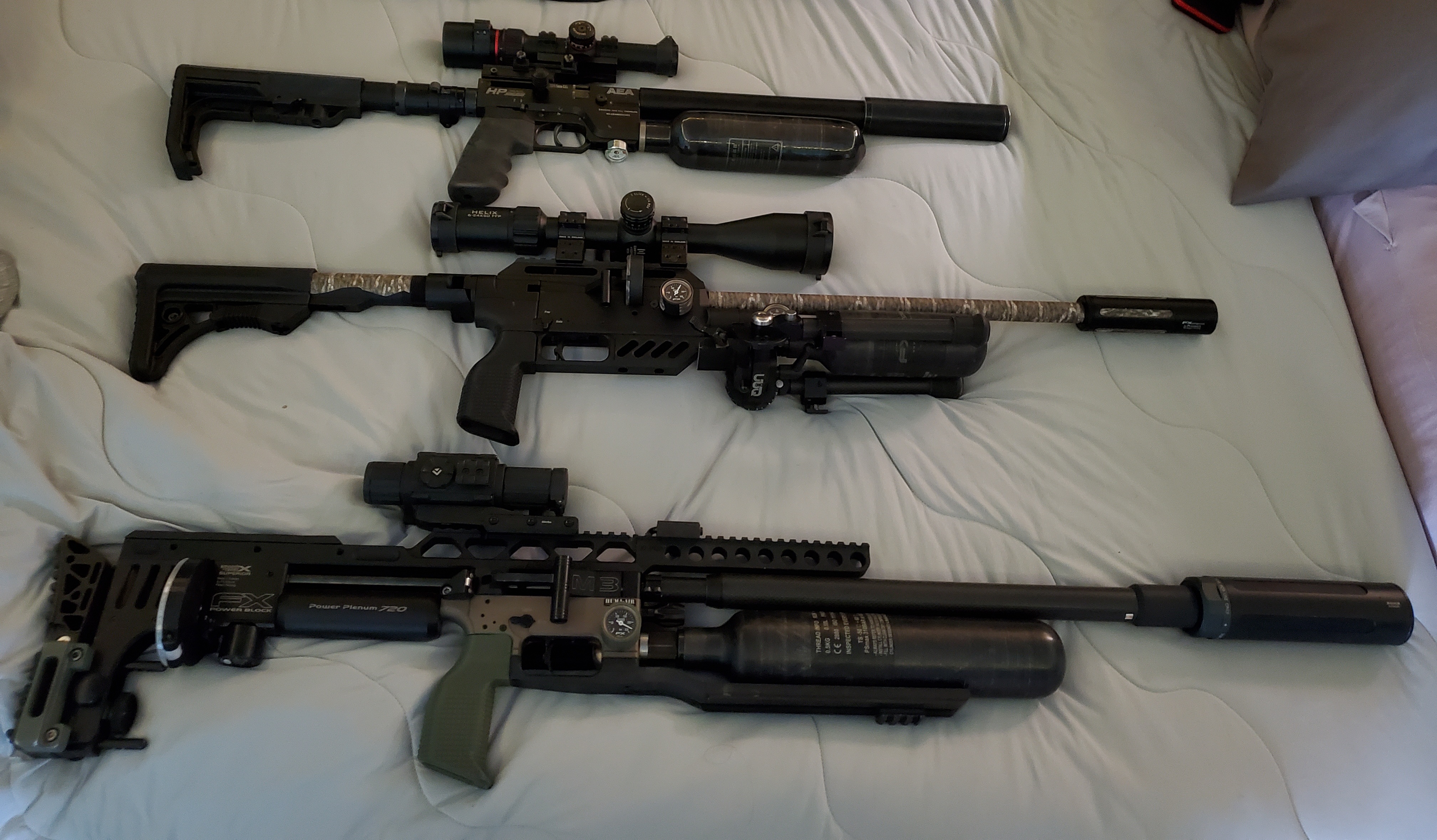

I love it. As a tool and die trades man I like it!
I'm a bit of a millwright these days but a finish carpenter to buy the toys. Find the 1 off parts 😁. Middle one is Bone stock.
That's why I went from brass to aluminum to delrin and then just got the carbon tubes and it was OK even in 115 degree ambient temps and direct sun southern ca heat. It's the day I started hating my impact changes for the weight when i pulled off an offhand 150 yard squirrel shot.
