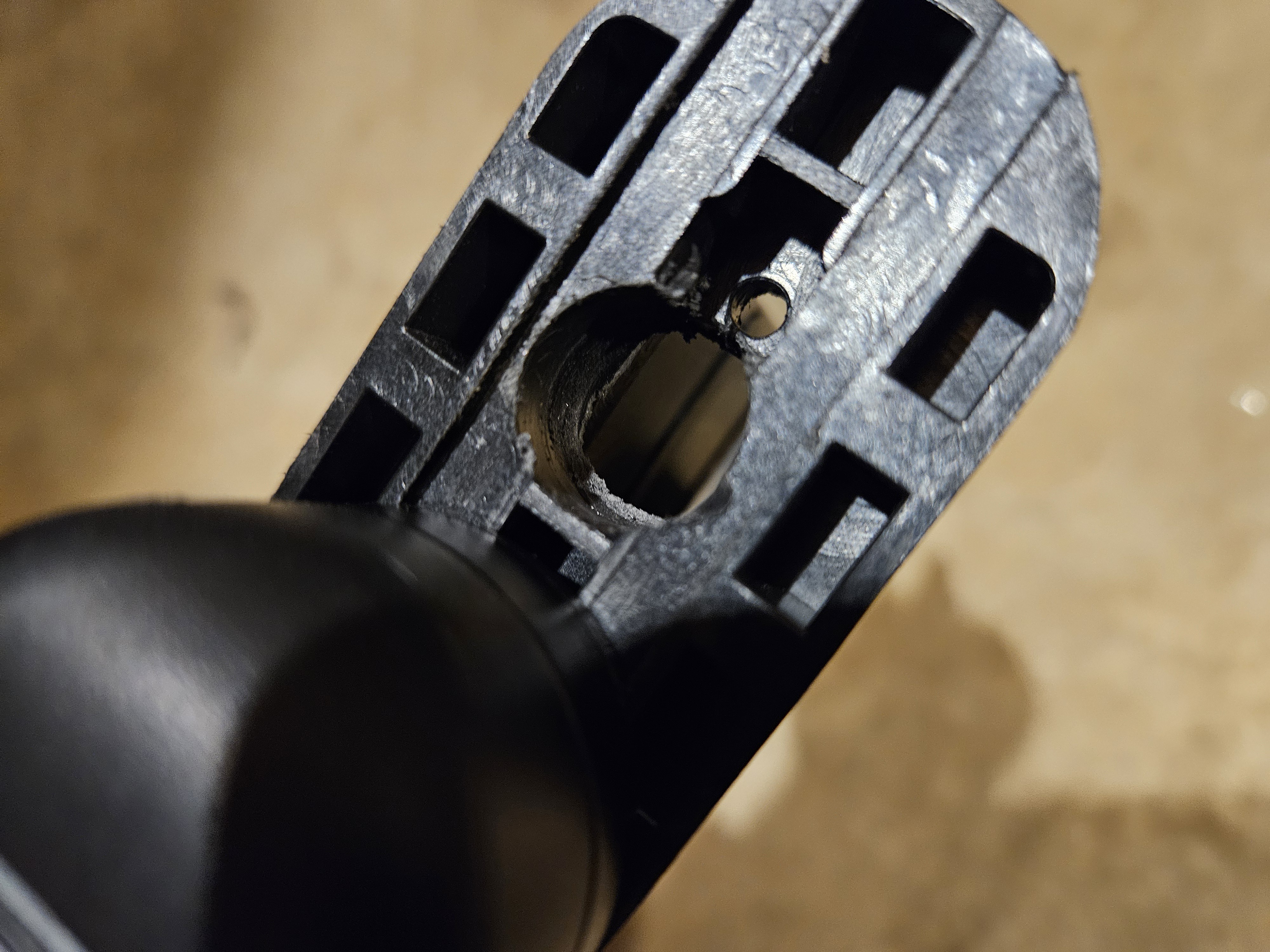

Ok, it's ridiculous the amount of screws you have to take off to get to the hammer spring adjuster. 14 screws. Why?
I digress... so clockwise makes it weaker strike and counter makes it go boom more. I brought it flush with the receiver and was hitting 850s with 50.15 grain for a full mag!
It appears someone has already drilled out the butt to access the spring adjuster. I'm hoping this wasn't a returned gun and that Wes did the mod himself.
