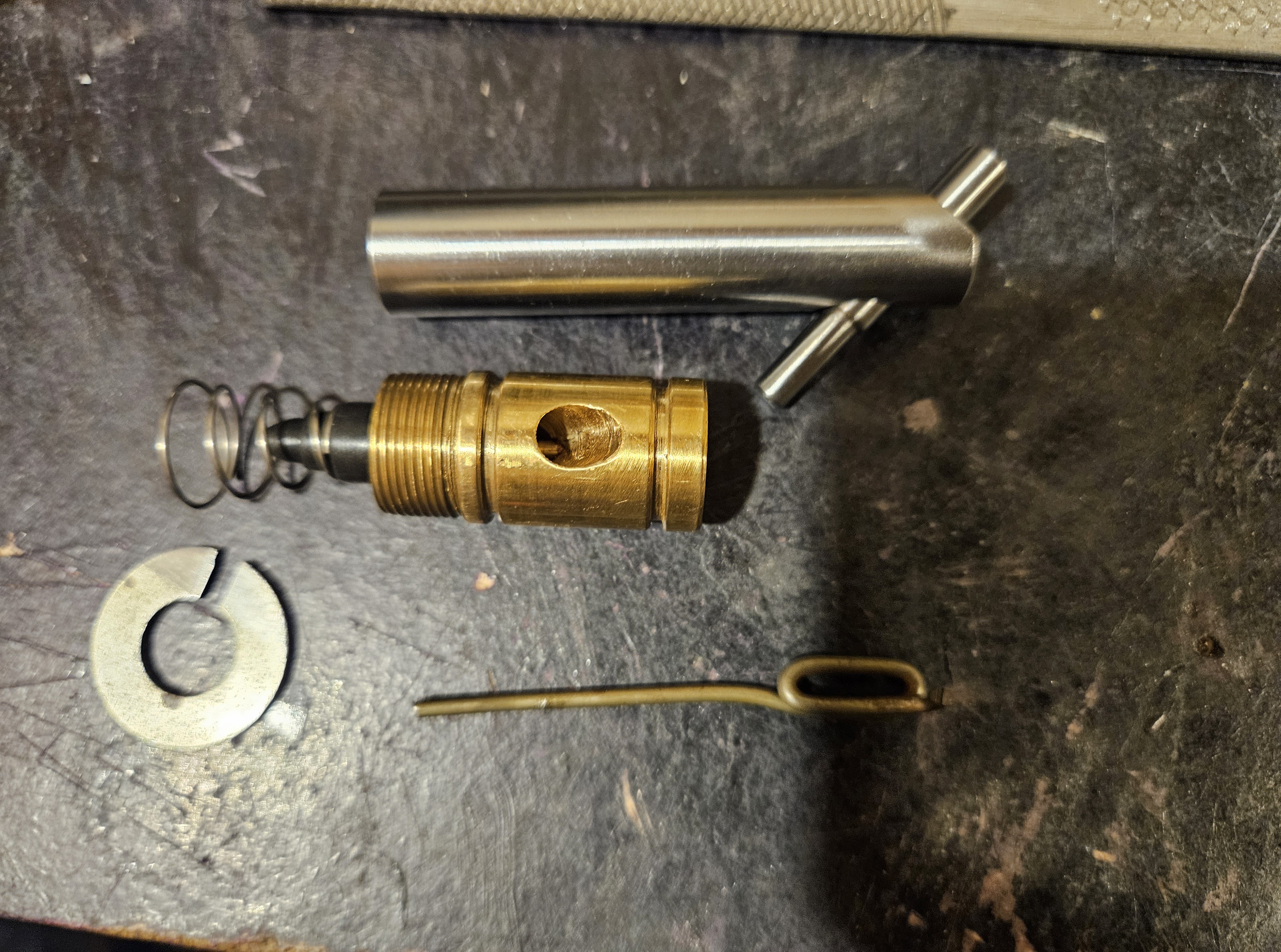

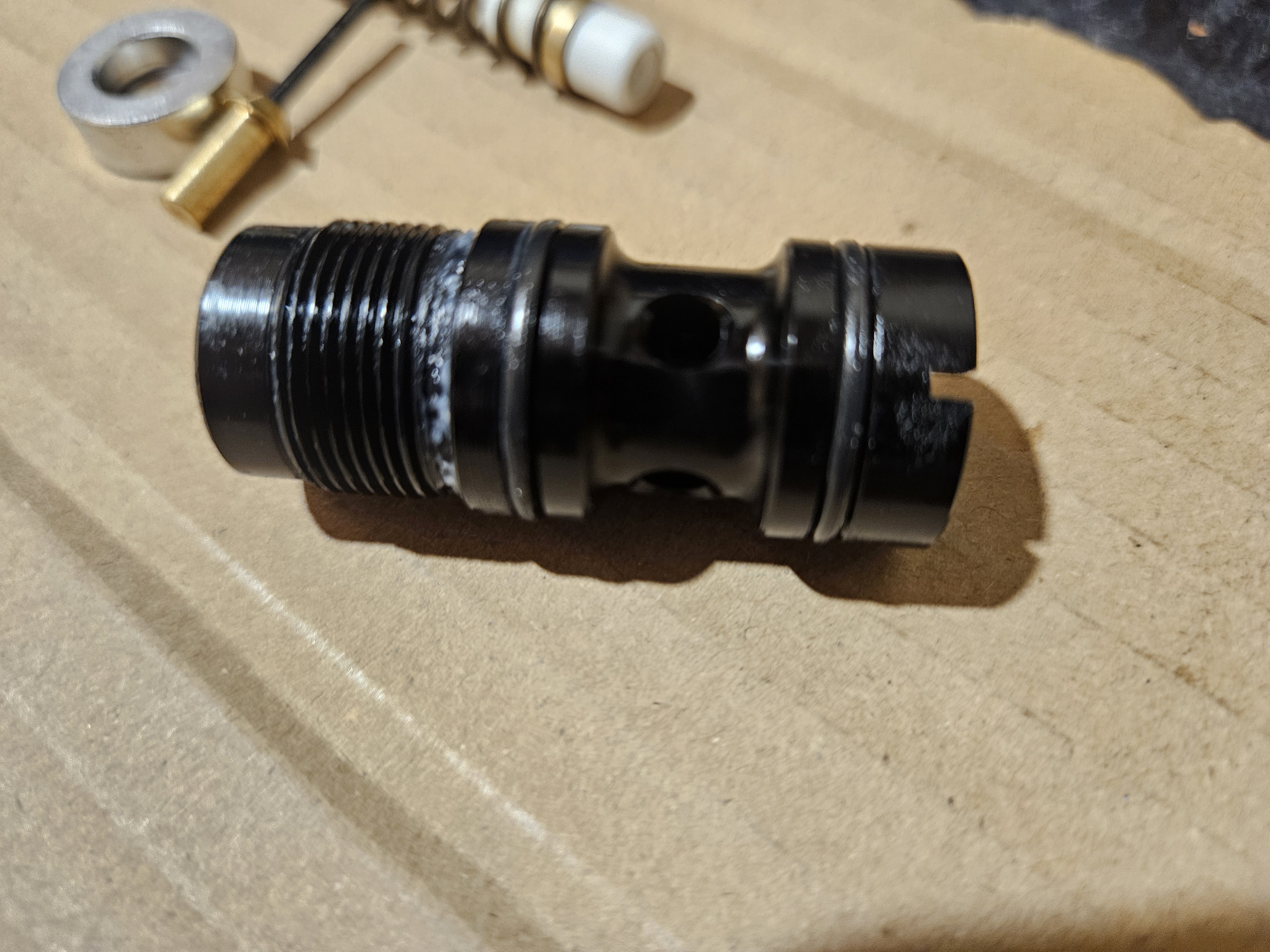

Minor update. Received the slug power kit today. Not much time to mess with it, but had to get pics to show off.

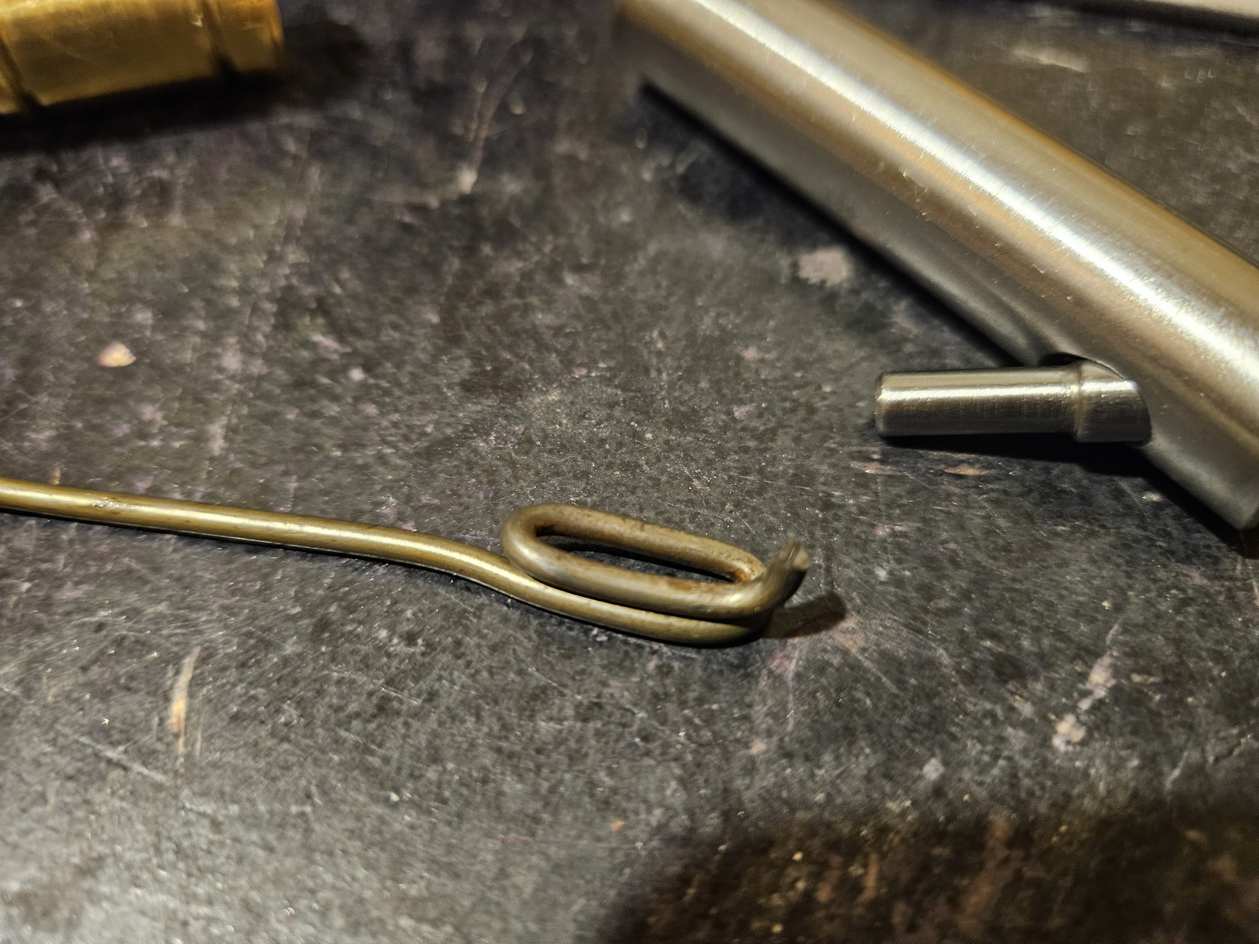

The last picture is the porting jig. Pretty smart idea. It slides inside the action and uses the factory set screws to hold it in place, and the stepped pin aligns it. Then you pull the pin and port the transfer passage out and at an angle.
The curled wire goes into the barrel so you have a bit stop when porting the barrel.
Valve has been angle ported and enlarged, lighter spring, and I'm not 100% sure til I remove the stock valve, but I think the poppet has also been modified or changed.
Hopefully I see 925+ fps with a 45 grain after this. The maker claims 100 fps gain @ less pressure. With the small factory port, I can already believe it. I make my 25 cal ports bigger than this factory 30 cal port.

I do like the guide for porting but the rest looks kinda homemade.
I'm a little underwhelmed by the quality of the valve porting. It could use some polishing. I will hopefully get the work done on the 60 this weekend and find out if it meets the claims or not.

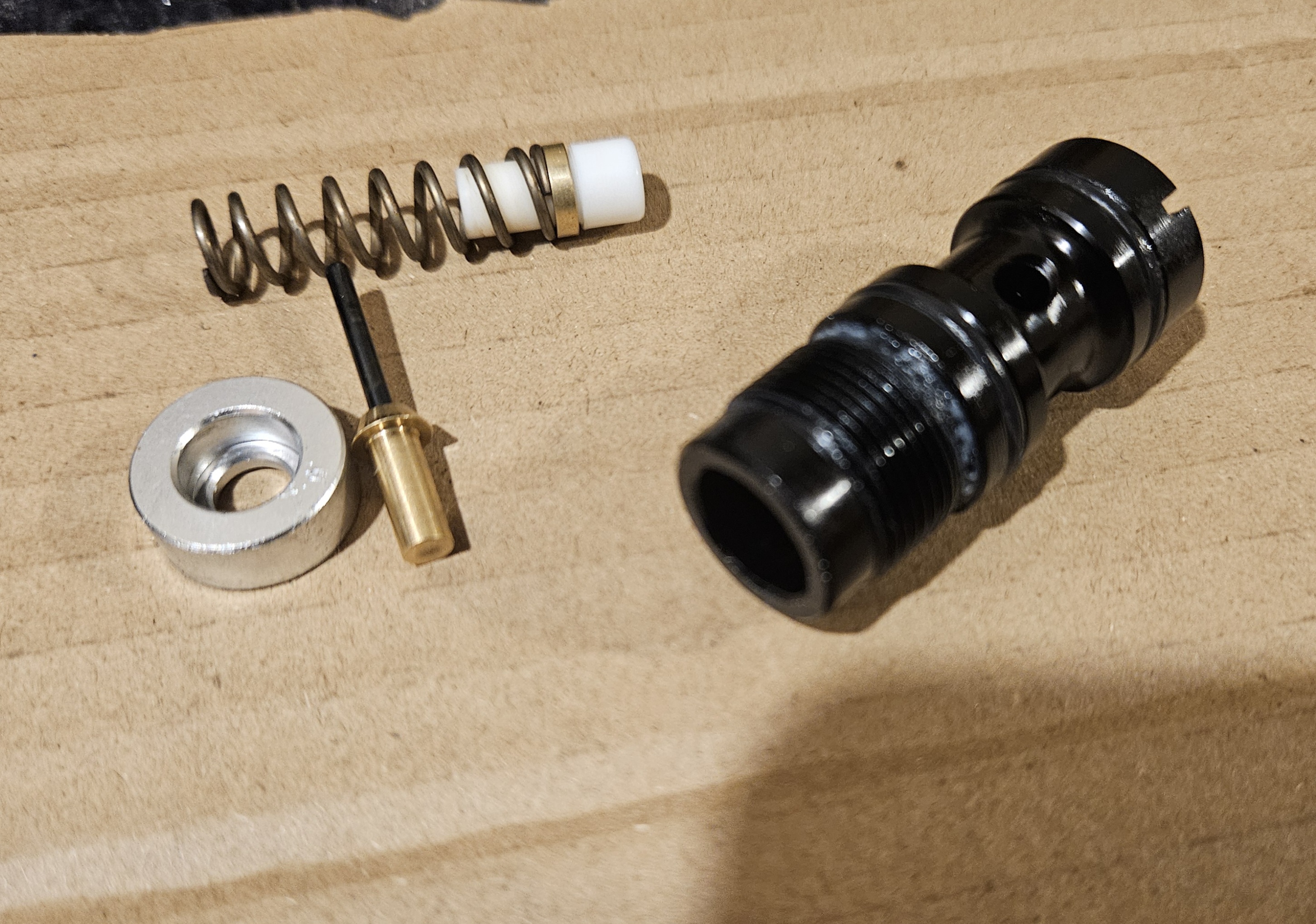

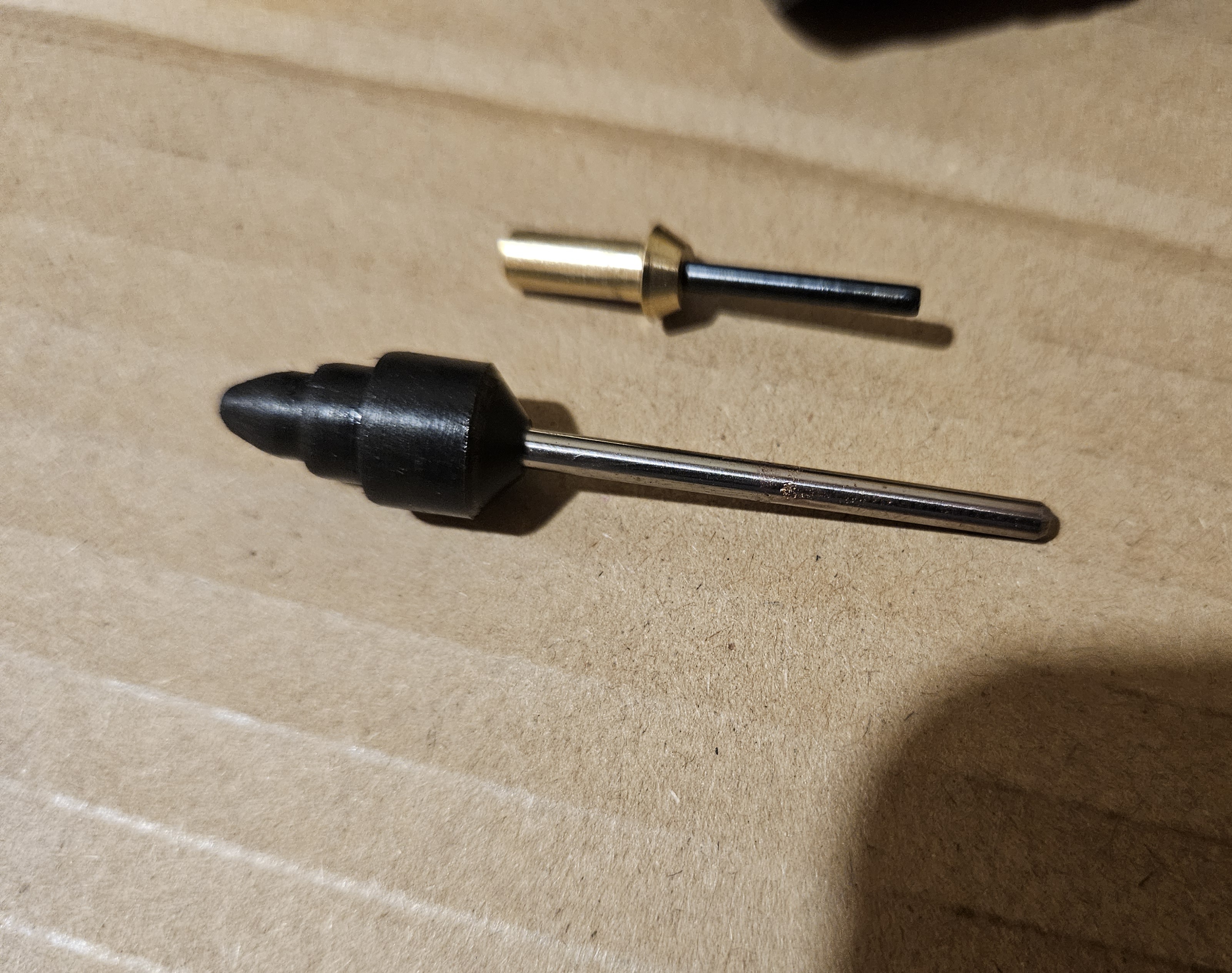

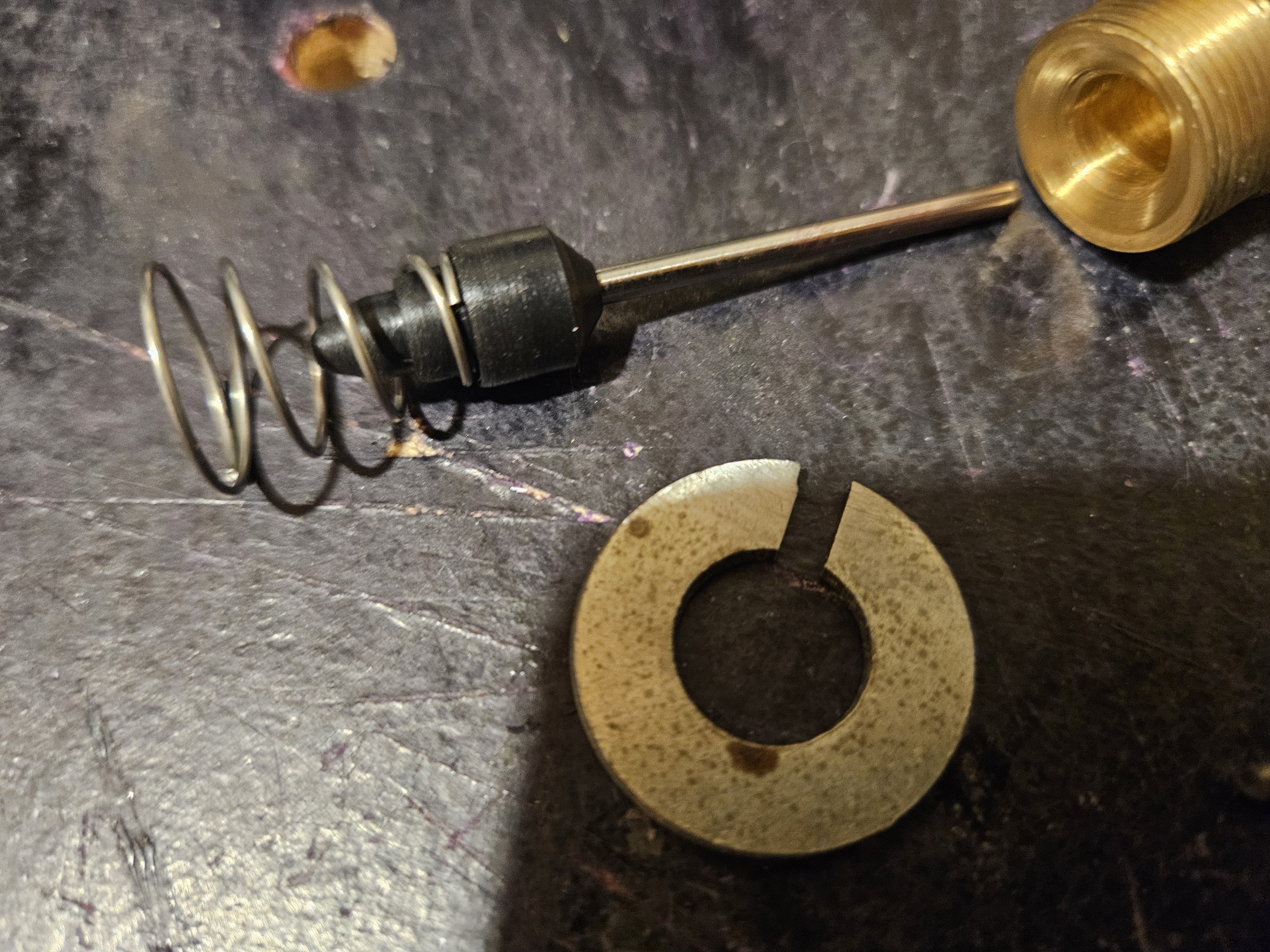

Got the factory valve out and compared the two. Wow!

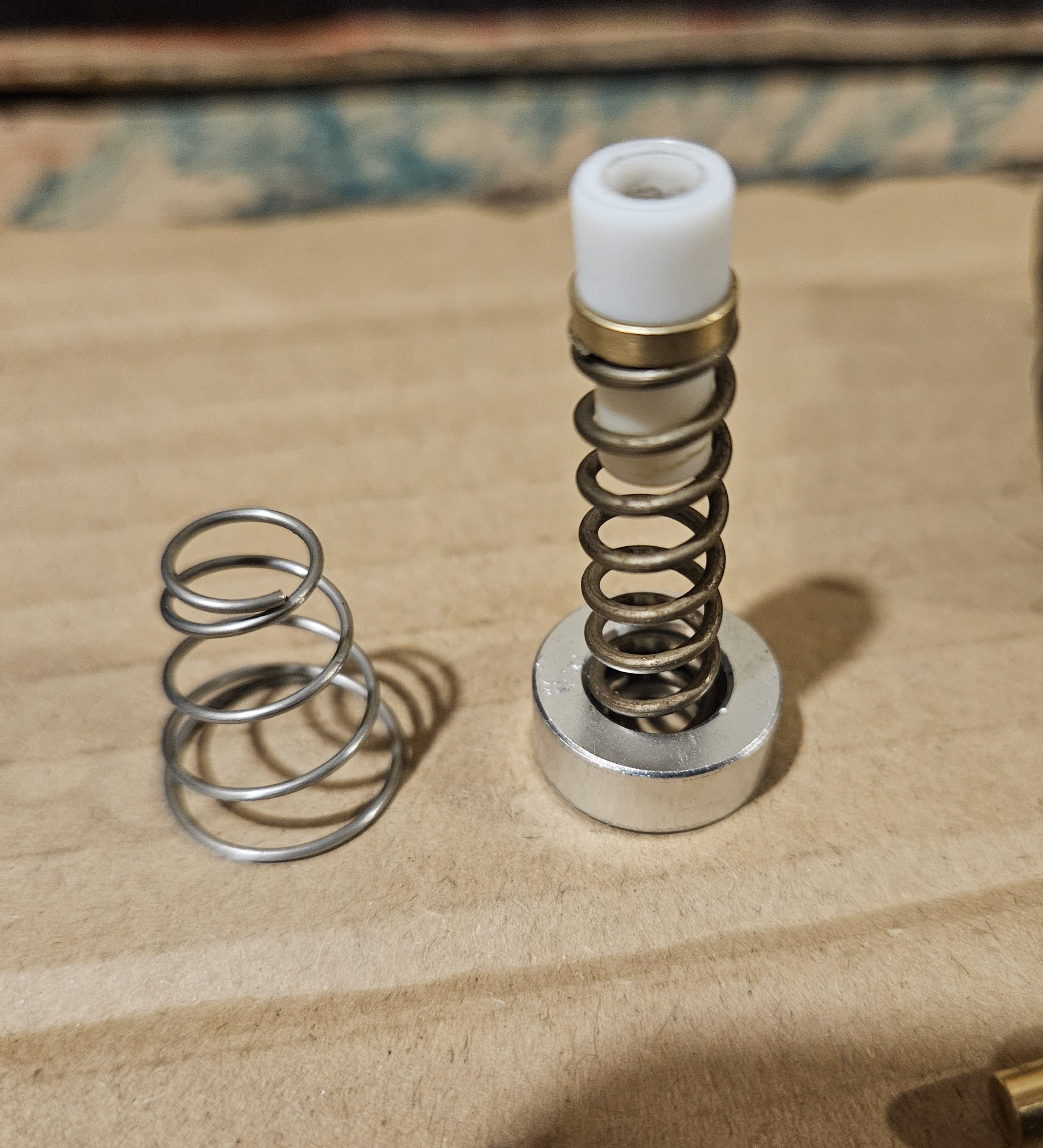

The spring seat and check valve take up so much room and the spring is super stiff. That all goes bye bye and in goes the conical spring.
Much larger pin and a direct flow one port valve vs the multi port. This new valve seems like it will do the trick.
