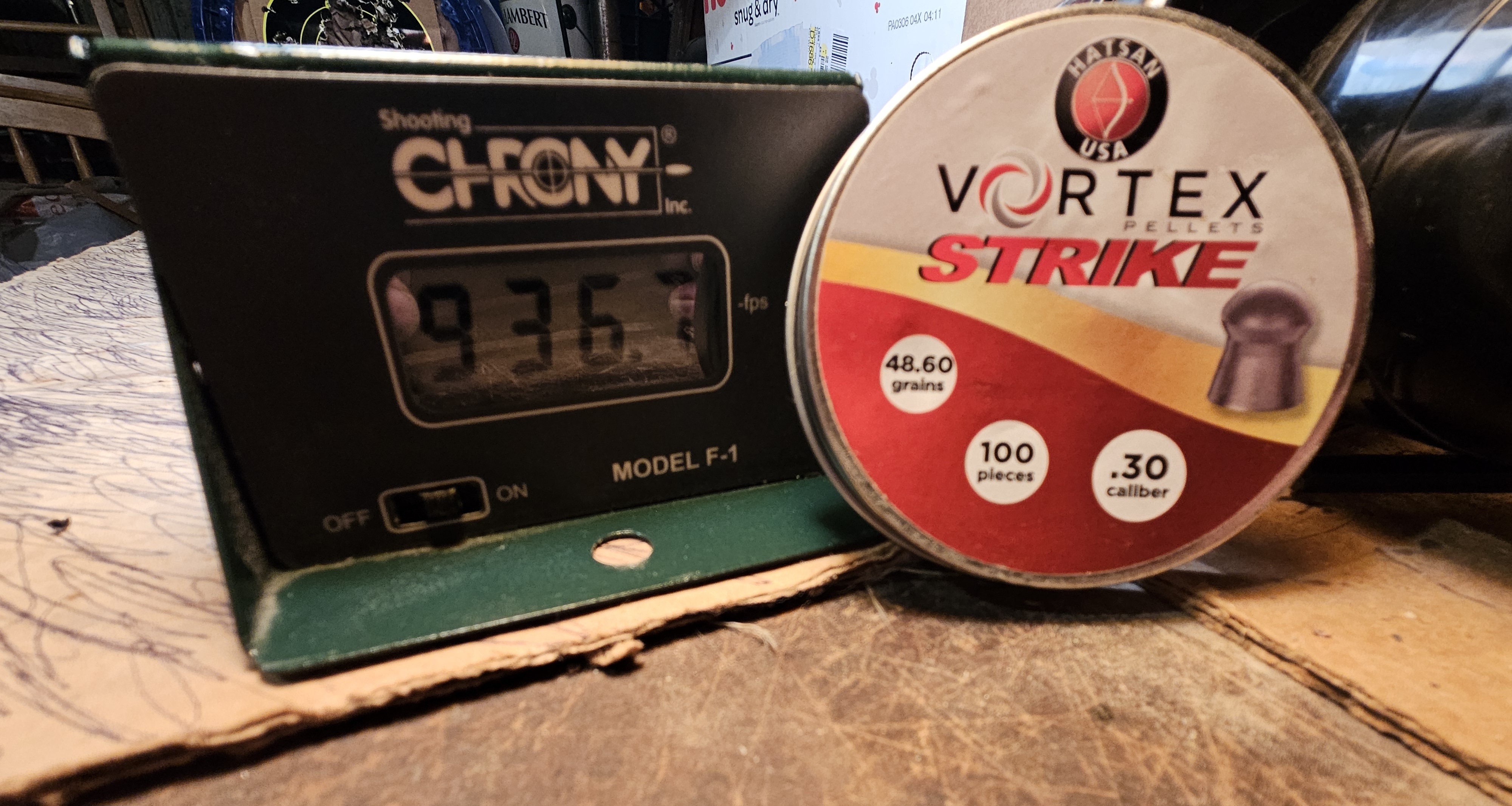

Bumped the reg up to 165 and leaned on the hammer 3 turns from flush, and it's doing this now.

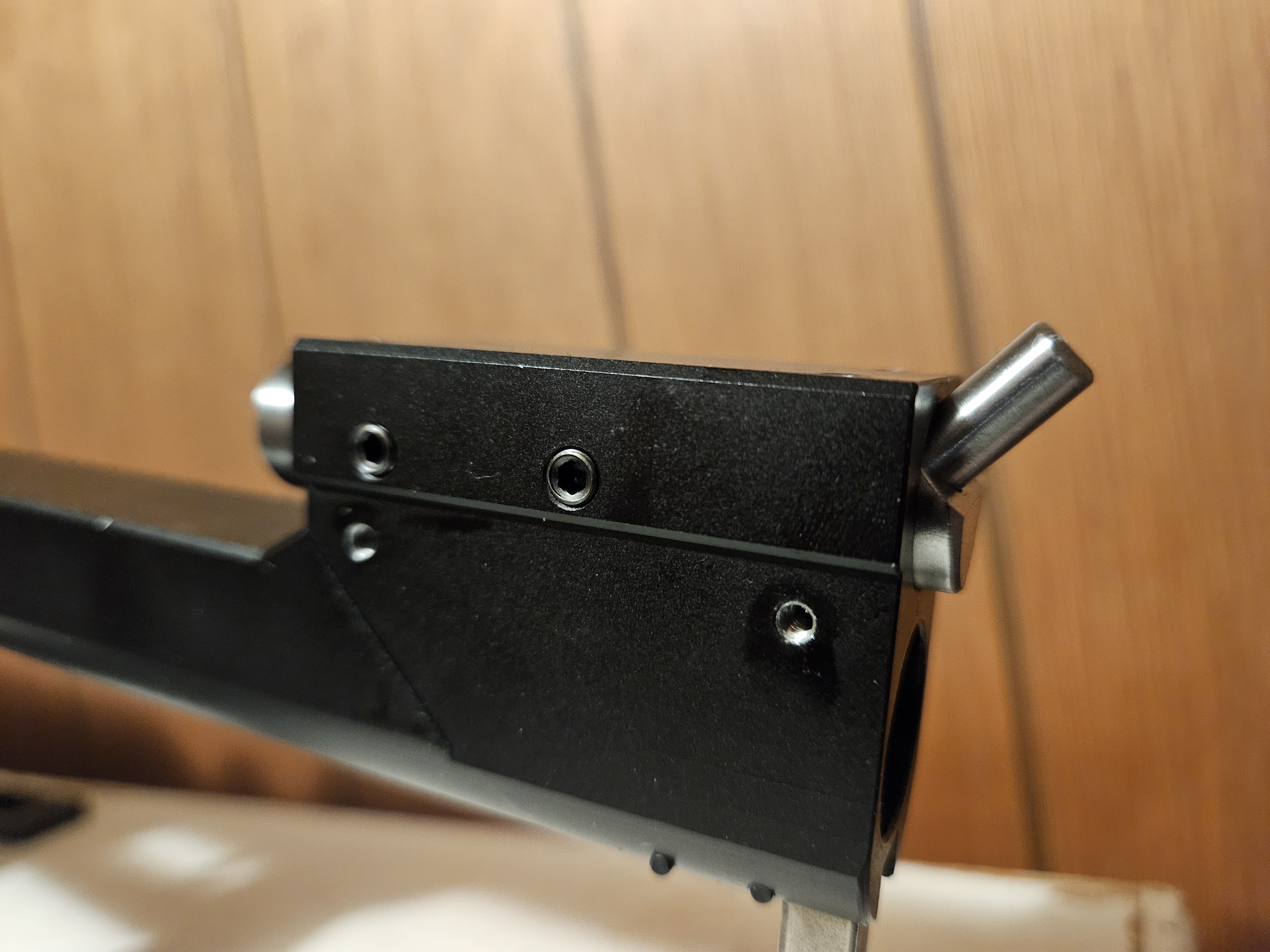

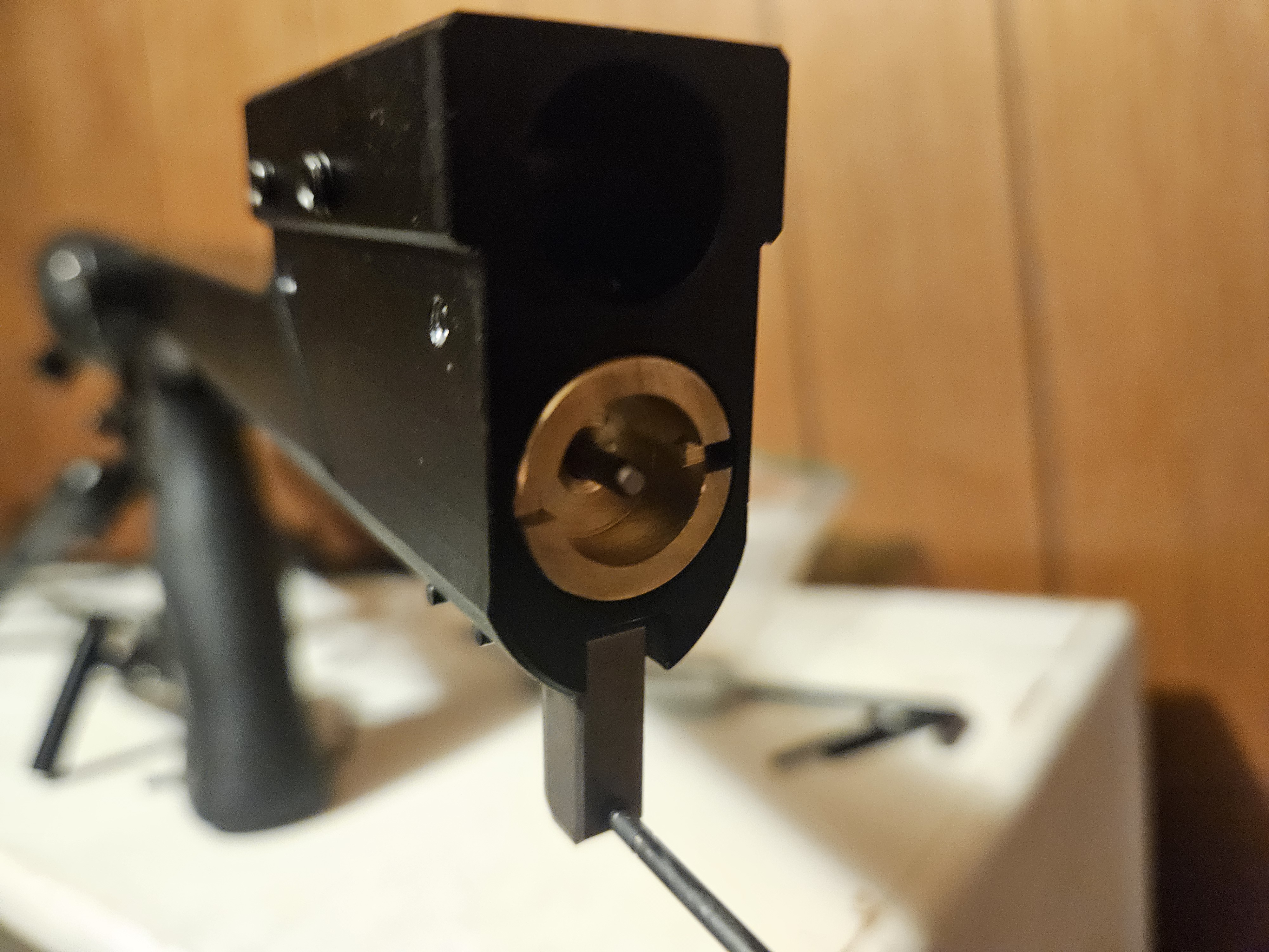

On the zelos, the original ports are sized about right for 25 cal. I think the original valve could be made to work with 22 and 25 better. Spring change and cut down the poppet.From .22 to .25, from 14.39gr to 25.39gr.
Killed the speed.
There was a new poppet made from peek, MUCH bigger and longer and I just bet it would fit the Zelos!!!!
Now I wonder how this valve would work in the 9mm?
Wooh! Flipper yeah man!Bumped the reg up to 165 and leaned on the hammer 3 turns from flush, and it's doing this now.
Put the hammer spring at 5 full turns in, and with a 60.8 grain brimstone slug, I got an average of 910 fps for 10 shots before I dropped off reg. That's roughly 112 fpe!
Only about 10 shots out of the 350cc bottle. This gives me hope that I can still have good power and shot count after it gets the choppy choppy.112 aint nothing to sneeze at!
