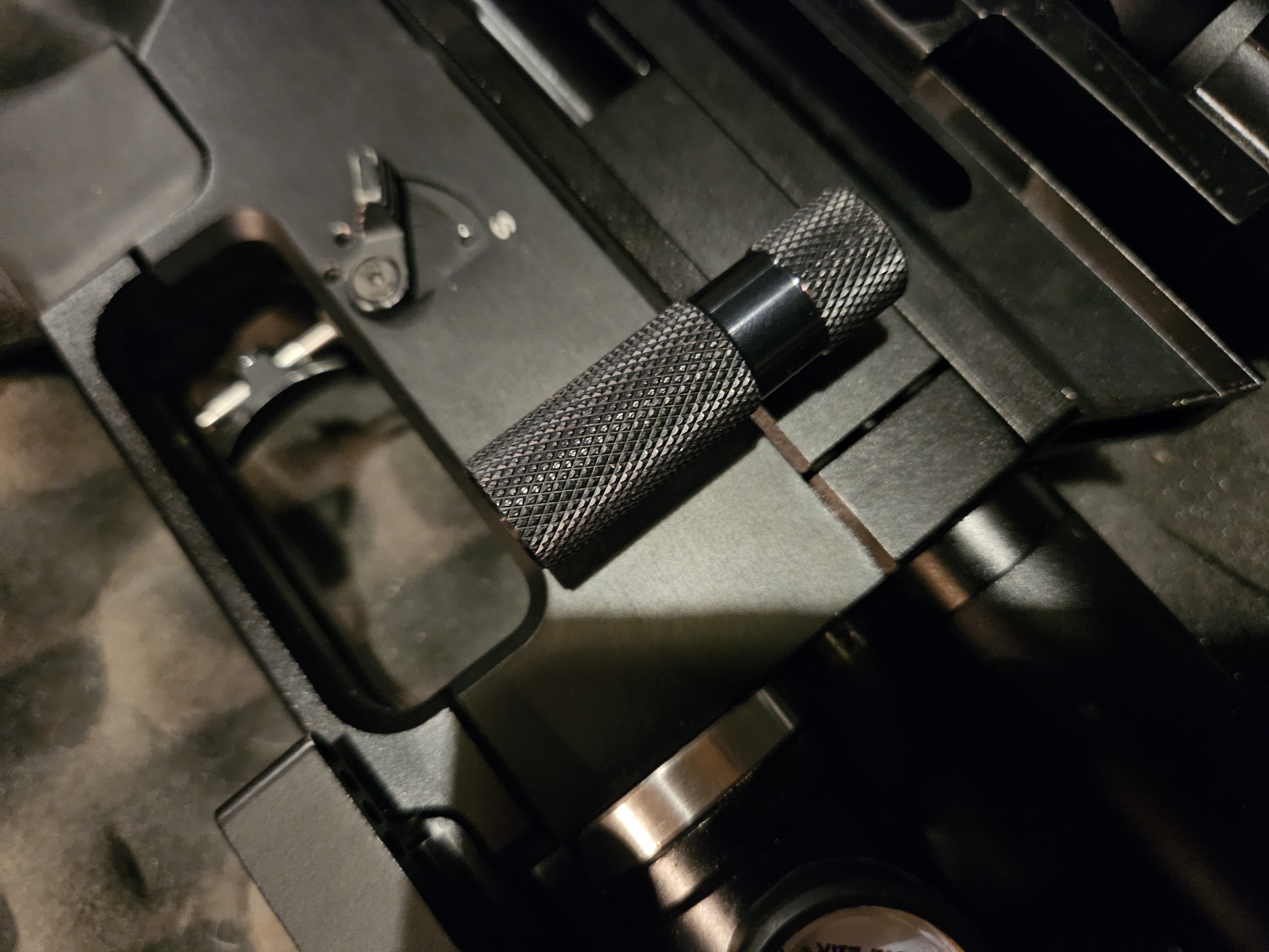

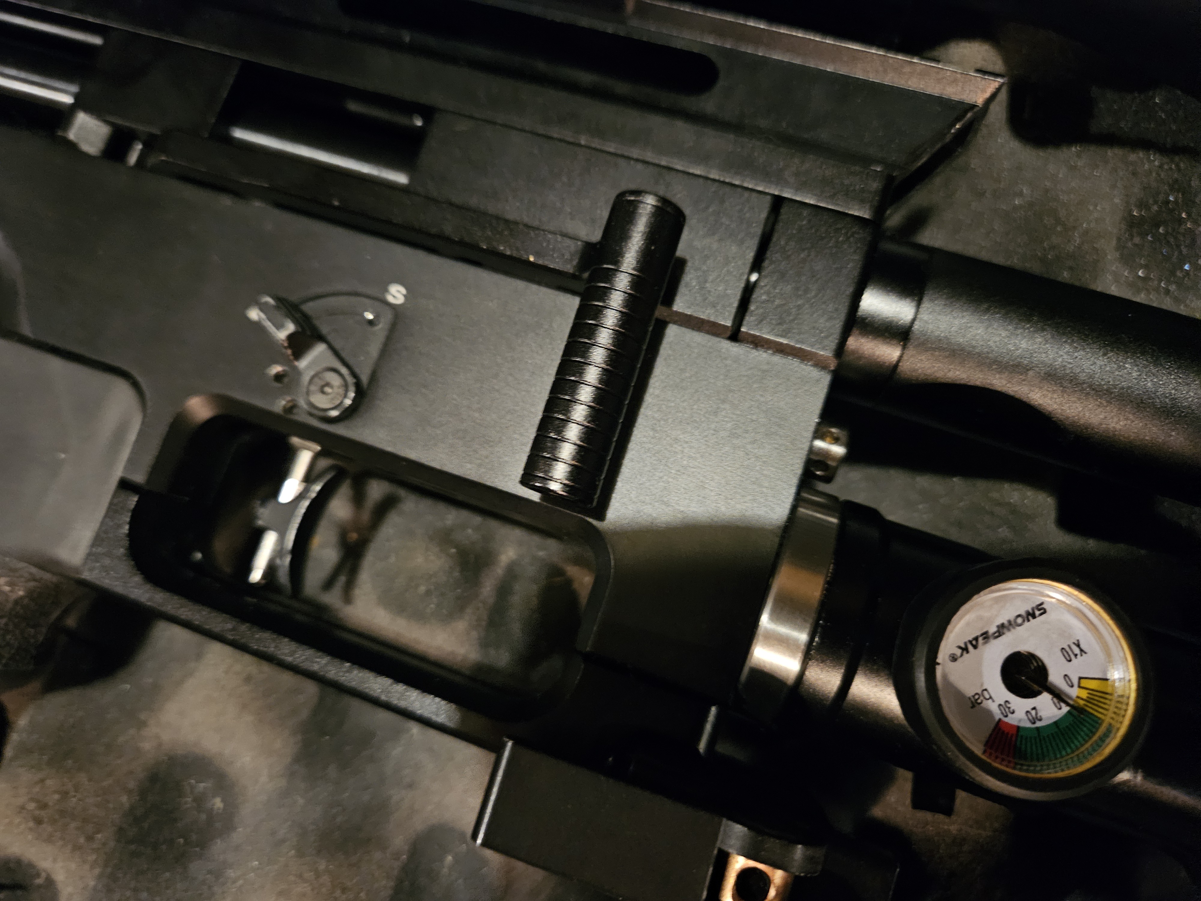

I did get the oversized cocking handle from c88machining on ebay. He is starting to make some parts for the platform now along side all his notos stuff.
Original lever
New handle
Side by side of parts
Definitely easier to grab and rack the action now.

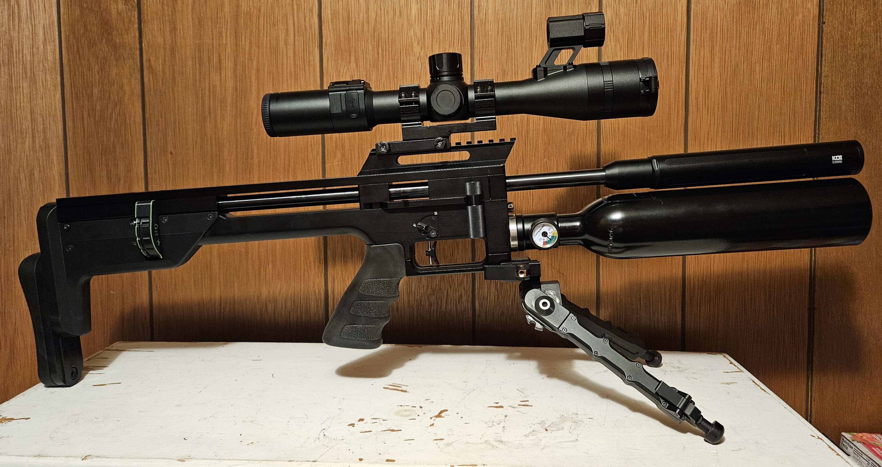

Well the 30 went under the knife tonight. Took 6.5" of barrel off, leaving 17.5". Installed a steel 425cc bottle also. This is lighter, same psi rating, and about 3/4" longer than the stock 350cc bottle.
I can feel the weight difference off the front for sure.
It is exactly 30 inches long now with moderator. The adapter is larger than i anticipated and won't fit in the factory shroud. I'm going to try and find a piece of carbon fiber or aluminum to slip over it. 27mm ID and 29mm OD should do the trick and leave me with a 1mm shoulder at the base of the Donny.
I also left the cheek riser off, and will probably lower the scope down on some rings vs the cantilever. I cut the rail for that reason, since the objective bell would hit on low rings.
Did a quick tune on it, and at 110 bar it's hitting 750 fps with 50.15 jsb. Plenty of room to run, but I don't want to stress the moderator.
