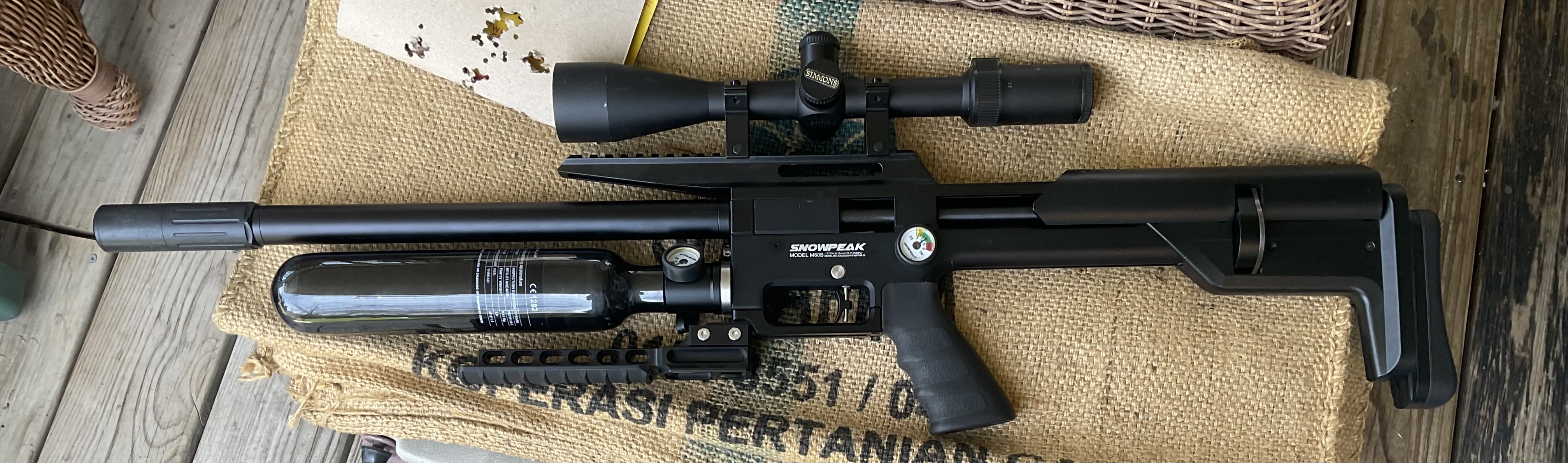

I have a .177 my best advice is keep super glue handy. One day I pulled the trigger and got nothing ended up being the worlds smallest circlip popped off the trigger linkage. Just little things happen. pix of my M60B.View attachment 443042
looking good. does the rail extention on the bottom hold well to the tiny rail? what part did you use?
hope you got that tiny but important failure fixed. did it hold with superglue?
Reactions: Firewalker
The bottom rail holds great it’s a saber tactical brand pic rail. Sorry no idea what size Oring didn’t you get extra o ring packet?. So far every thing super glued is holding.
