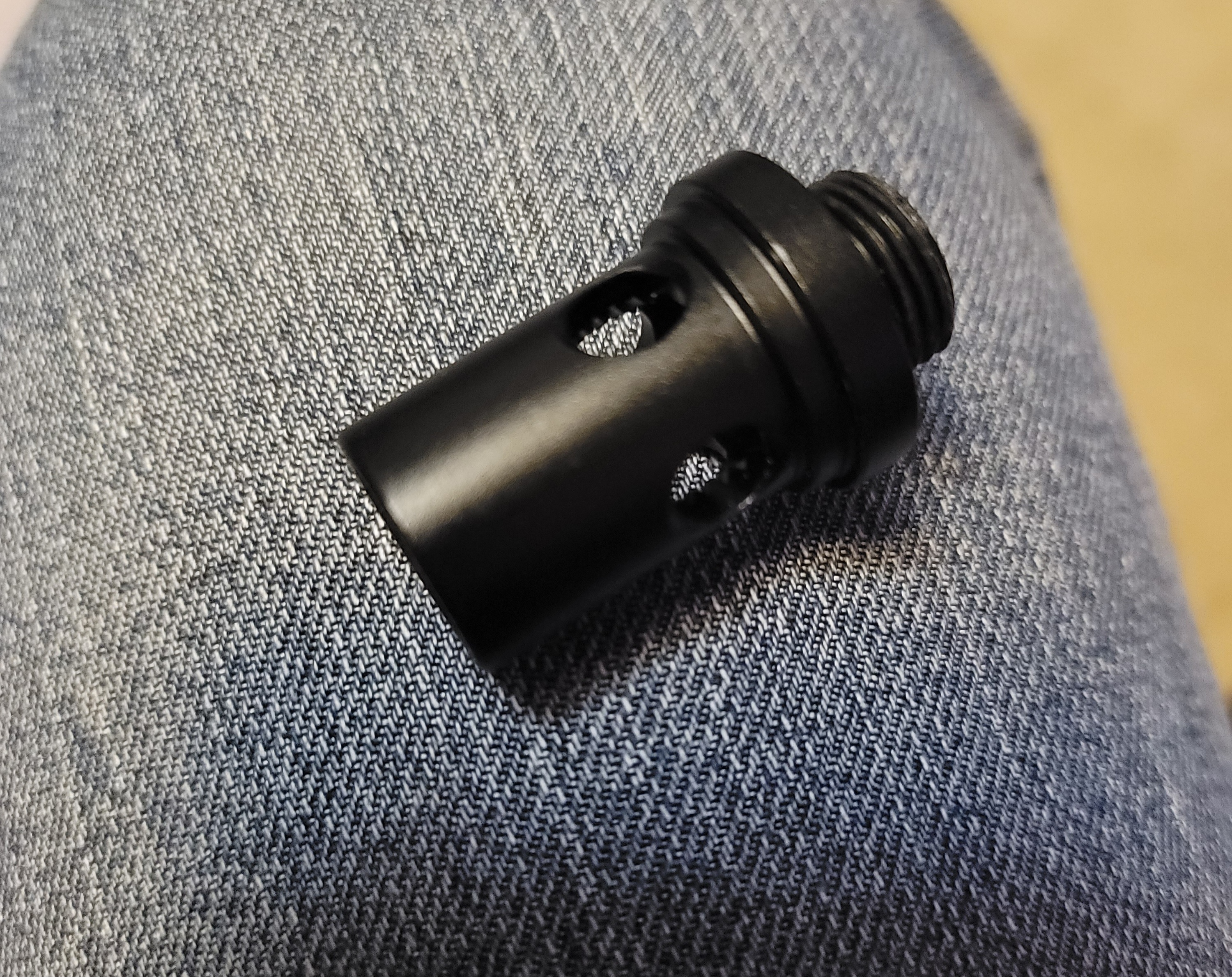

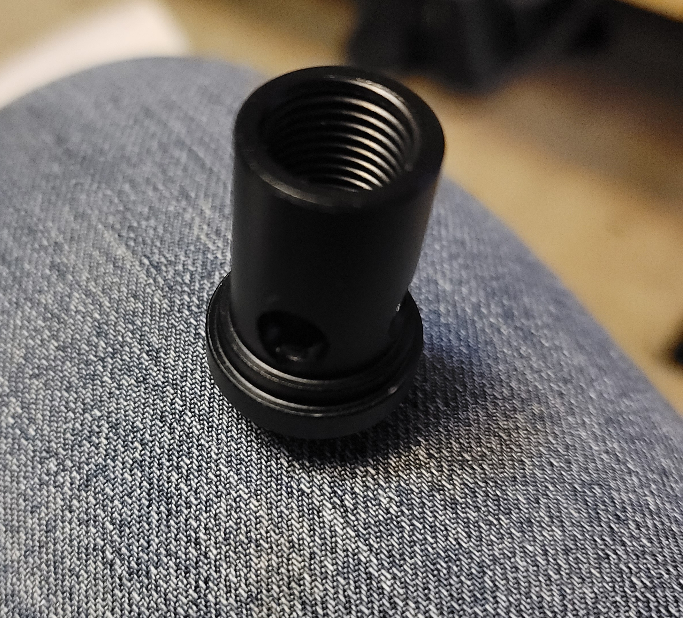

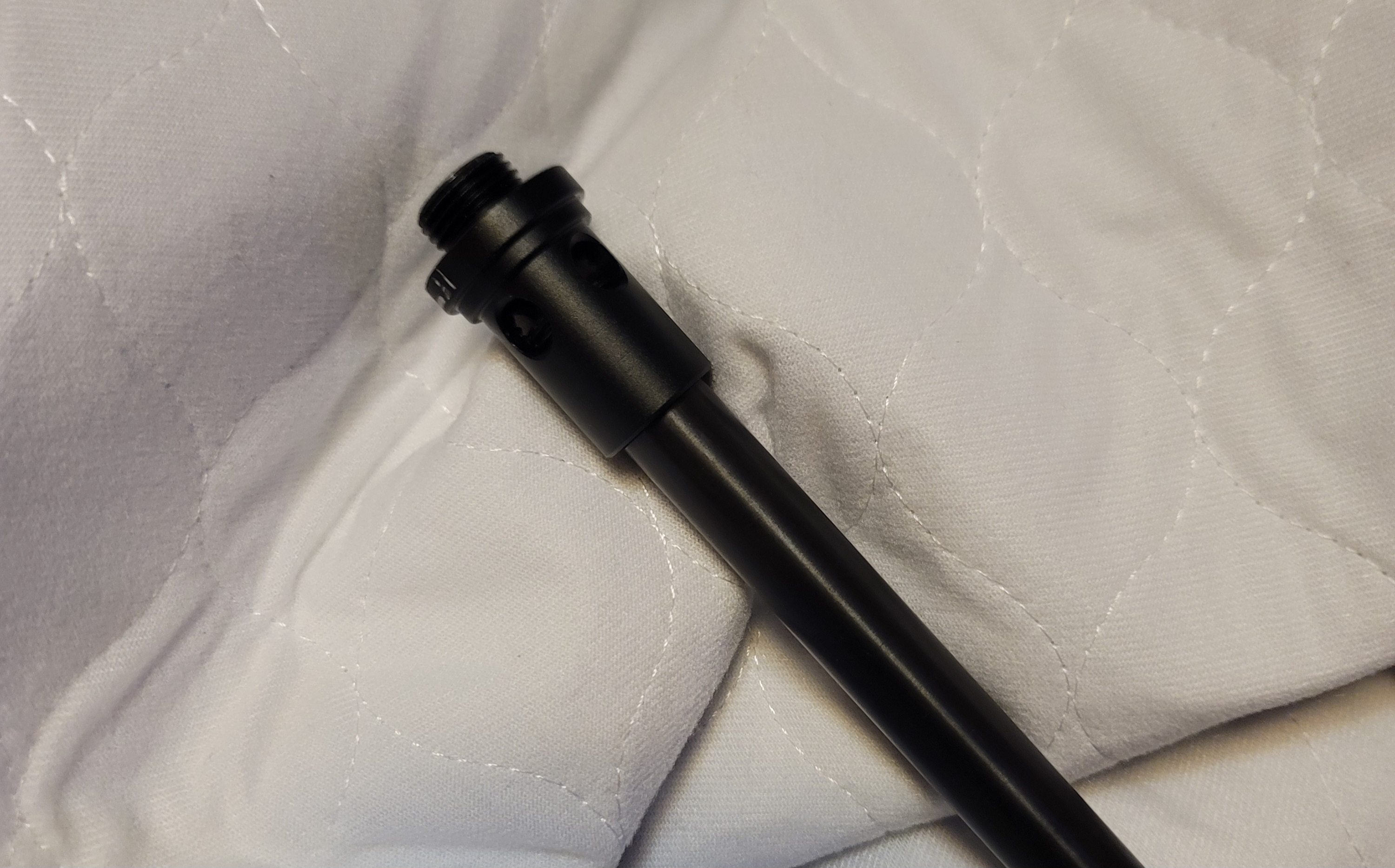

I went with the gauge suggestion and picked one up. A little bit of a surprise because there are no shroud threads. The top cap is attached to the air stripper which threads on to the barrel. That thread matches the 1.5, the caliper says 13.8 which allowing for my own user error is 14 x 1.5. Considering the integrated air stripper build that really kills any chance of finding a piece from another manufacturer that would work. It looks like it's a new search for someone who can make the part from scratch.
Interesting design. It's venting into the shroud presumably to provide a little sound suppression. The P35 has a much different and even larger aluminum piece screwed to the end of the barrel but it is short of the end cap by several inches to allow space for baffles.
