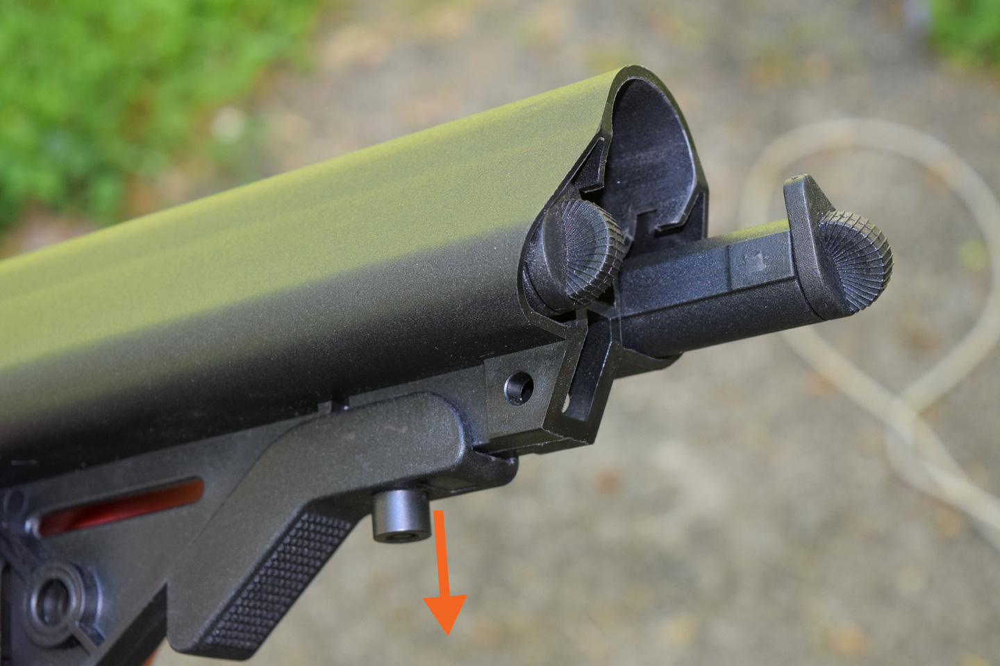

The MA-2 stock has two tubes, one on each side of the collapsible stock. Can these be removed? If so, how?

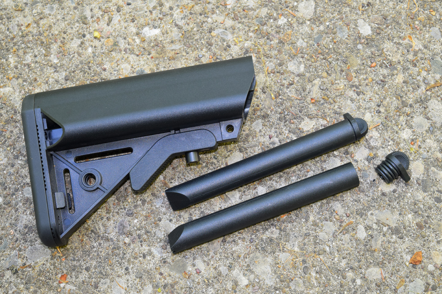

you remove the butstock from the tube by pulling straight down on the adjustment lever and sliding it backwards - it should pull right off. The "tops" of the tubes turn to release them from a slot in the stock. They won't come out when the stock is on the tube, as the tabs hit the tube.
The tube tops pull out - I suppose you could carry extra pellets in the field if you so choose to...
