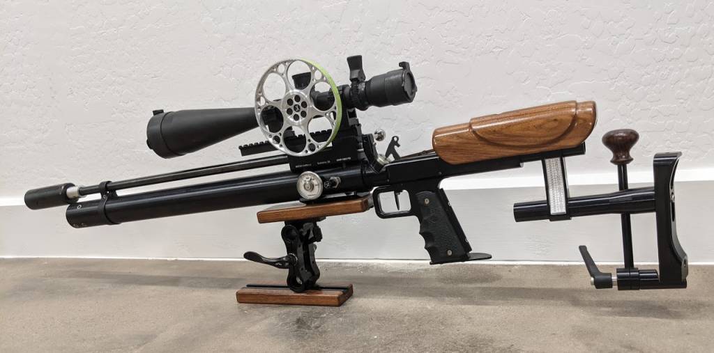

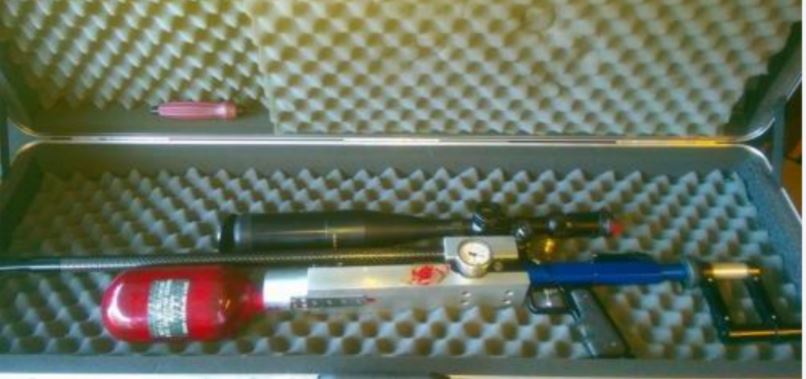

I can 100% vouch for the fact this gun in the pic above shoots "lights out". It is really dialed in.
Franklink let me use this gun (under his watchful eye) for the NM match last weekend since mine is currently with A.Z. getting some mods.
I'm still trying to get the smile off my face. Insert smiley here.
This was only my second FT match and my scores went from 29 of 52 in June up to 51 of 60 for July. Wow! If you do your part, the gun will not disappoint!

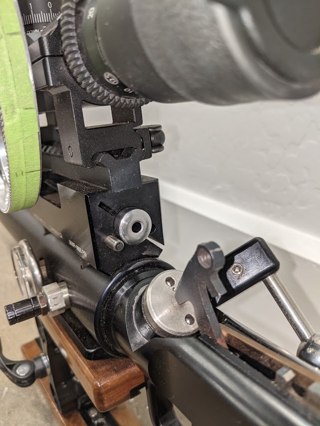

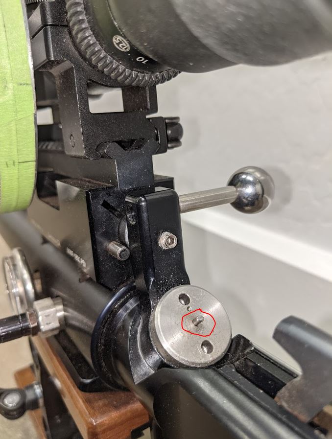

The externally visible valve stem is circled in red here:

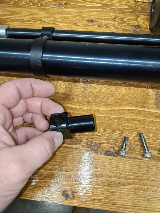

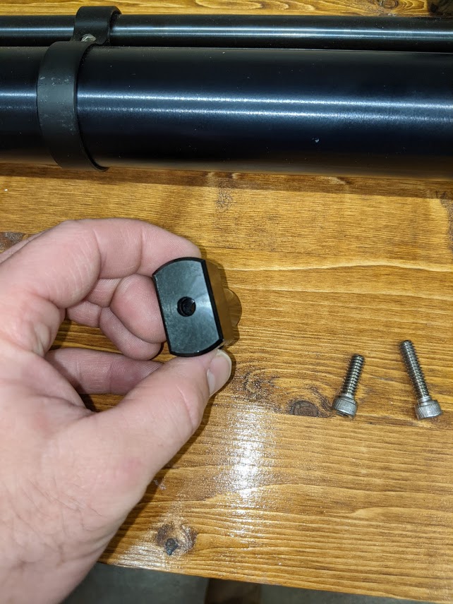

  • LDs design did completely away with pellet probes. Let me repeat, there is no pellet probe for the Simple Simon/USFT. How you ask? Well the pellet is placed directly into the rear end of the barrel by the shooter. The operator of the gun can fully see the rear of the barrel, "hmmm can't remember if I put a pellet in, let me just look directly into the back of the barrel and see, nope, no pellet." Very unique, very convenient.
  • There is no transfer port machined into the barrel. Let me repeat, there is simply no transfer port machined into the bottom of the barrel like on nearly every other airgun that I've been inside. How you ask? Swing breech. Here's a couple pics....
       and the underside that shows the orifice by which air gets from tube to pellet
      compare that to the previous picture to see that the black rectangular piece of aluminum swings out of the way to provide access to the barrel. So the "transfer port" is actually part of that swing breech mechanism. Arzrover and I share a love for the USFT (he won Nationals with his, in 2018 I believe) and we'll often go down the rabbit hole in technical discussions about airguns, him mostly teaching me. This configuration of pellet into back of barrel, with no transfer port for the pellet to bump over, with air hitting directly behind the pellet MAY have some interesting down-stream effects on the accuracy potential of a gun. You see, there is no right angle path that the air must take to hit the back of the pellet like it would with a "regular" tp machined into the barrel. Yes the air has to make some turns as it passes through the swinging transfer port, but the simple fact that the pellet doesn't have to bump over a tp to get to where it's going could also be beneficial. So, Arzrover and myself have contemplated if that directly-to-the-rear push of air on the pellet somehow causes a different obturation effect on the pellet. We were brainstorming ways to test obturation and think we came up with something, I'll likely get around to catching some pellets fired from the USFT to see if this unique method of air delivery is changing the shape of the pellet in a perhaps beneficial way.
    • Did you notice another unique design feature in those above pics? No oring groove necessary in the barrel. I understand some of the early USFT's had the groove machined into the barrel. but that was eventually done away with and the oring groove is now part of the swinging transfer port. So, any 16mm Lothar blank can just be plopped into the gun and tested for accuracy, no machining necessary.

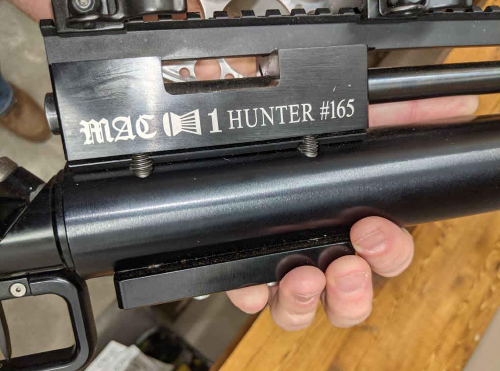

I’m puzzled by the fact that back in the day when the USFT was the latest and greatest, with many local and national wins, that their popularity seems to have faded. The total number of guns produced is still quite low but you still rarely see a used one come up for sale. I too have had the urge to own one since forever. Your review may have rekindled that urge. Thanks Cole😳. Uj
I estimate there aren't more than a couple hundred in existence, based on the numbered breeches that I've seen at matches and in the rare shared photo on the forums. I suspect the guns were originally issued in a sequential fashion, with the numbered breech coinciding with how guns had been made up to that time. But at some point the numbering seems to have gotten off. Mine is technically a "Hunter" version, with a straight grip versus the canted grip like the true USFT designated models. Anyway, mine is #165, seen here:
I've seen a handful with higher numbers (in the 200s) that were sold years before mine was made.
So, I'm not sure what all that means, perhaps not as many "Hunter's" have been sold and my breech sat in a pile of parts for at least a couple of years until I ordered it, with canted USFTs being issued after the creation of my breech but prior to the creation of my gun.
Memory is a bit fuzzy right now, but I'm kinda remembering seeing one numbered up around #280 at some point. I think that's the highest I've seen, so if any weight can be given to the numbering system, I'd be surprised if there are more than 300 total in existence.

Refer to the vid above for the following:
  • Gauge shows that I'm right in the middle of the pressure range that I usually work with, fill to 1450, refill at 1250.
  • Note the Max Working Pressure of 1800psi on the breech markings
  • Simple dust cap on the foster fitting (so nice that it's located where it is on the gun).
  • Supposedly any 1911 grip can be swapped onto the gun, mine has the grips it came with from MAC1, although I've eyed these a few times, in walnut as it seems like they'd go well with the overall look of the gun
  • Aluminum palm shelf/plate at the bottom of the grip. I was skeptical at first but being able to place the meaty part of the bottom of than hand on that shelf helps to lock the gun into place when shooting from ft position (bumbag)
  • My dope/cheat sheet on the rear "dogbone"
    • Yards in the left column, scope clicks in the right column
    • Tims term, "dogbones" refers to the anodized aluminum drop pieces that put the shoulder plate lower than the spine (tube) of the gun to align better with the shoulder
    • Dogbones can be ordered in custom lengths, I went with fairly long ones b/c I like to shoot in a more upright position, more for comfort than stability, crunching my neck down into a gun and pinching my shoulder up to make things line up gives me a sore neck, the higher dog bones help me avoid that soreness
    • I also opted for longer than standard dogbone on the knee riser
  • Thigh rest and function of such
    • I believe it was Lauren Parsons who told me these thigh rests were deemed illegal in WFTF class after they started showing up on USFTs, which blows my mind as that class allows the craziest contraptions to help with stability (foot long butthooks that curve under and over the shoulder, shooting gloves, shooting jackets, etc).
    • When seated on a bumbag the thigh rest is flipped outward and locked into place. That little round knob of walnut rests on my inner thigh, a bout 5 inches up from my knee.
    • REALLY aids in bumbag stability
    • Thigh-rest is one of the contributing factors that make my field target position with this gun nearly benchrest stable. Hardly any scope wobble.
    • Cylindrical piece of aluminum that affixes the thigh rest to the gun can be swiveled in 360 degrees, and locked into place with a large bolt on the underside. I only need to use the lever to lock it into place after swinging down to thigh. The large bolt controlling angle of the thigh rest is a set it and forget it thing.
  • Canted shoulder piece (buttpad but aluminum in this case so not much of a pad)
    • shoulder piece allows for up and down adjustment, as well as cant. I like mine canted towards me, and adjusted down quite a bit, as seen in the video
  • Mine came with an what Tim calls a "striptease" air stripper
      • VERY loud with as issued air stripper

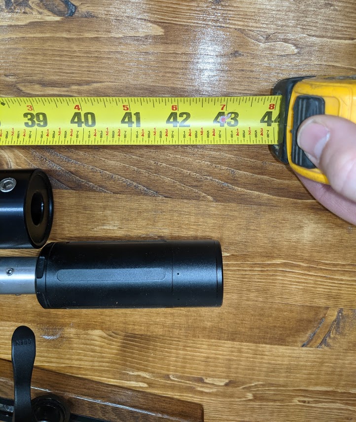

  • I had Rocker1 over at GTA machine me an aluminum (raw aluminum in vid) adapter for a 1/2x20 moderator
  • Currently running with a DonnyFl Tatsu for a total OAL of just under 43 inches
    • not even slightly loud with Tatsu
    • previously had a 7.5inch Hogan Decimeter on the gun and bystanders thought the gun was broken it was so quiet, but that extra 3 inches with the Hogan made OAL up around 46 inches and was unwieldy, so compromised with Tatsu

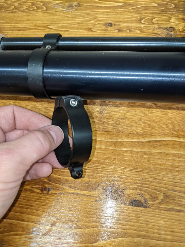

  • Barrel band-only in name
    • barrel is free floated as the ID of the barrel band is much larger than the 16mm OD of the Lothar barrel
    • Tim told me that is to protect the gun from large/violent impacts, but not to act as a barrel band/support in normal situations
    • Tim included an additional band with a sling adaptor in case I wanted to use a bipod sling adaptor at some point
      • I've never used it
  • Barrel movement is minimal and goes back to original location after any force is applied
    • really takes substantial force to even get it to move as much as it does in the vid when I'm pushing on it
  • Full length barrel-I think it's 23.6inches long
  • Burst disc in endcap of tube out by the muzzle
    • have yet to have one let go-hope it stays that way
  • Endcap held in tube by numerous and substantial allen head bolts

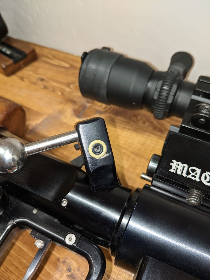

  • Swing breech function from this side now
    • Swing breech can be changed to open to the left or the right
    • I prefer it like this, opening to the right
