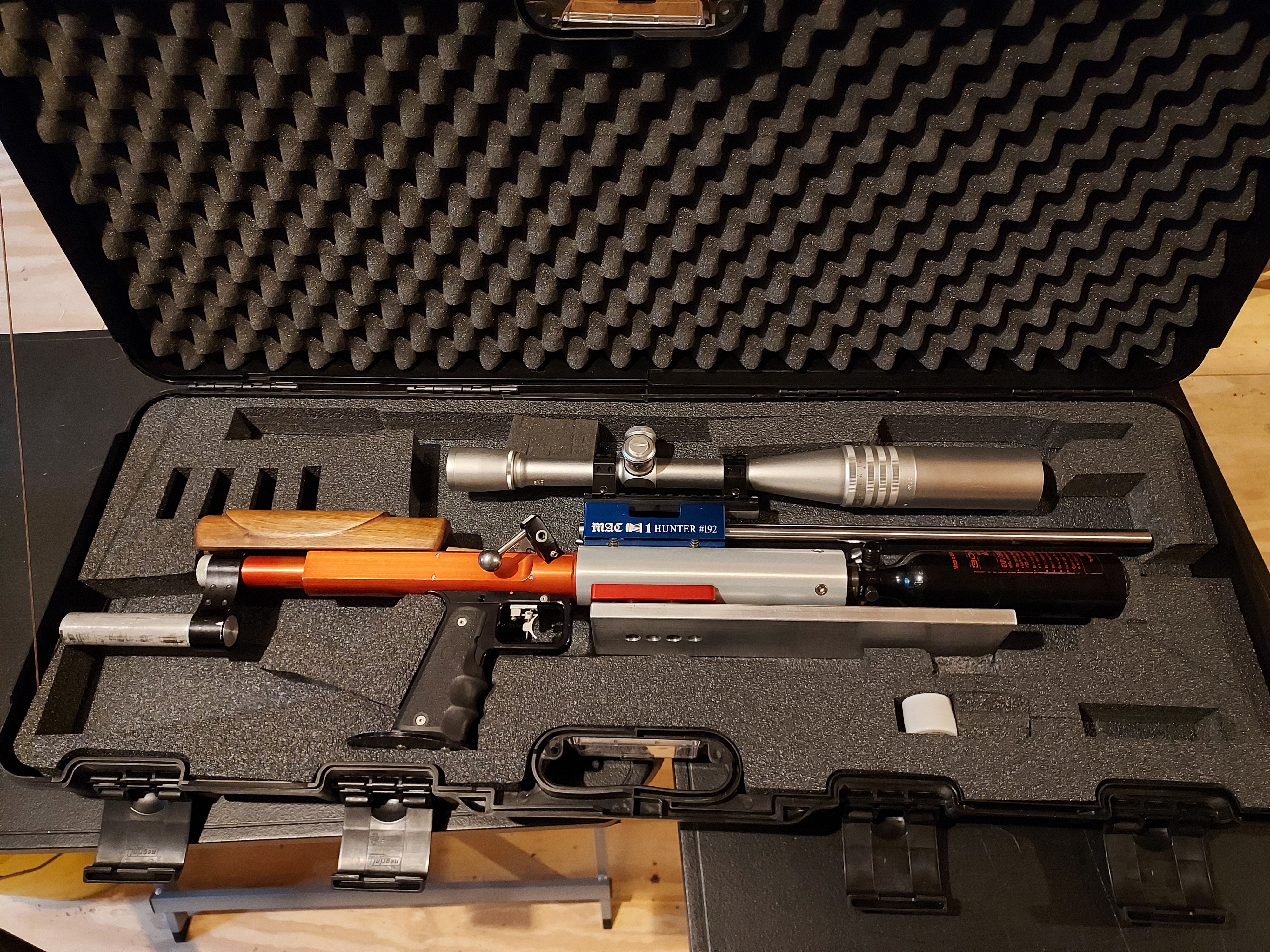

On a different note....who ended up with this sweet black and orange one from a week or two ago?
if i said "you dog" would you know i was just jealous! a usft for less than $2500 is a bargain, no wait, a steal.....
Reactions: Dairyboy
Wasn't me but whoever got it got a good deal.
From the few that come up used and the other few that I know of that have been purchased used by friends in the last 5ish years..........seems something like $1500ish is typical. With the reasonable range being $1300-1800. All that dependant on whether or not all the accessories are part of the package.....knee risers, thigh rest, etc.
Somebody PMd me a few years ago and found one for $800-900 if I remember correctly. That's the cheapest I've ever heard of one going for. This orange and black one that just sold was certainly priced to sell too.
Reactions: Dairyboy
i was very interested but let someone else take it , i already have one Red one # 233 . I Remember watching Ted's video and the 2 groove .
