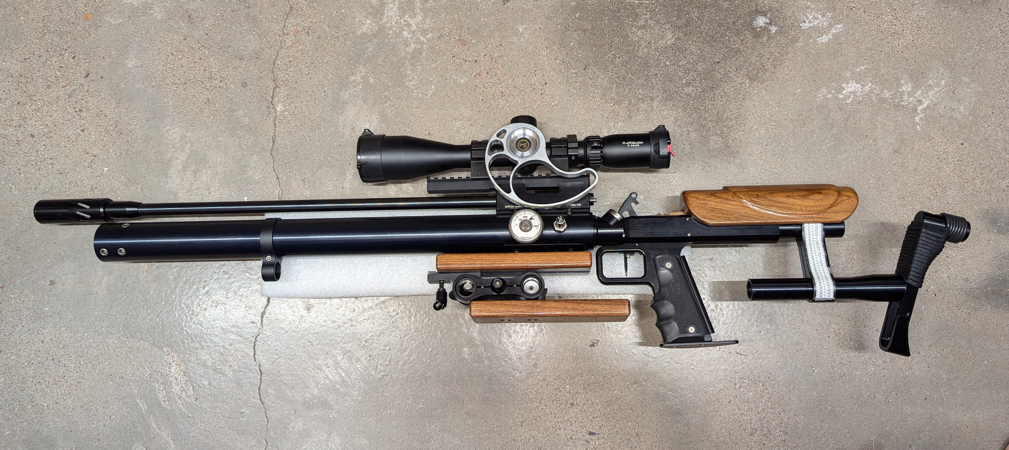

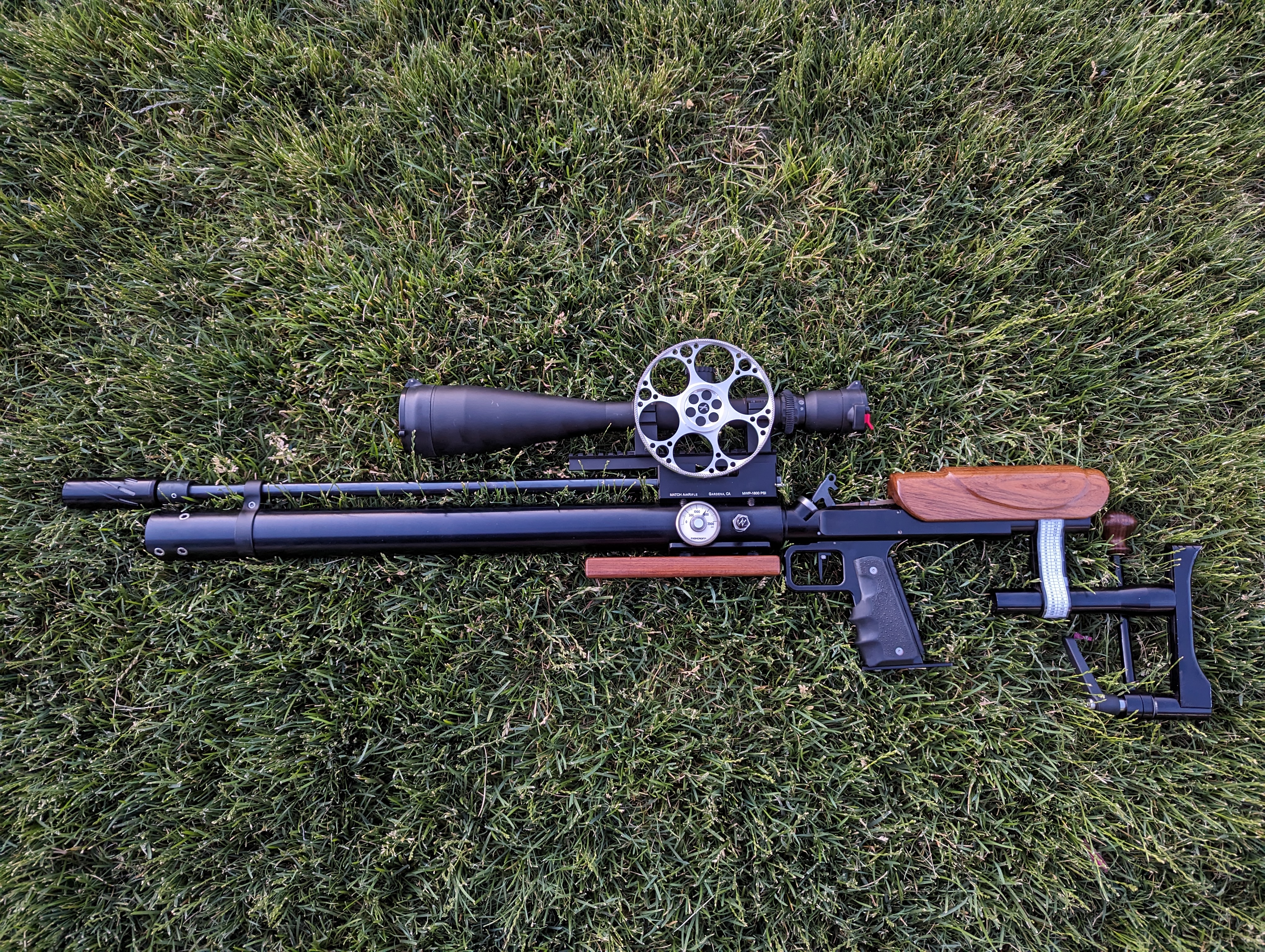

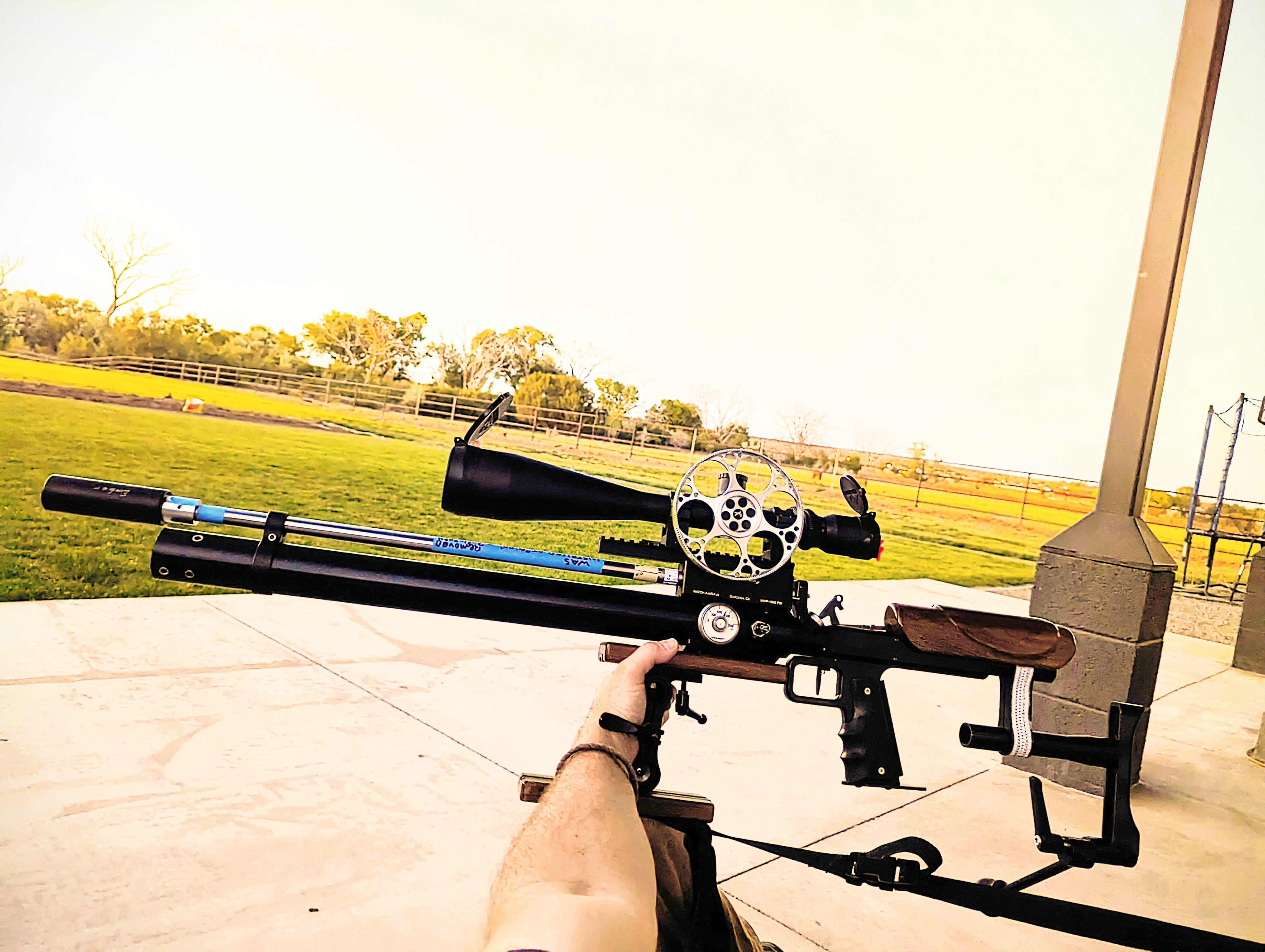

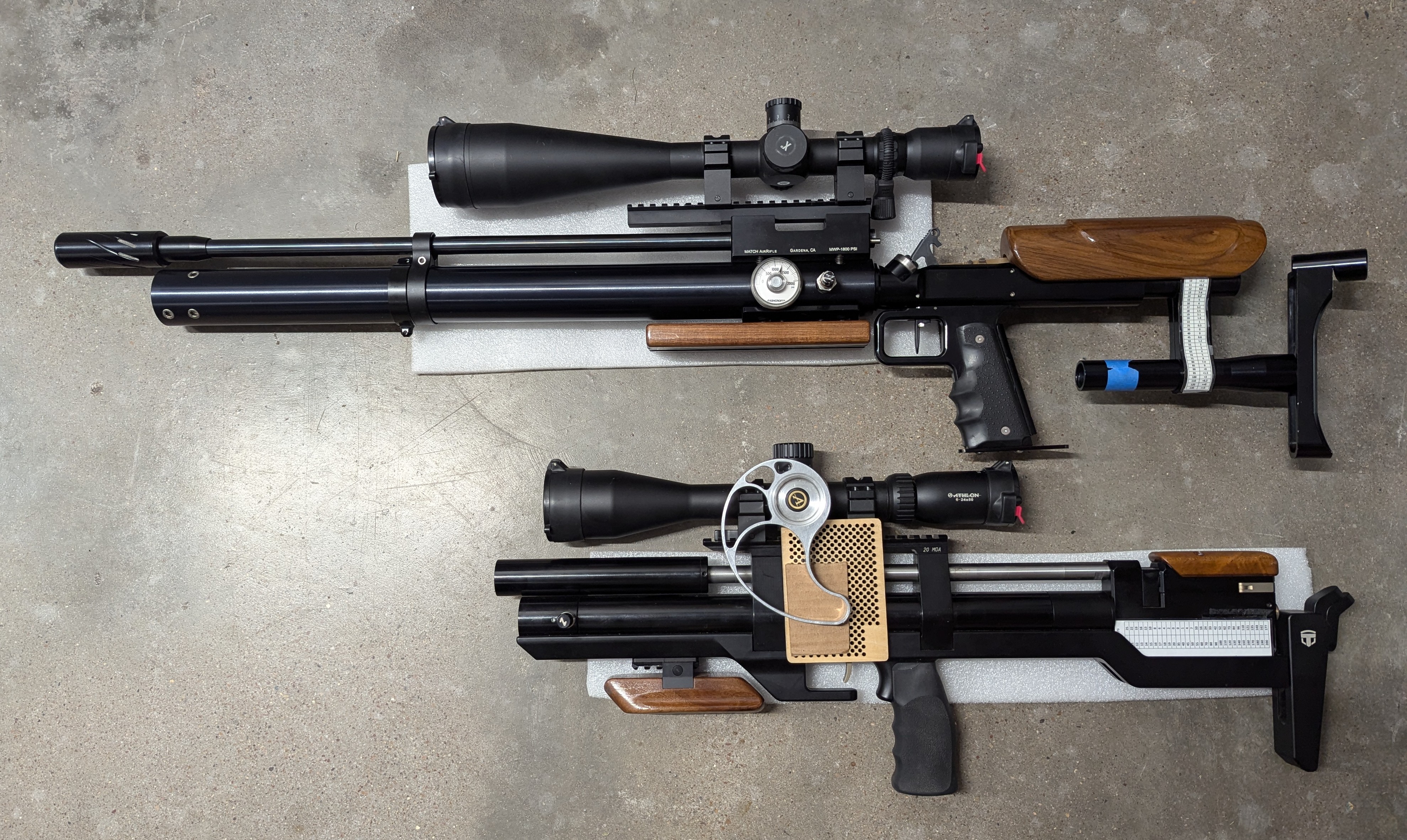

After much deliberation, I've decided to rework the USFT into a Hunter class gun. I've always competed with it in Open, using one of the early Falcon X50 scopes for the last couple years. My X50 is early enough that it doesn't have a mark at 16x, so a change in scope was the first order of business. And I went to one of my favorite all-around scopes, the Athlon Midas Tac 6-24x50 with the APRS2 reticle, MIL. Scope is equipped with a Eric Sanders Scopewerks nautilus wheel.
This is the length situation compared to the gun I've mostly been shooting for Hunter class. So nearly twice the OAL.
You'll notice that I removed the thigh rest and hardware and flipped the buttplate. This is just one of the areas I've been fiddling with, in an attempt to optimize for Hunter class. The buttplate area was a major focus and I think I've settled on a configuration there now.
I've also played with various bipod stops and the best seems to have been to flip the barrel band like seen in the above photo.
I've also been seriously considering a .20 barrel, and chopping it back so that the airtube and moderator ends at the same place. This would be a weight savings as well as a more convenient overall length. I had a recent suggestion to cut back a .177 barrel and am toying with that idea too. Something about a 38-39" USFT intrigues me. But I also want to retain the ability to return to the magic barrel that's on it now.
As for the hamster, when fully collapsed it's under the 6" limit for depth in Hunter class. But it's awfully heavy and really only seems to be be beneficial for offhand shots. I'll likely not use this one for Hunter, but might see about cobbling together a much simpler (LIGHTER) hamster.

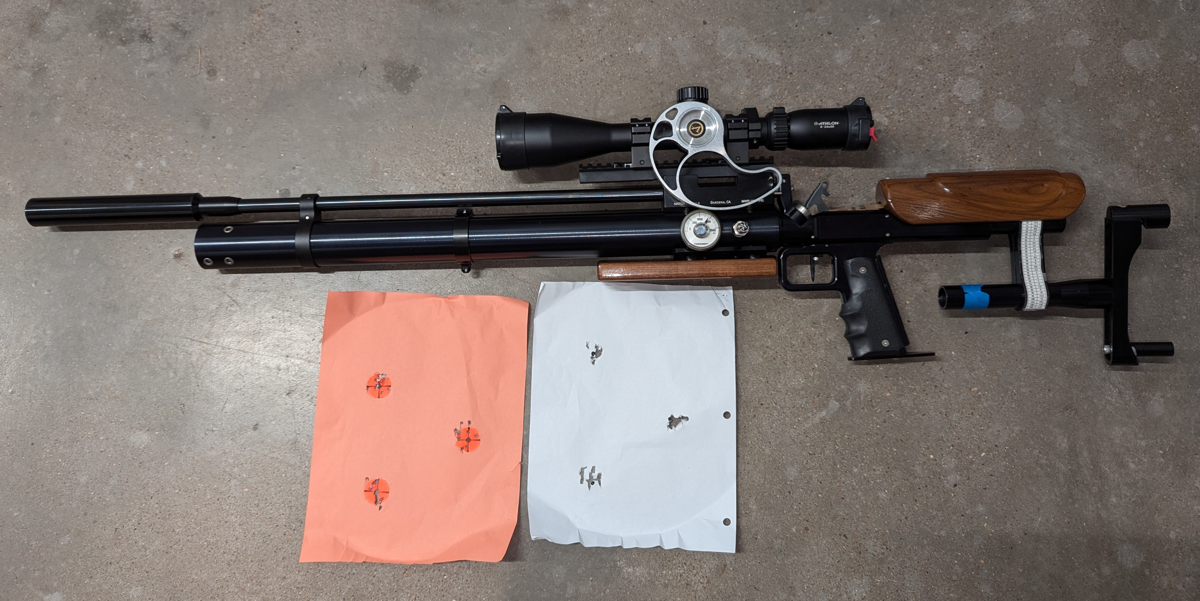

As for HOW it shoots from Hunter position, I'm so far pretty pleased. A pulled shot/bad trigger break still lands mighty close to desired impact point. Especially versus a pulled shot from the 25" Veteran. This was 6 groups of ten shots each, taken at 55 yards early in this experiment.
The orange circles are 1." Shot at them first and felt like I had an "aim big miss big" thing going on so the second set of ten shot groups was made at just a small dot made with a marker (3/8" and can just barely make it out on the white page). And it had a trial buttplate situation that has since been abandoned.
I've been testing various holds too. The most recent is with folded arms under the gun, with the gun rested on left elbow and elbow rested on left knee. Not finalized there yet.
And my lightweight, collapsible shooting sticks were no match for the USFT. They're hollow aluminum tubes (think aluminum arrow) and were flexing quite a bit. So the USFT will need the solid steel shooting sticks I've been fiddling with for the last 8 or so months.
Certainly making progress and enjoying the heck out of it. So far it seems the USFT will make just as formidable a rig in Hunter as it is in Open.

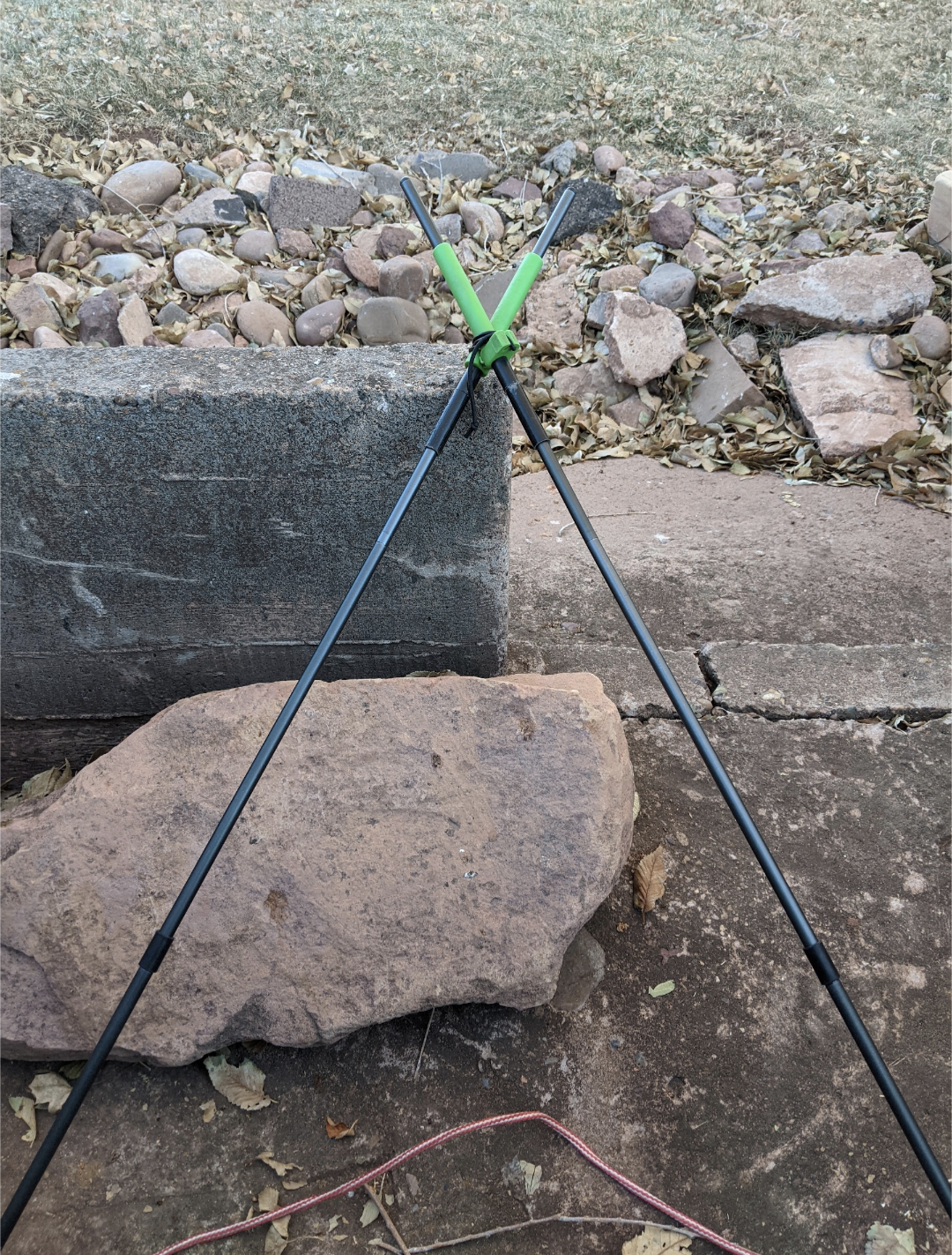

Trigger sticks gen 2 are great - amazon and mike rutka makes a great collar for it @DeadEyeNC
I know they're the standard but I really dislike em. The easy adjust is nice but I've found they just generally have too much slop. Much better after the various jury-rigging methods but still am not a fan.

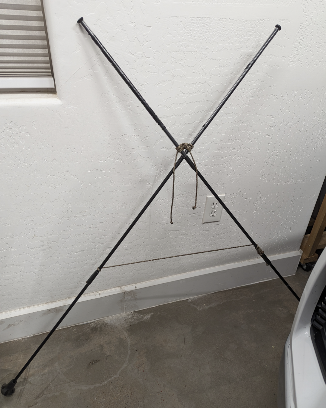

For years I've used some modified Primos Pole Cat trigger sticks. They work great for light guns or heavy/short guns where most of the weight is supported by the shooter, versus the sticks. They take down to be about 1foot long, super light, stick em in back pocket. I really like them for convenience and stability.
Like this ...
But for s heavy long gun like the USFT where the weight is out away from the shooter, those Primos sticks flex and get kinda bouncy.
So this is what's working better for the USFT....
They're steel stakes, with two parallel prusik knots (one on each stake) that allow adjustment by simply sliding the knot. They way the knot works is that the pressure of the gun squeezes the stake and keeps it from sliding, but no pressure and the knot can be slid. And I slid vinyl tubing over the top 18 or so inches of each stake. They were made with the intent to be long enough for standing bipod shots OR sitting bipod shots.
